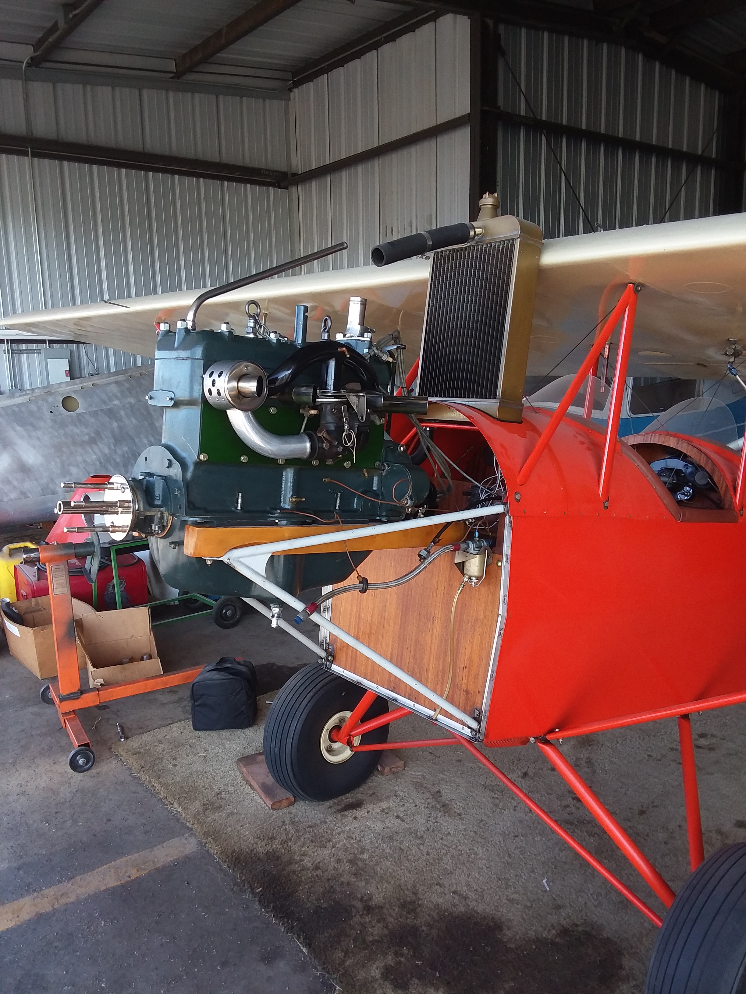

I just wanted to let everyone know what's up with Ken Perkins Piet. I've reassembled the engine and have it sitting on the mount. I still plan on flying the Piet to Brodhead this summer. There are paperwork issues and I may have eye surgery soon, but that is the plan.

Ken's Piet ran this morning, the first time in 6 years. It started on the first pull with a hot mag. Minor oil leaks on the rear of the engine so far.

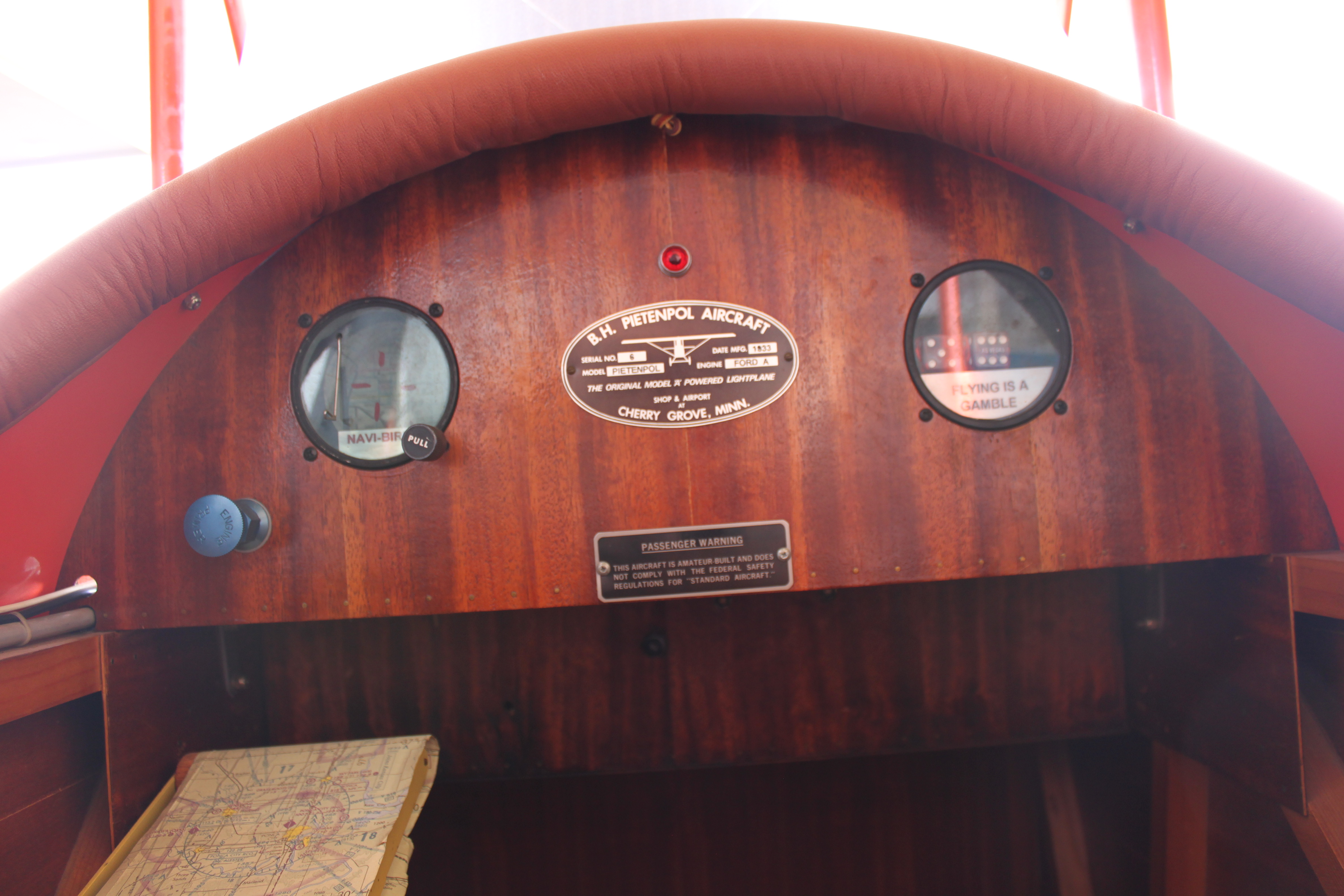

And does it still have the "pair of dice instrument" in the front cockpit?

Oscar. I apologize for not answering your question about Ken's Piet front cockpit instruments. I missed it entirely. Yes, it does still have the two dice instrument that say "Flying is a gamble". It also still has the "navibird" installed. I did take out the toilet paper roll moving map, it was always in the way when trying to get someone into the front cockpit.
