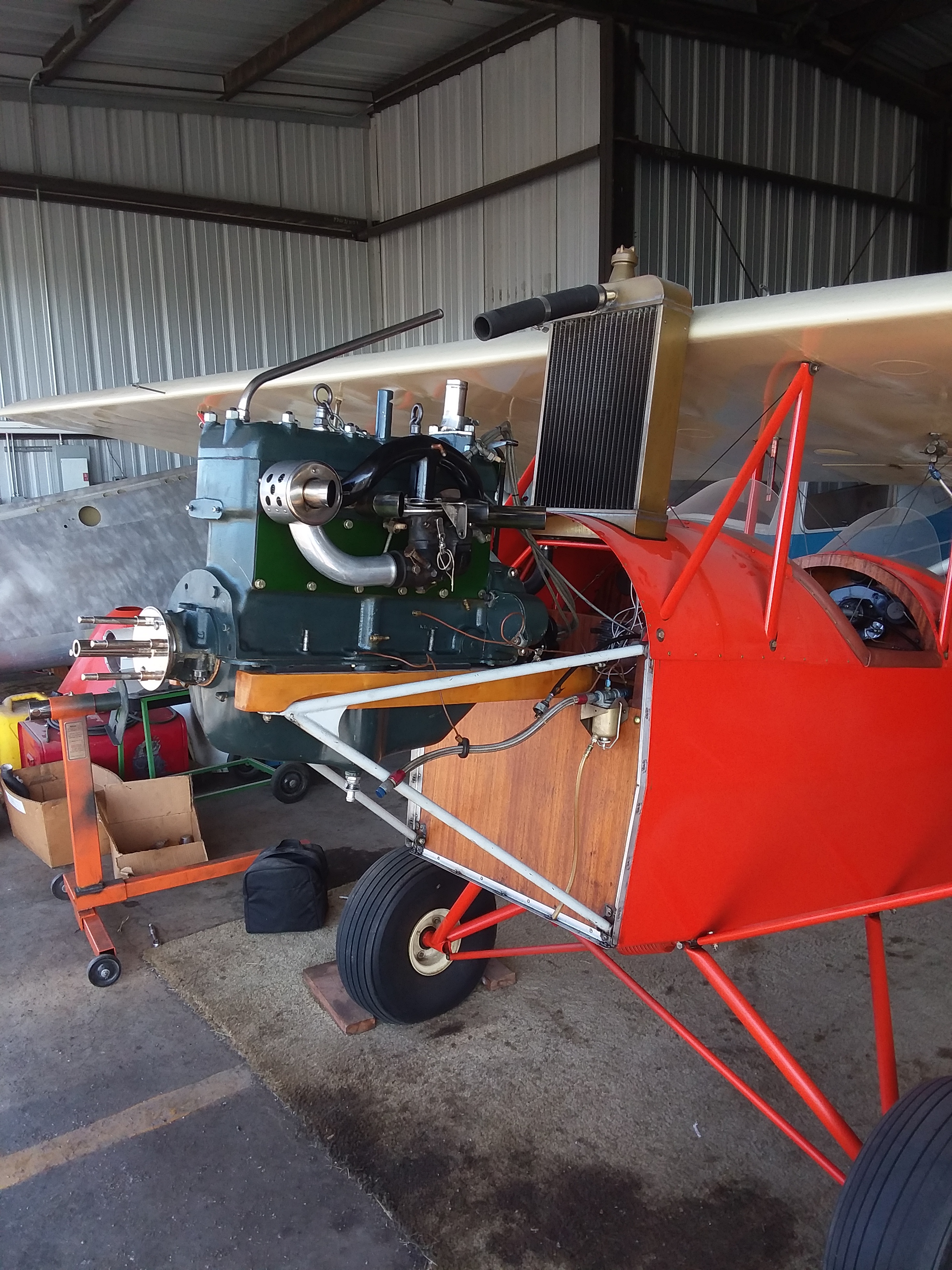

I just wanted to let everyone know what's up with Ken Perkins Piet. I've reassembled the engine and have it sitting on the mount. I still plan on flying the Piet to Brodhead this summer. There are paperwork issues and I may have eye surgery soon, but that is the plan.

Ken's Piet ran this morning, the first time in 6 years. It started on the first pull with a hot mag. Minor oil leaks on the rear of the engine so far.

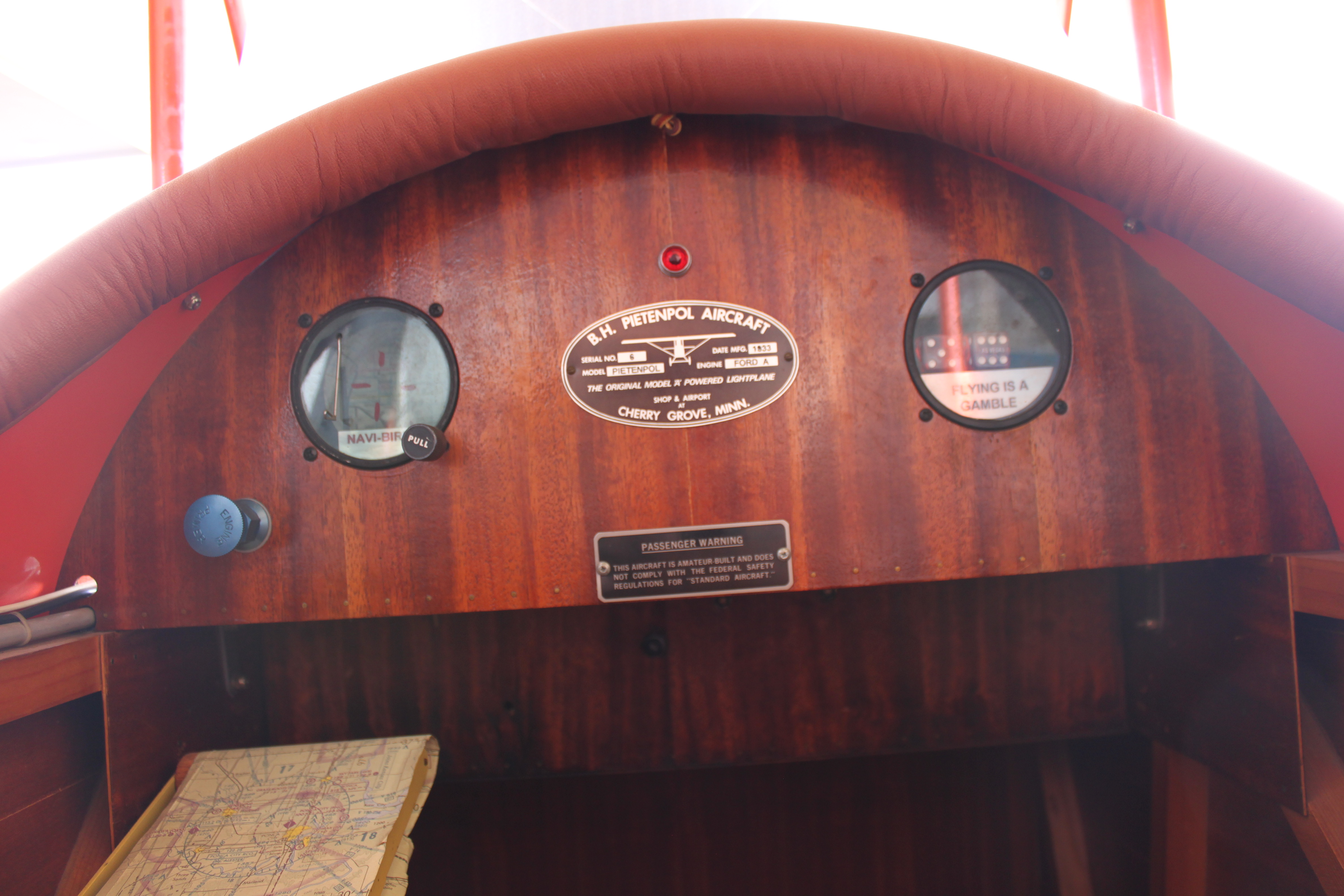

And does it still have the "pair of dice instrument" in the front cockpit?

Oscar. I apologize for not answering your question about Ken's Piet front cockpit instruments. I missed it entirely. Yes, it does still have the two dice instrument that say "Flying is a gamble". It also still has the "navibird" installed. I did take out the toilet paper roll moving map, it was always in the way when trying to get someone into the front cockpit.

Great day everyone! Ken’s Piet, N34KP, has flown again! This morning I flew it across town from KIXD to K34, in Gardner, Ks. It ran like a fine watch, smooth. When I put the engine back together I tried a few different techniques, trying to dry up the oil leaks. So far, so good. The first time I’ve flown this a/c without an oil slick on the belly when I landed. K34 will be a good home for this Piet with no brakes. Two grass runways. I’m looking forward to some good flying weather and some good flights. See you all in Brodhead in 2019!
