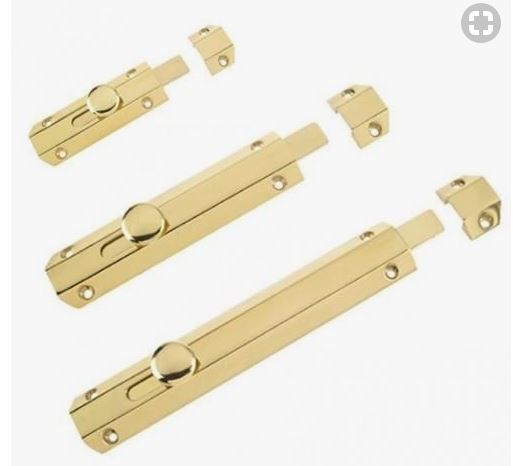

My centersection flop had sliding latches on each side, at the underside of the flop. Nothing more than what you see on windows or cabinet doors... see attachment. However, I have removed them because I found that the flop holds itself down in flight and they were not needed. When I exit the aircraft, I simply lift the flop with my head and it lowers back into place as I climb out. I never have to touch it.

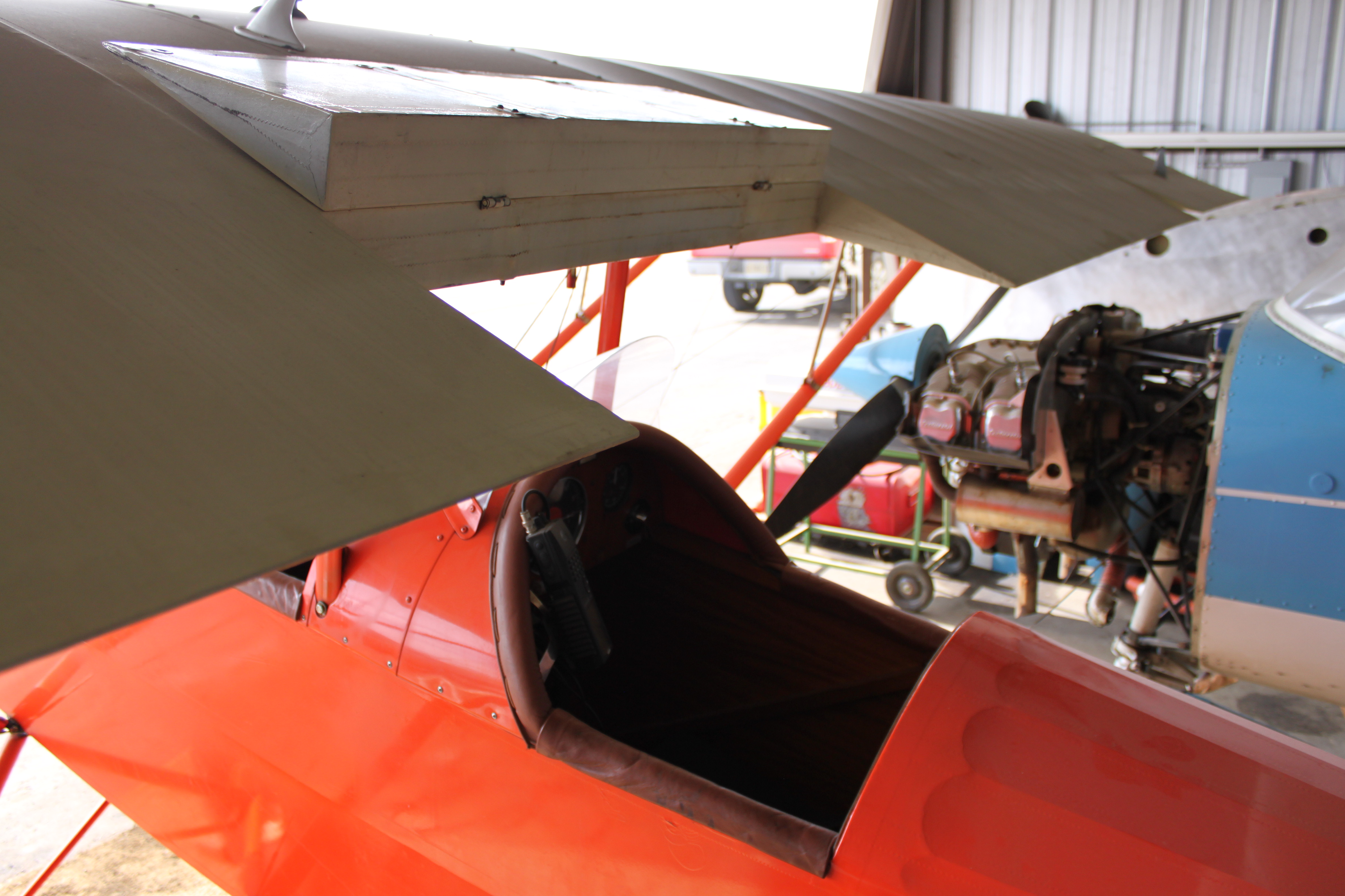

Nope... no ledge around the underside of the flop cutout. The flop when lowered rests with its forward lower edge against the aft face of the cutout in the wing. I added a thin strip of wood to the forward lower edge of the flop to bring the trailing edge of the flop into line with the trailing edges of the wings. Perhaps I'll take a photo... it might help to explain ;o)
Re: Centre section flop
Johnny; see photo of my flop in the flopped position ;o) Note that it will not fold forward any more than it is in the picture due to the hinge geometry. Mounting the hinge a bit higher up would remedy this condition but would place the hinge line above the surface of the wing, essentially tripping the airflow over the wing at that point. Since I didn't build the airplane, I didn't pick the way the hinge is installed.
Also in the photo, note the thin strip of wood that I attached to the lower leading edge surface of the flop (in this picture it's at the top since the flop is upside down). Without that strip, the trailing edge of the flop section hung lower than the trailing edges of the wings. Also note the grab handles, which I use every time I get in or out of the airplane, as well as the hole in the aft side of the rear spar. That hole gives me access to a removable link that joins the port and starboard aileron cross-connect cable halves. I have used this several times when I've had to remove the wings from the fuselage for transport.

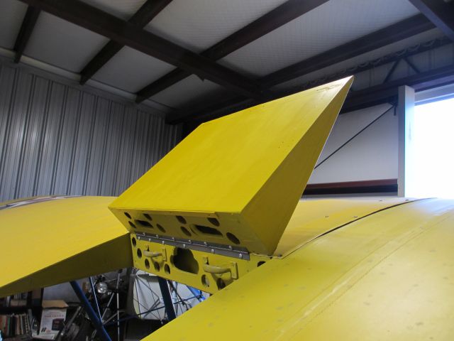

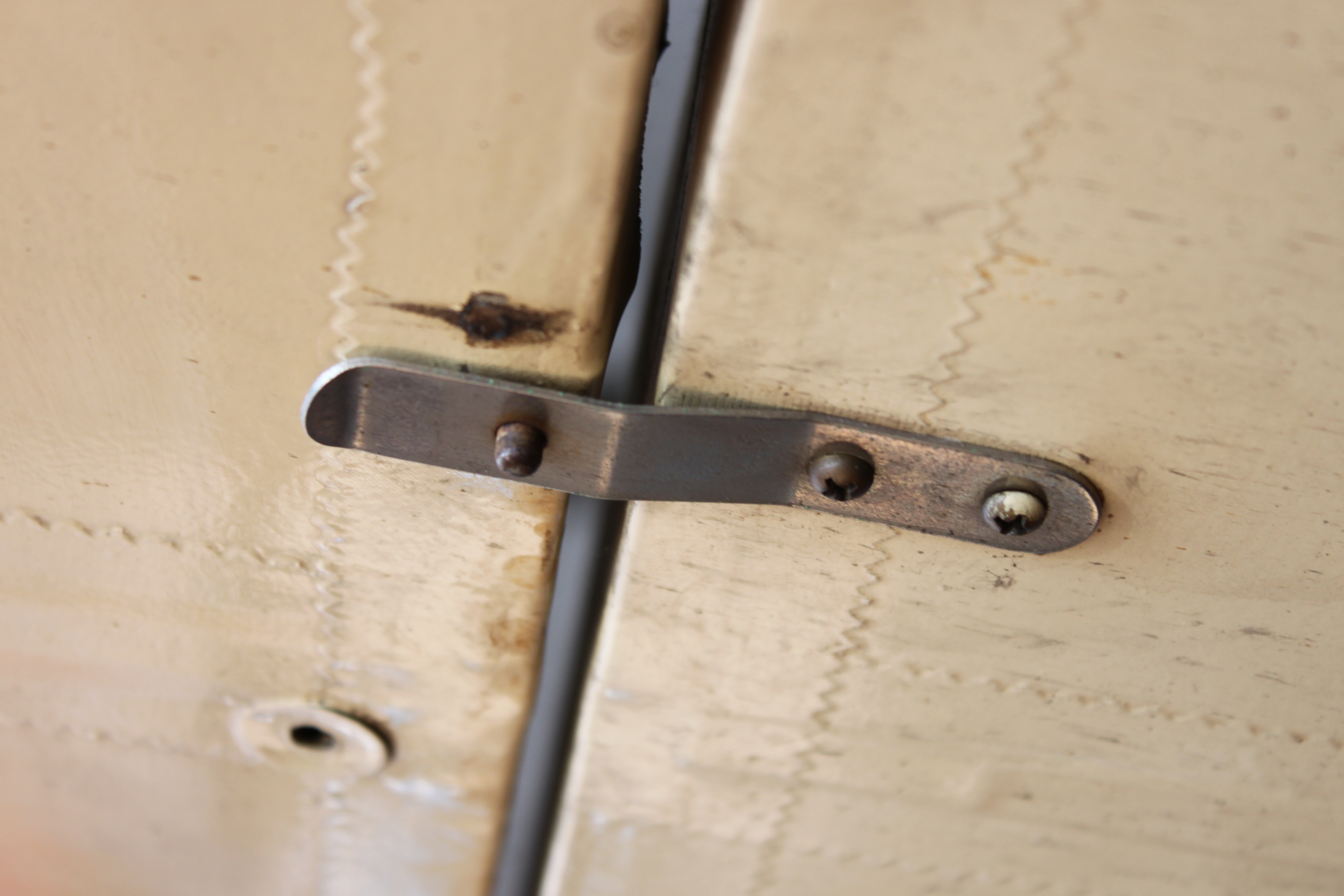

Johnny. I fly Ken Perkin's Piet N34KP. I thought I'd post a couple of photos of Ken's center section. I'm looking for a photos of the latch's he made, but you can see how his flop folds flat to the top of the wing. He used strap hinges similar to the original hinges used on the ailerons. In the second picture you see the flop partially open. That's how I fly it, that way it clears my head. It also makes a good stall warning indicator. It stands straight up just before the break!
Well, now that I've seen the strap hinge version compared to my piano hinge version, I like the strap hinge version better. Much simpler, fewer fasteners, it lays flat. Nice!

I got a chance to take some pictures of Ken's Piet's flop.
