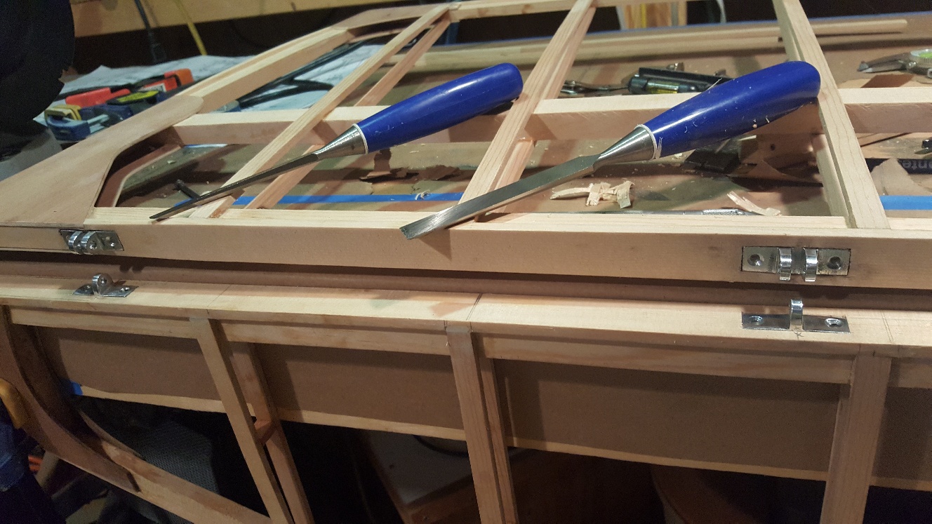

Thanks, not sure which I'll end up using... a ways to go yet. Gary has been a great resource and love the look of his plane. I've been busy cleaning up some beautiful cast tail hinges. They worked out perfectly, thanks Oscar!

Wow... you polished up those hinges to a real shine!
