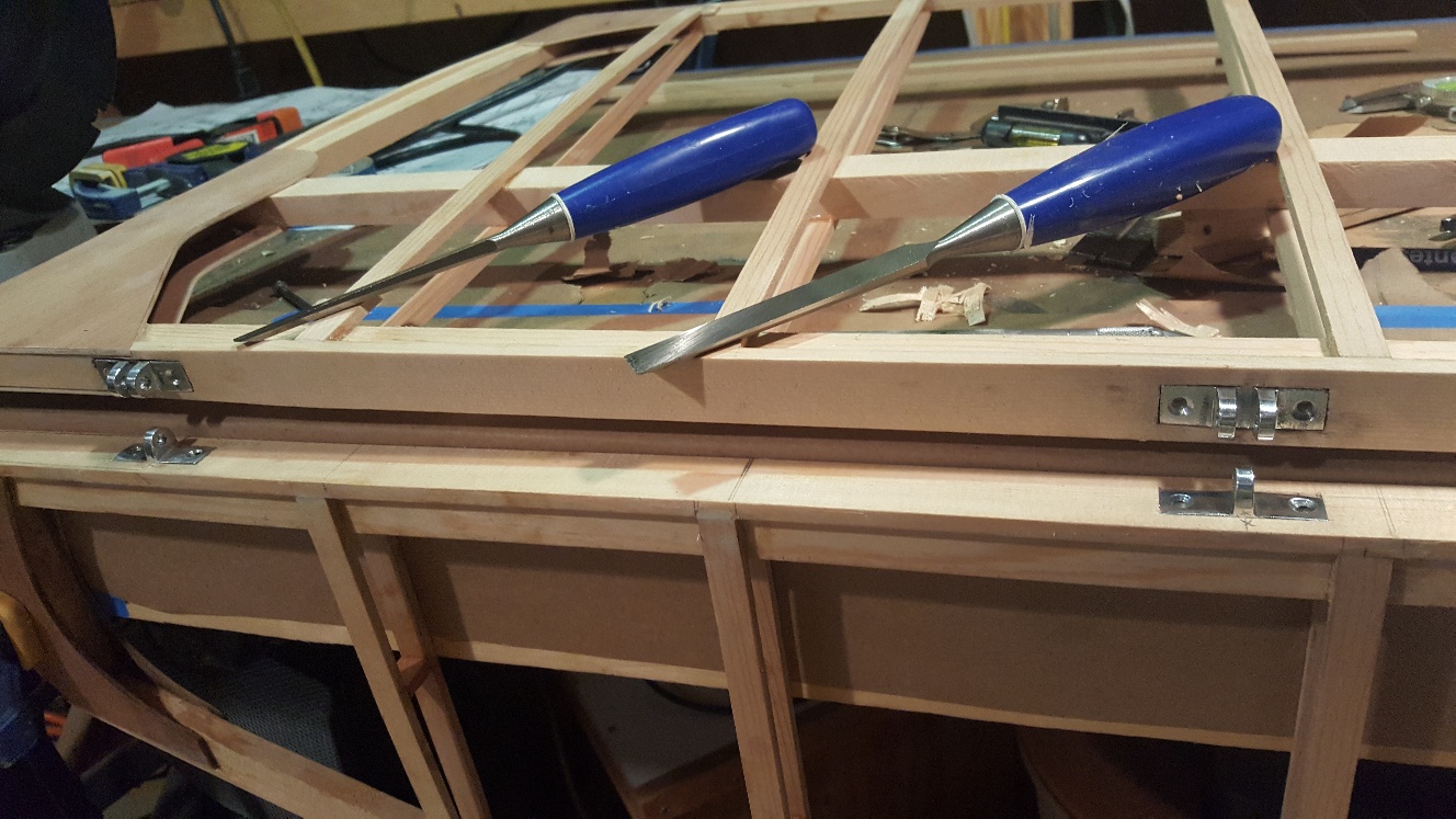

Thanks, not sure which I'll end up using... a ways to go yet. Gary has been a great resource and love the look of his plane. I've been busy cleaning up some beautiful cast tail hinges. They worked out perfectly, thanks Oscar!
Colonel Rosa Kelbb
Re: Tail Wheel weight consideration?
Wow... you polished up those hinges to a real shine!
