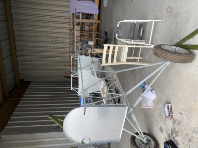

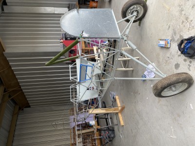

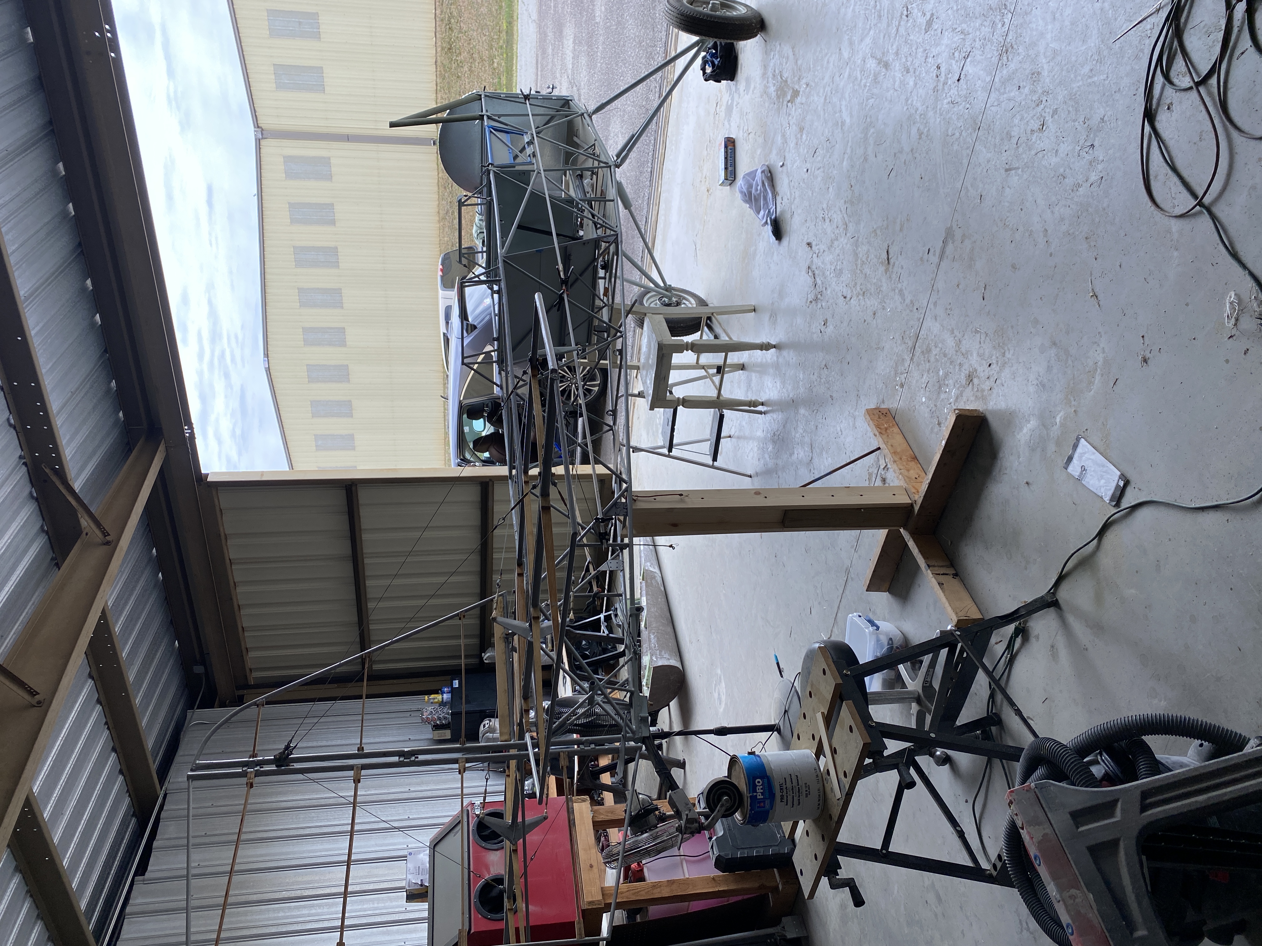

It was Terry Hand's plane, super nice guy. I picked it up a couple weeks ago. I'm still working on my shop in the basement and the lighting is not good. I have some pics from Terry's hanger. So it looks like if you click on the image, it will rotate it 90 degrees.
