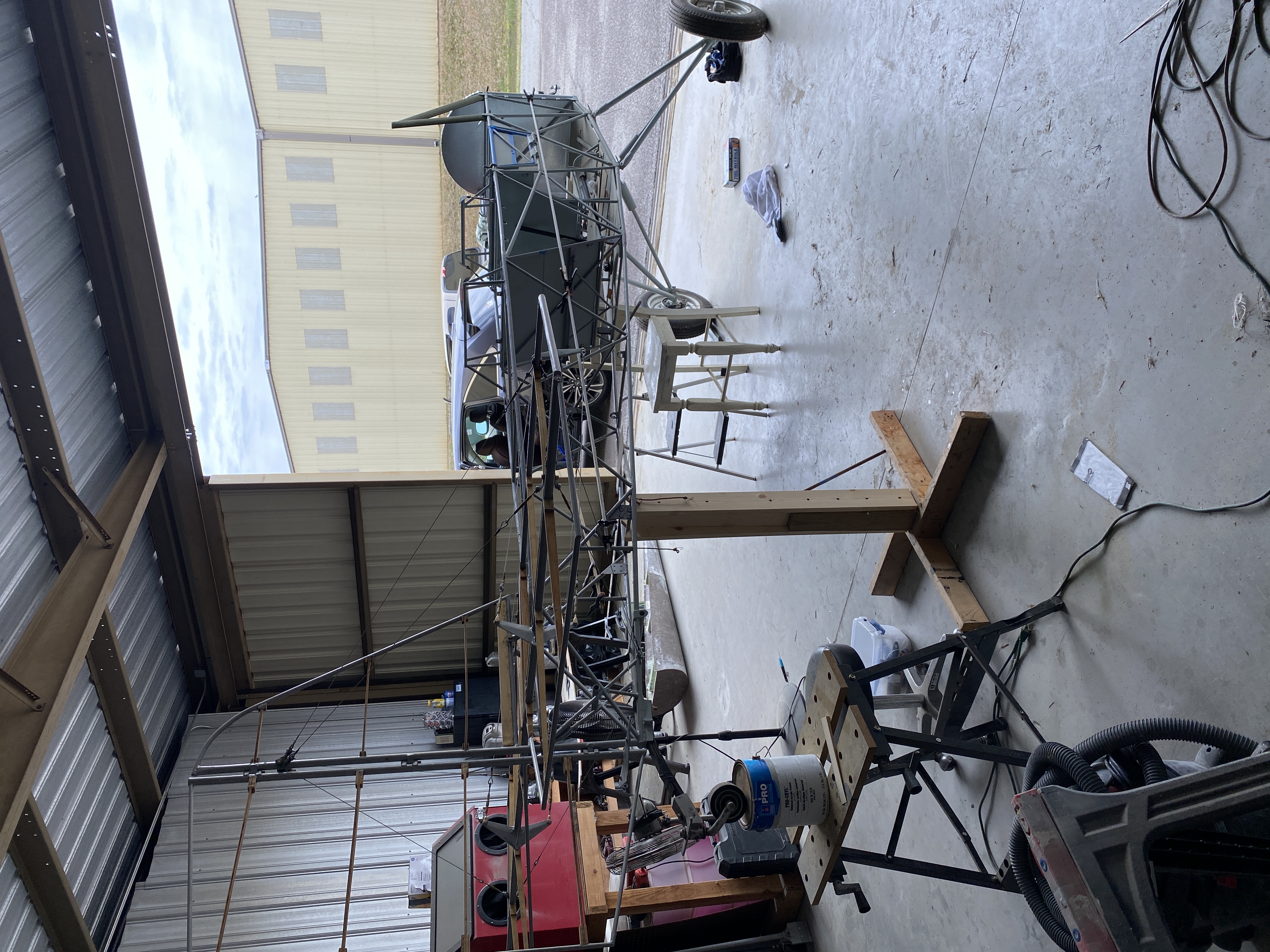

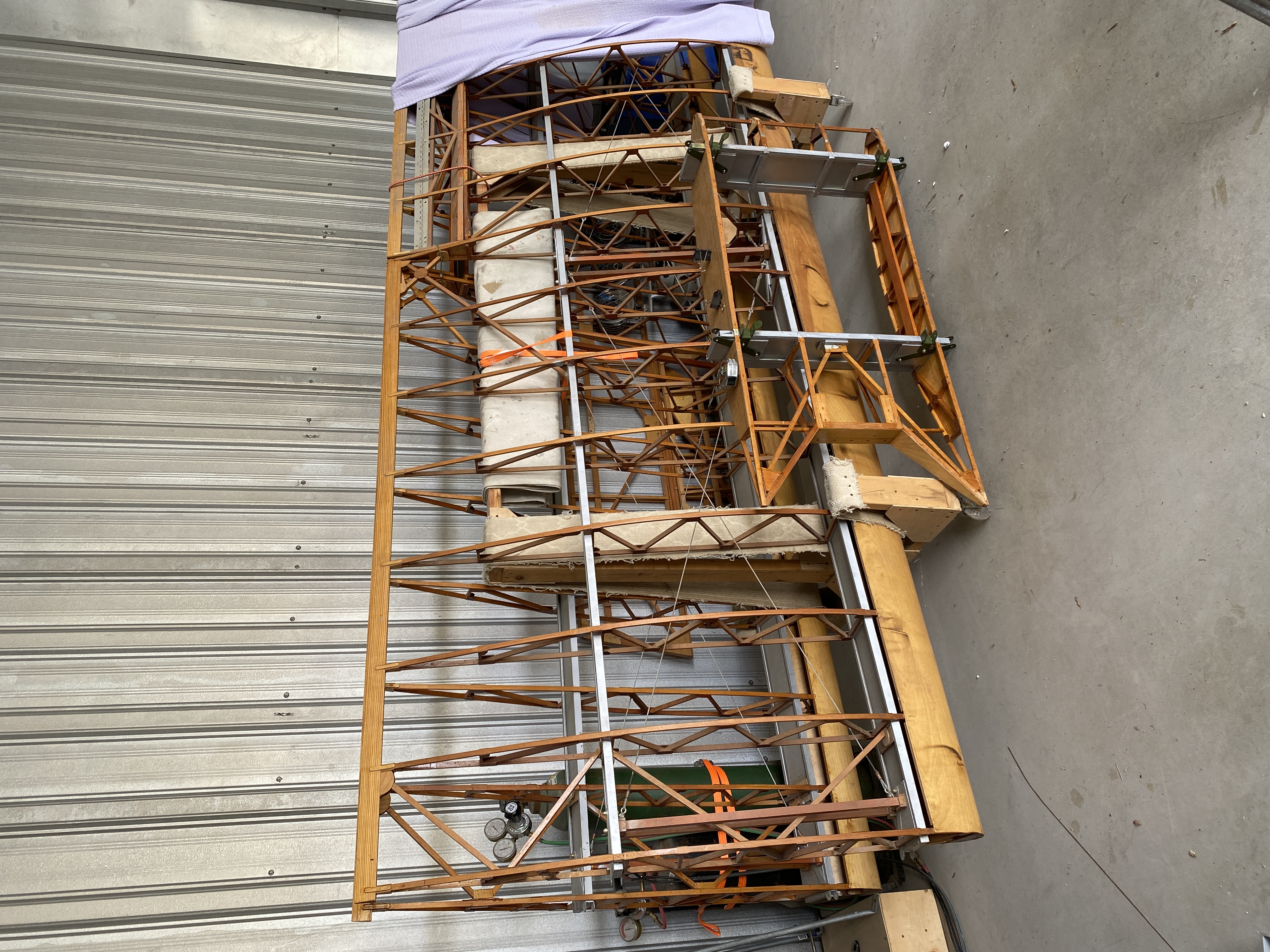

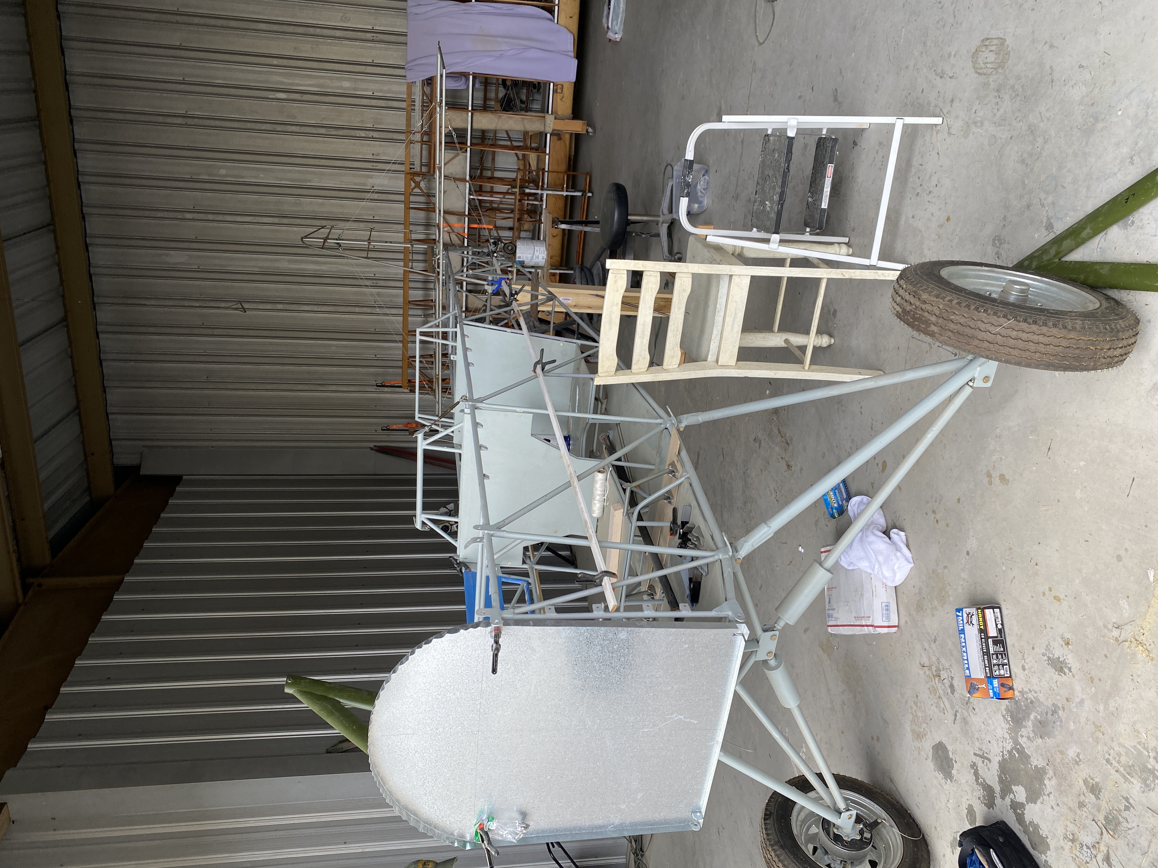

It was Terry Hand's plane, super nice guy. I picked it up a couple weeks ago. I'm still working on my shop in the basement and the lighting is not good. I have some pics from Terry's hanger. So it looks like if you click on the image, it will rotate it 90 degrees.r1200gsDave wrote: Sat Apr 30, 2022 3:53 pm Photographs would be very helpful.
I have been working on my Piet for 10 years and I am still working on the order of operations though.....
