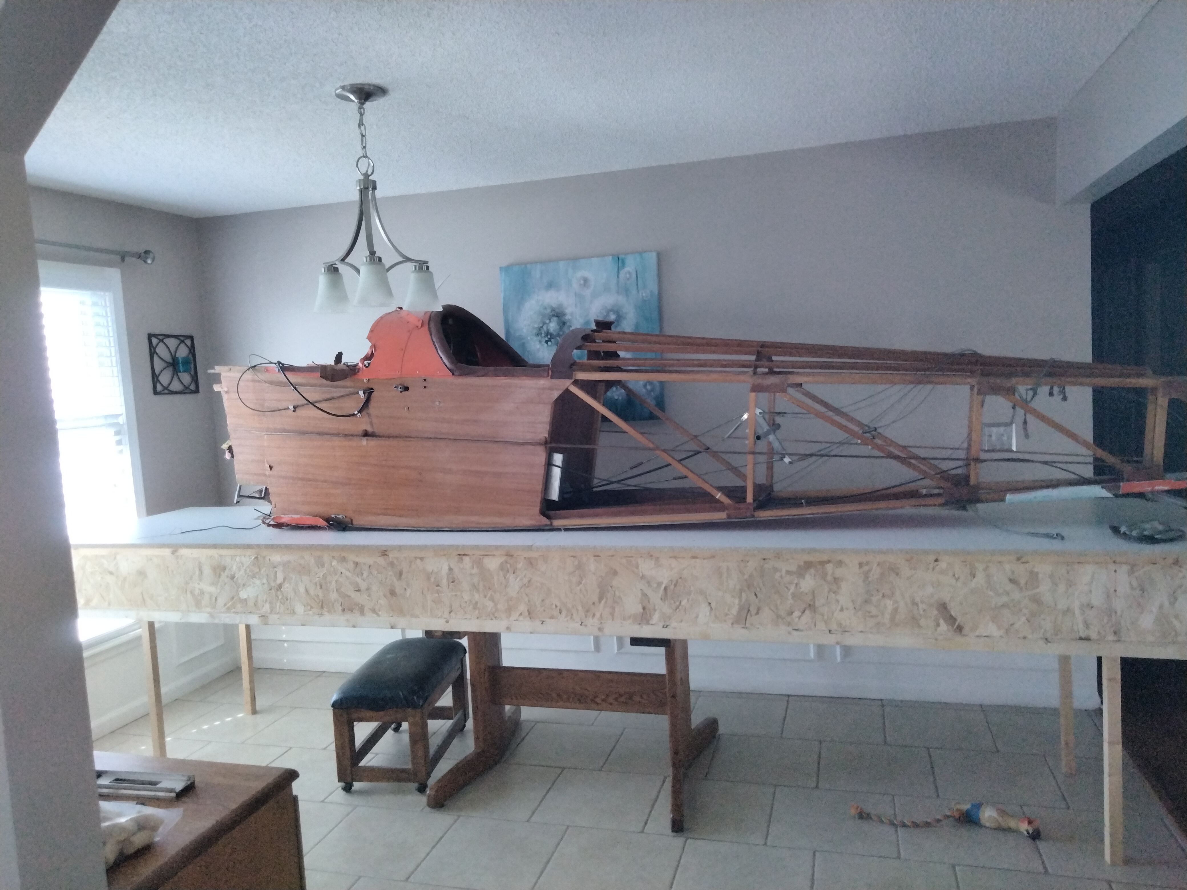

I've decided to move the dining room table, build a work table in the dining room and do the repairs there. Great lighting and a easily cleaned ceramic tile floor (for spilled epoxy!). Nice and warm too. It'll help having my tools in one place also.
When the fuselage is done I'll cut the center section out of the wing and do the repairs at home also, build a new center section here too.
Lisa would roll her eyes, but she would understand.
- Posts: 366
Re: N34KP's rebuild
Well. Lots of delays due to family issues (one of my grown kids) and paperwork related to my wife dying. Today I had a free day, so I assembled the pieces to the new work table in the dining room. Everything turned out surprisingly level and square. I am going to put braces to the floor on both ends. 34KP already has enough damage without me dumping it on the floor.
