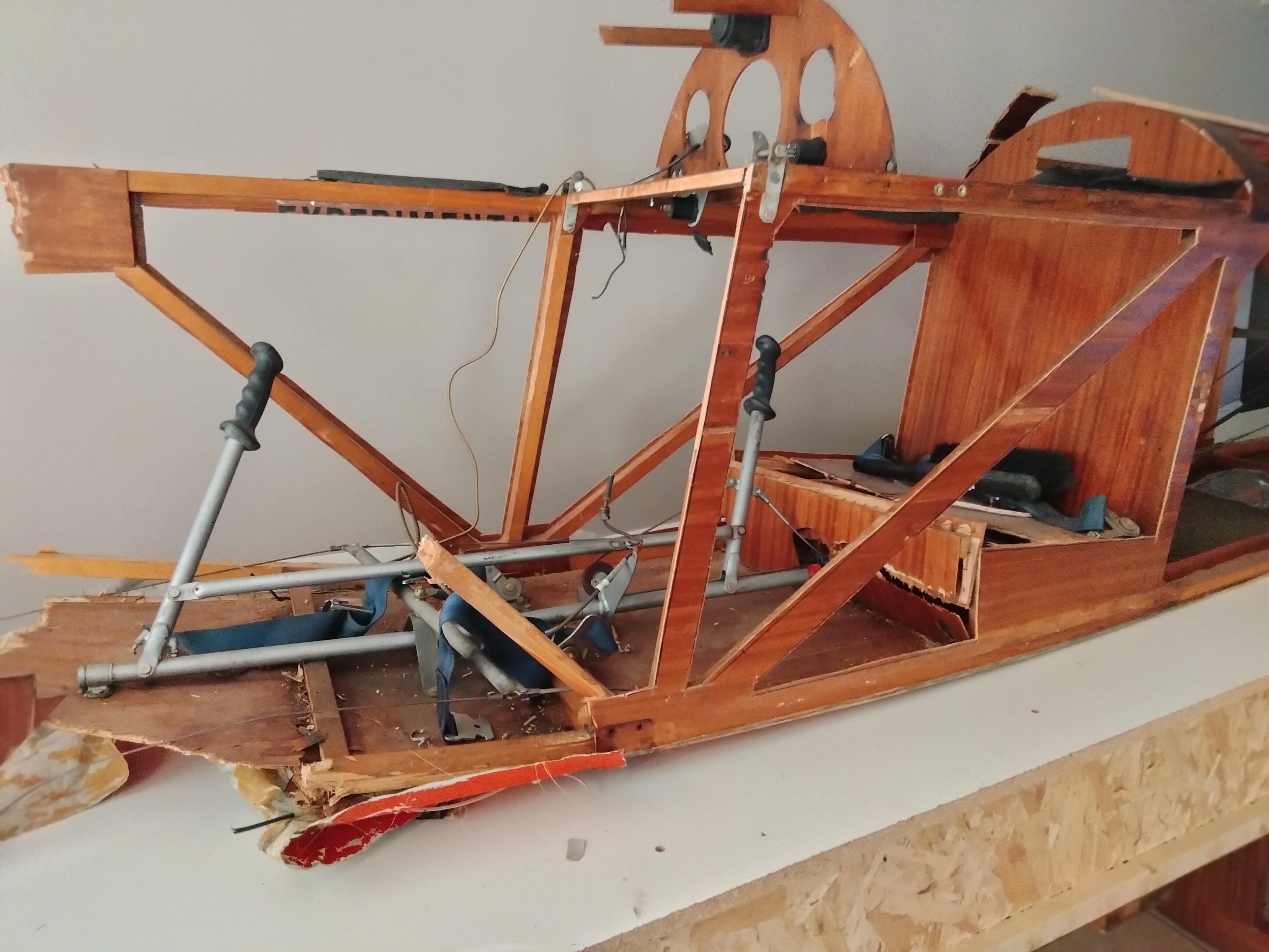

The fuselage will be pretty much new from the pilots instrument panel forward. The wing needs a new rear spar. The front spar and leading edge are damaged in the center section, so the wing will become a three piece wing. Lots of bent and broken things.

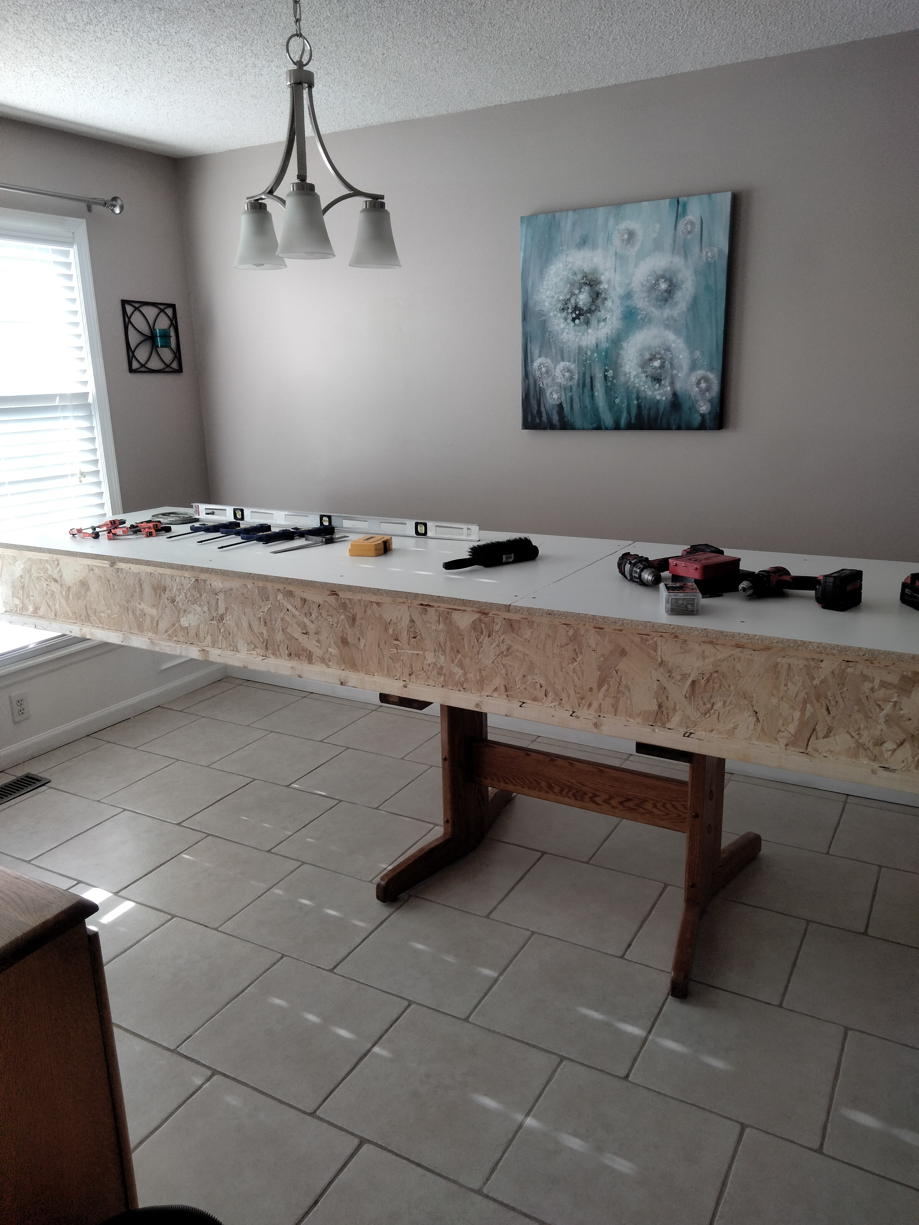

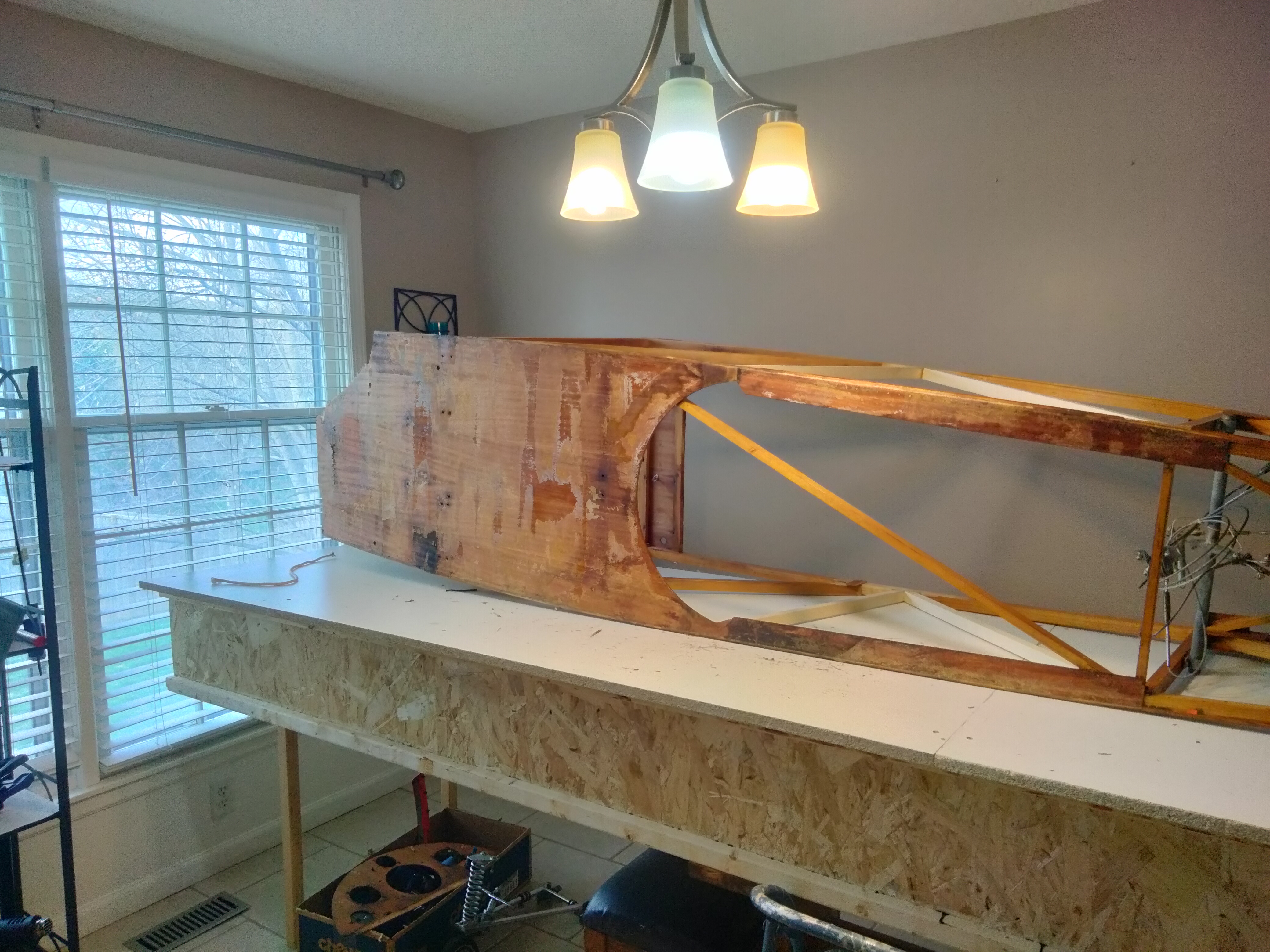

I've decided to move the dining room table, build a work table in the dining room and do the repairs there. Great lighting and a easily cleaned ceramic tile floor (for spilled epoxy!). Nice and warm too. It'll help having my tools in one place also.

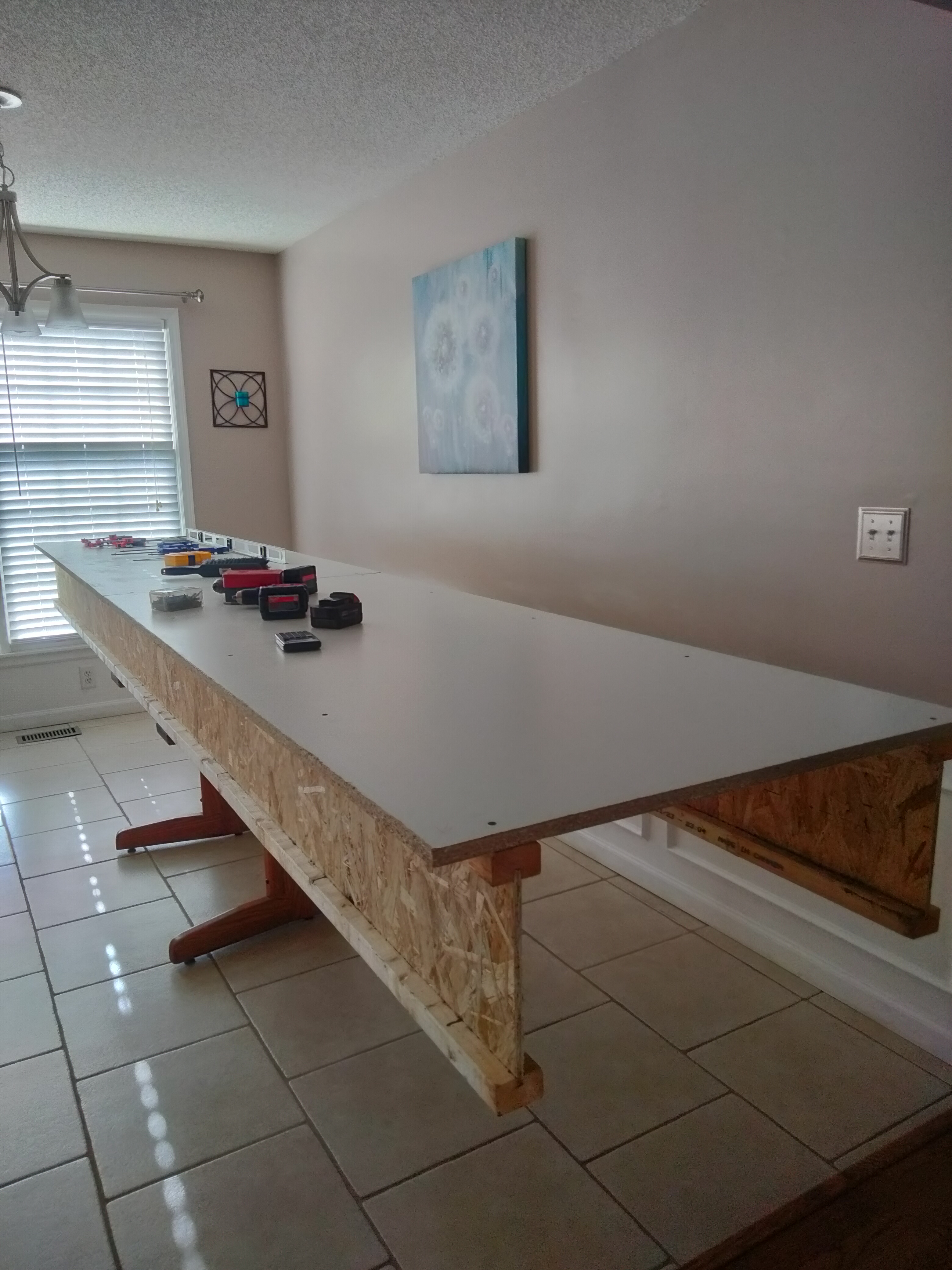

Well. Lots of delays due to family issues (one of my grown kids) and paperwork related to my wife dying. Today I had a free day, so I assembled the pieces to the new work table in the dining room. Everything turned out surprisingly level and square. I am going to put braces to the floor on both ends. 34KP already has enough damage without me dumping it on the floor.
- Posts: 76
Re: N34KP's rebuild
If you sheet the bottom, it makes a very stable box. Also, if you move the I beams inboard a bit, you can store long things on the outside where they are handy.

I know, right Larry? Built-up spar with plywood webs and lightening holes... nice job, and interesting. The airfoil isn't a stock Piet and the spars look deeper than a Piet's, but the concept is good just the same.

It's a Legal Eagle. I was just showing the concept of the building table. The spars are very light, though.. and the wing has been tested to 4Gs.

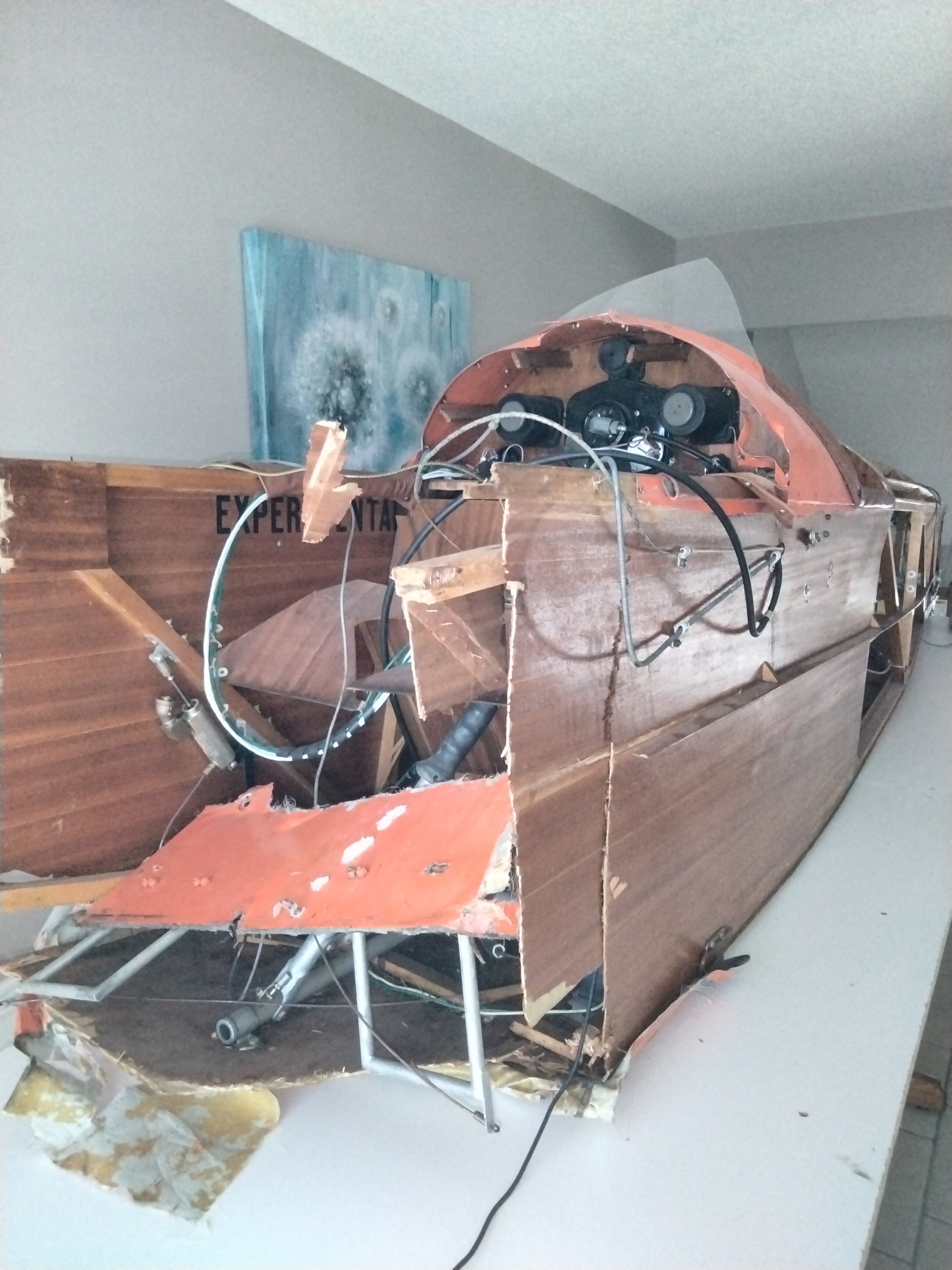

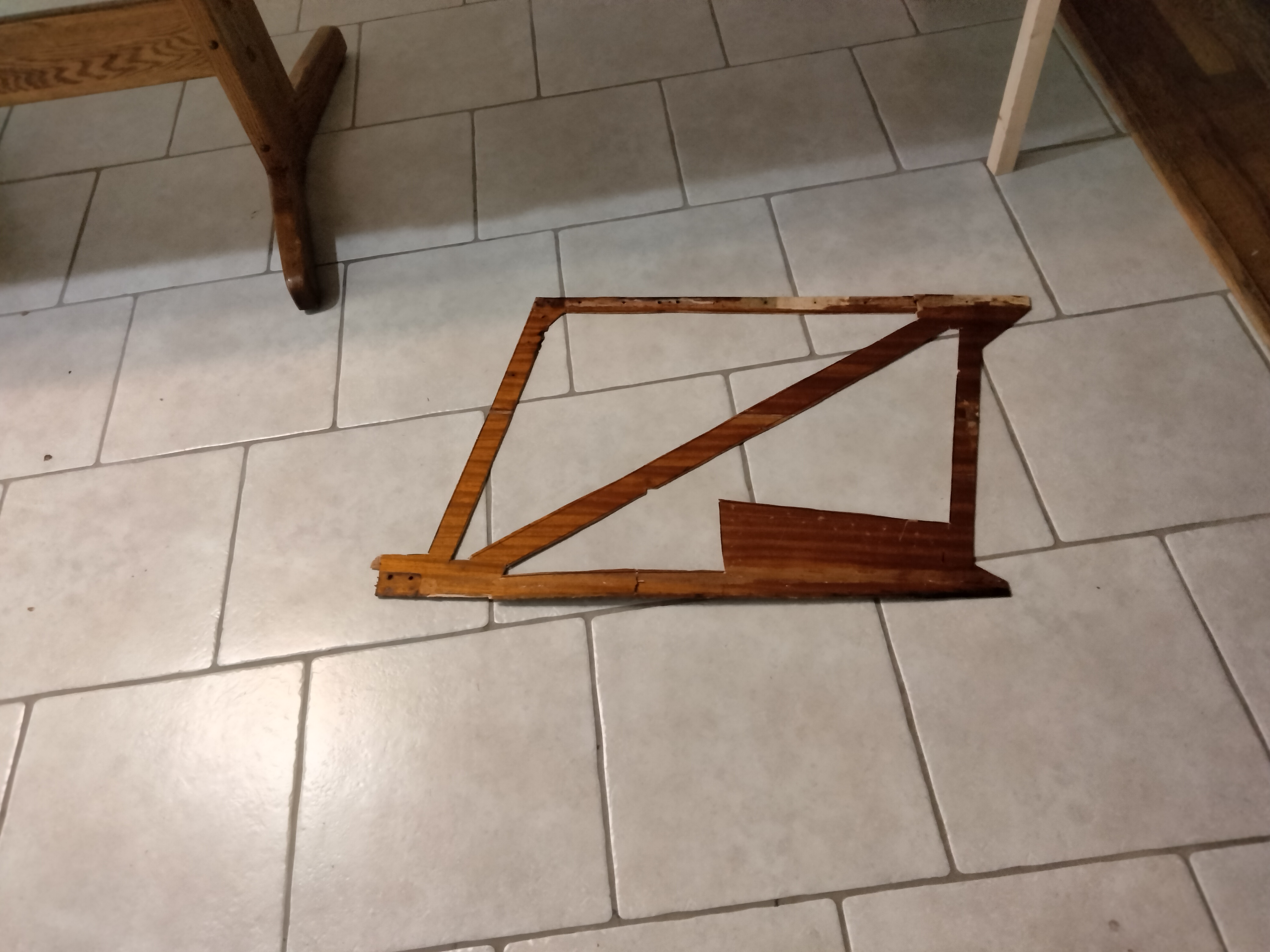

I've cut the plywood between the trusses off. I found some more damage, here and there. The next step will be to peel the remaining plywood off the truss itself, then the floor plywood. Probably not necessary, but I'm considering 45° plywood when I go back together. Something to consider.

How do you plan to get the plywood off? That looks like a tough job to me..

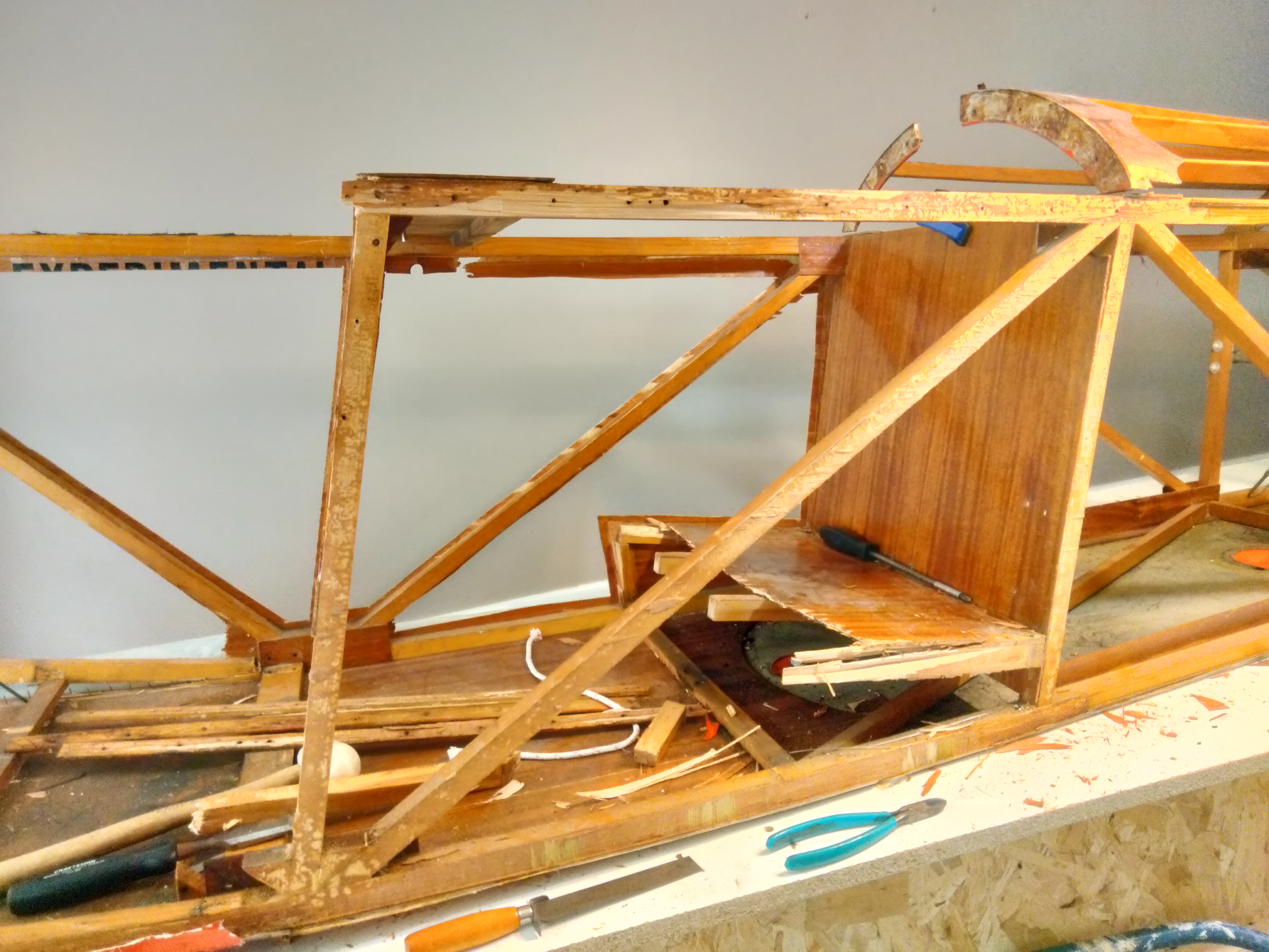

I'll remove the plywood with a heat gun and a thin piece of stainless steel sheet. I did it for years while working on 767's.
Removed a lot of the plywood from the truss today. I also removed the rest of the controls that would be in my way.
Re: N34KP's rebuild
What a patient and loving endeavor, Richard. The Pietenpol community will owe you a lot for preserving this piece of Air Camper history alive and flying. What an excellent fellow you are for doing this for Ken, for the Pietenpol family, for the aviation community as a whole. You could have just chucked it all into a bonfire and walked away...

Does that work with T88?Richard Roller wrote: Sun Mar 03, 2024 9:30 pm I'll remove the plywood with a heat gun and a thin piece of stainless steel sheet. I did it for years while working on 767's.
Re: N34KP's rebuild
Where is the plywood on a 767? I miss the wood block on the engineer's panel of the 727. I never did know why it was there.
- Posts: 345
Re: N34KP's rebuild
None on a 767 structure.
We used thin stainless steel (.015 +-) to cut through the adhesive under existing patches, etc. We also used it when cutting pieces out of the skins over underlying structure. Slide it between the layers and cut very carefully through the skin until you saw sparks start to come out, then stop.

Yes, you can soften T88 with a heat gun.

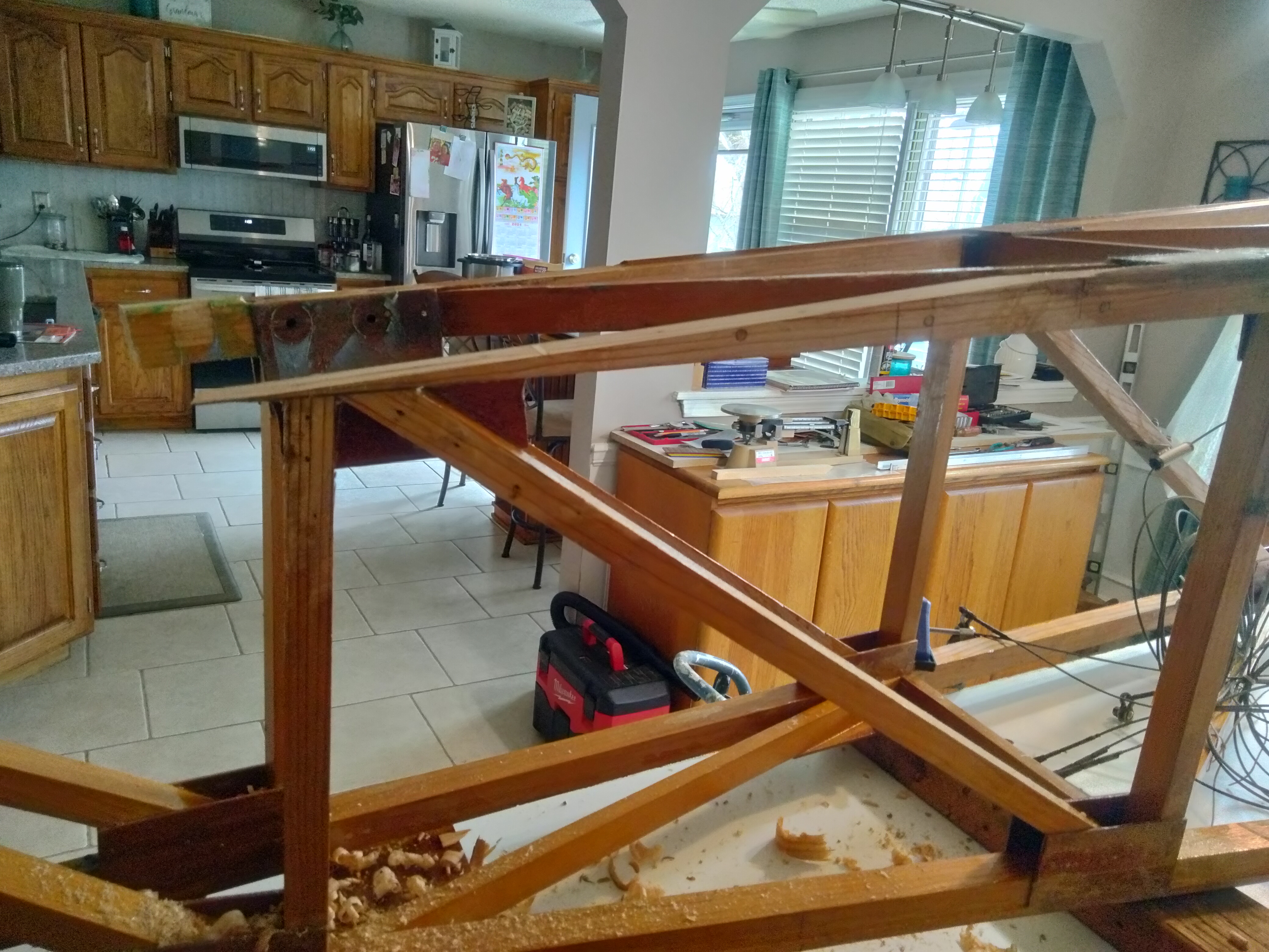

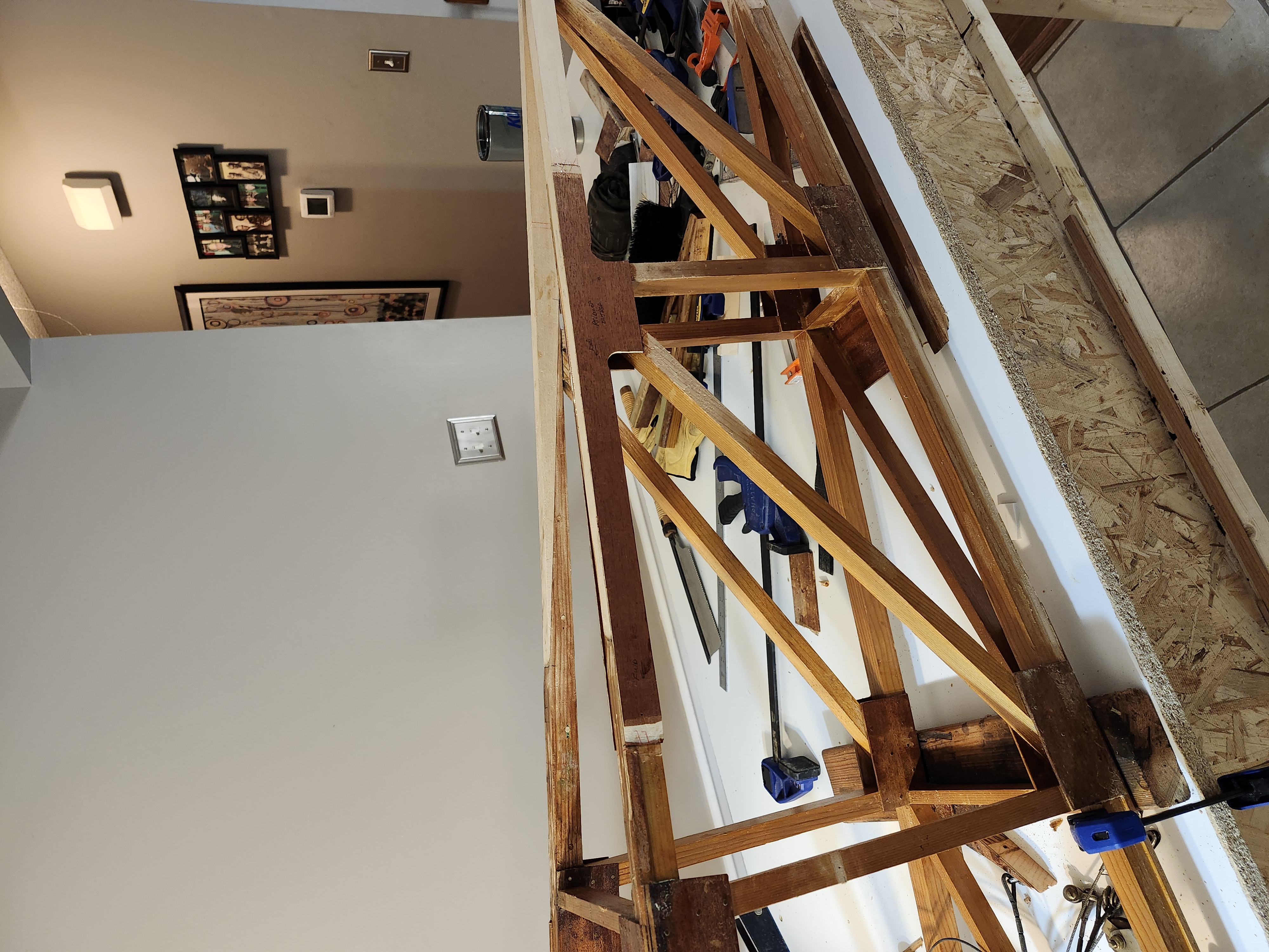

I cut the left and right station piece and the rear diagonals for moving the seat back today. Lots of measuring before the cuts. They turned out good!

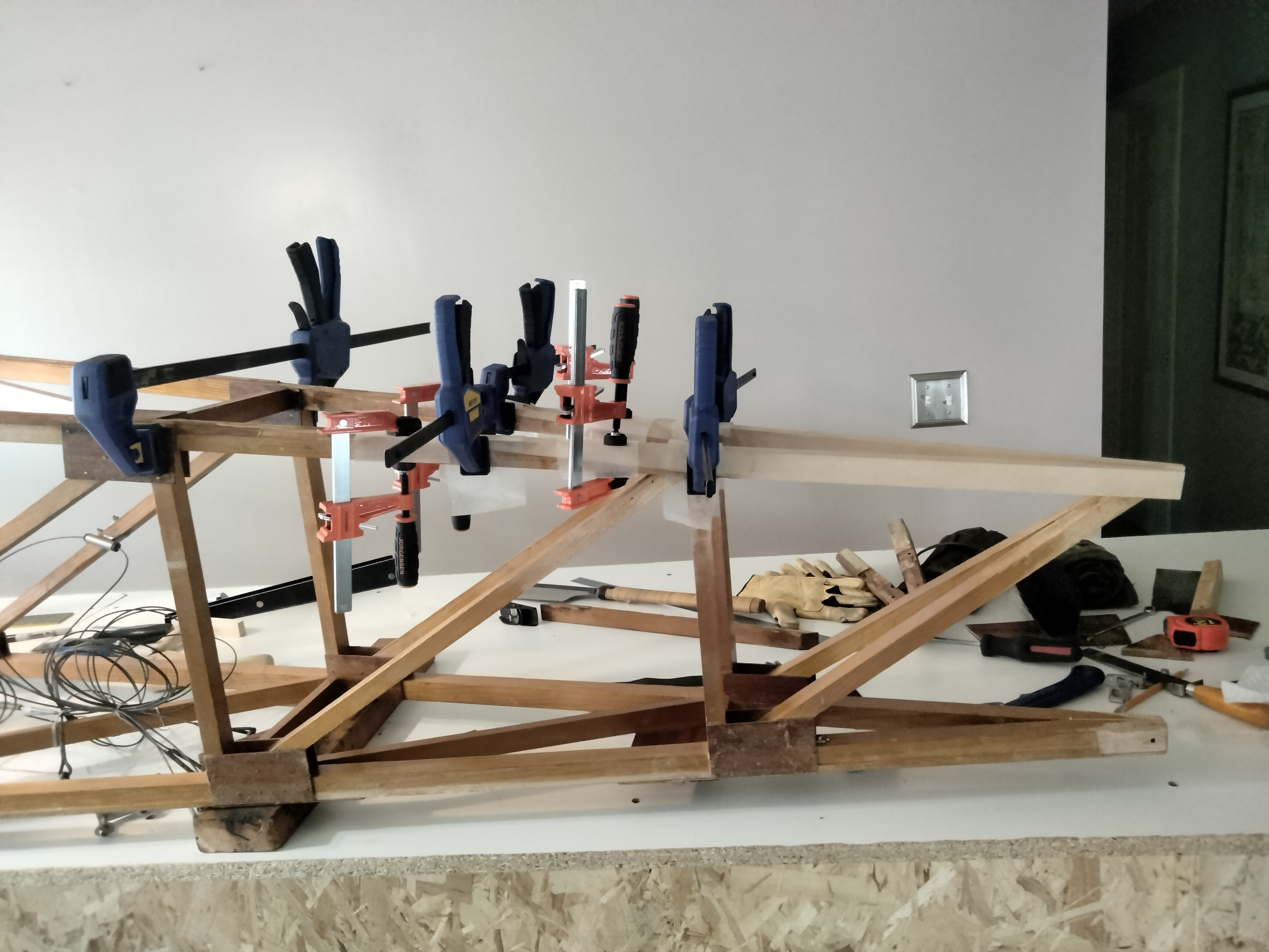

Well. My first glue up. This is the test. I could tell it's been a long time since I did composite repairs for a living, I mixed way to much! I had about 4 times more left over than I used on the joints. Oh well, I'll get back in practice. Nice joints with just enough squeeze out. I'm done till I get a chance to check the joints, tomorrow afternoon.

I had to do a repair to the lower left longeron where the tail wheel brackets attach 5 years ago. 15 to 1 taper centered on the middle between the bolt holes, .625" tall. I'll be splicing the longeron due to damage from last year's crash. I removed the doubler today and I was very pleased to see the previous repair glue line holding good.

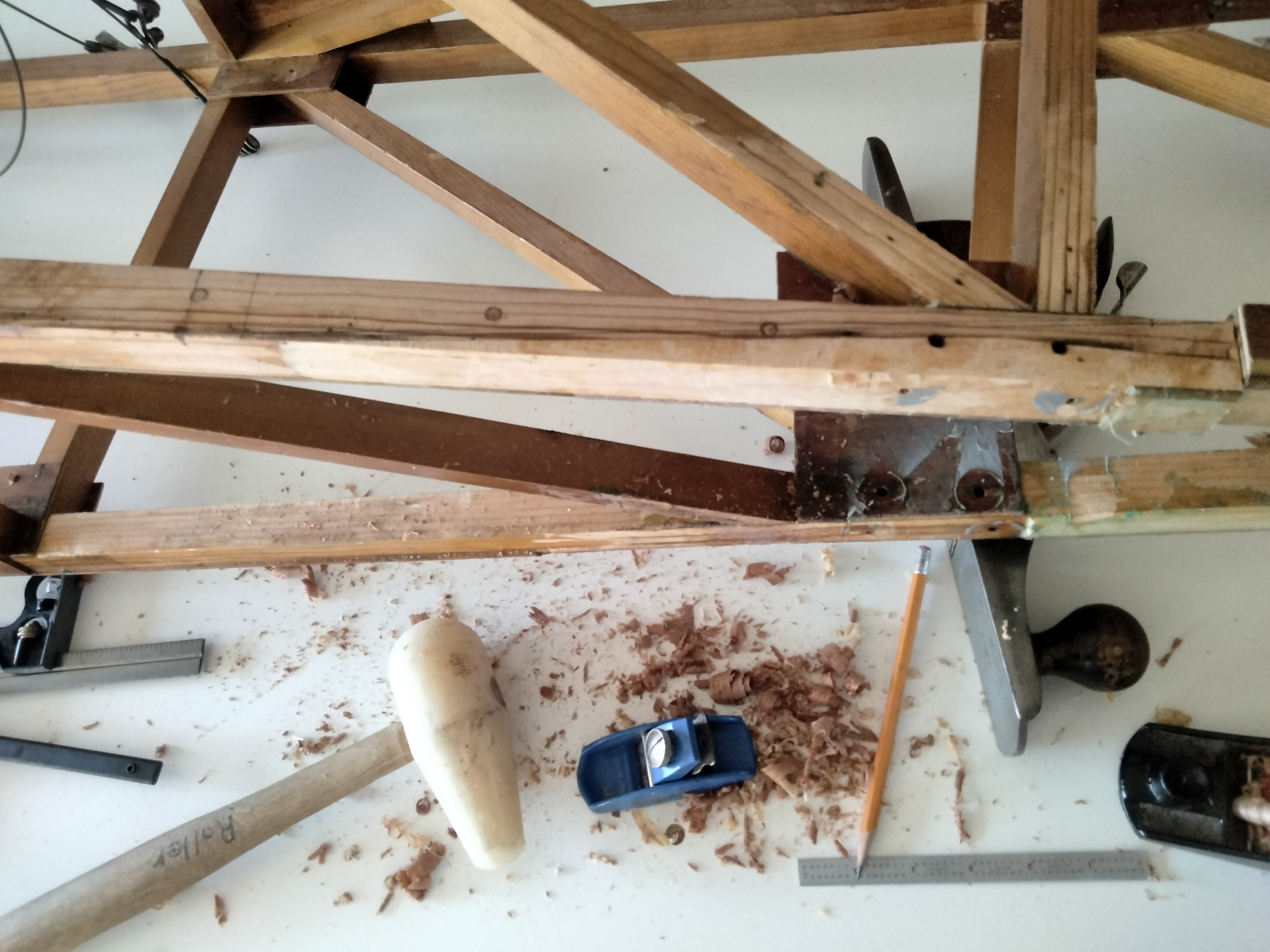

Finally got up the nerve to try the first scarph. This is the lower left longeron, just forward of the tail post. 15 to 1 slope. Done with wood chisels and hand planes.

Seeing no other attaboy posted here yet, I'll raise my voice with one. Nice work, Richard! And with the simplest of tools, too. Carry on...

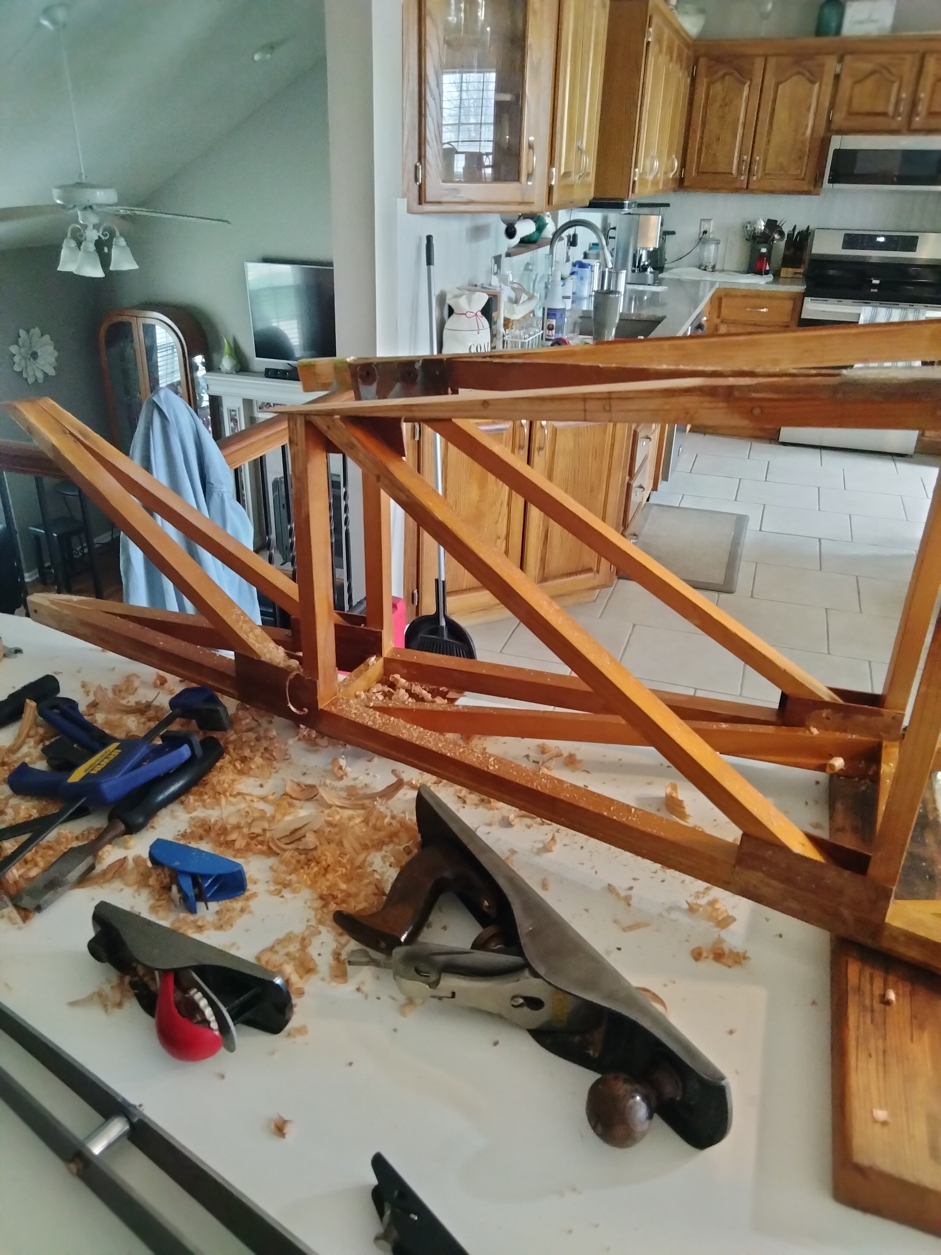

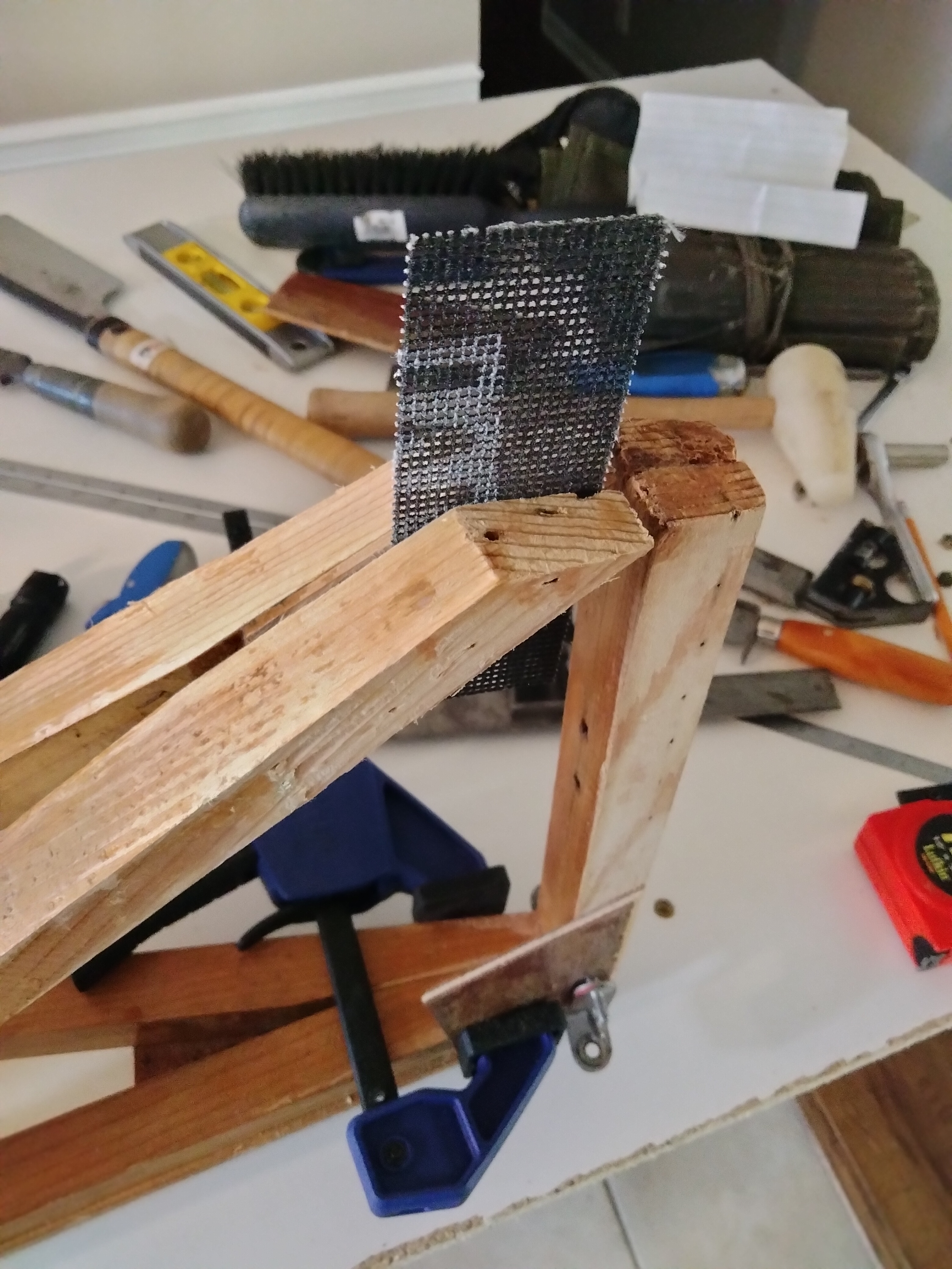

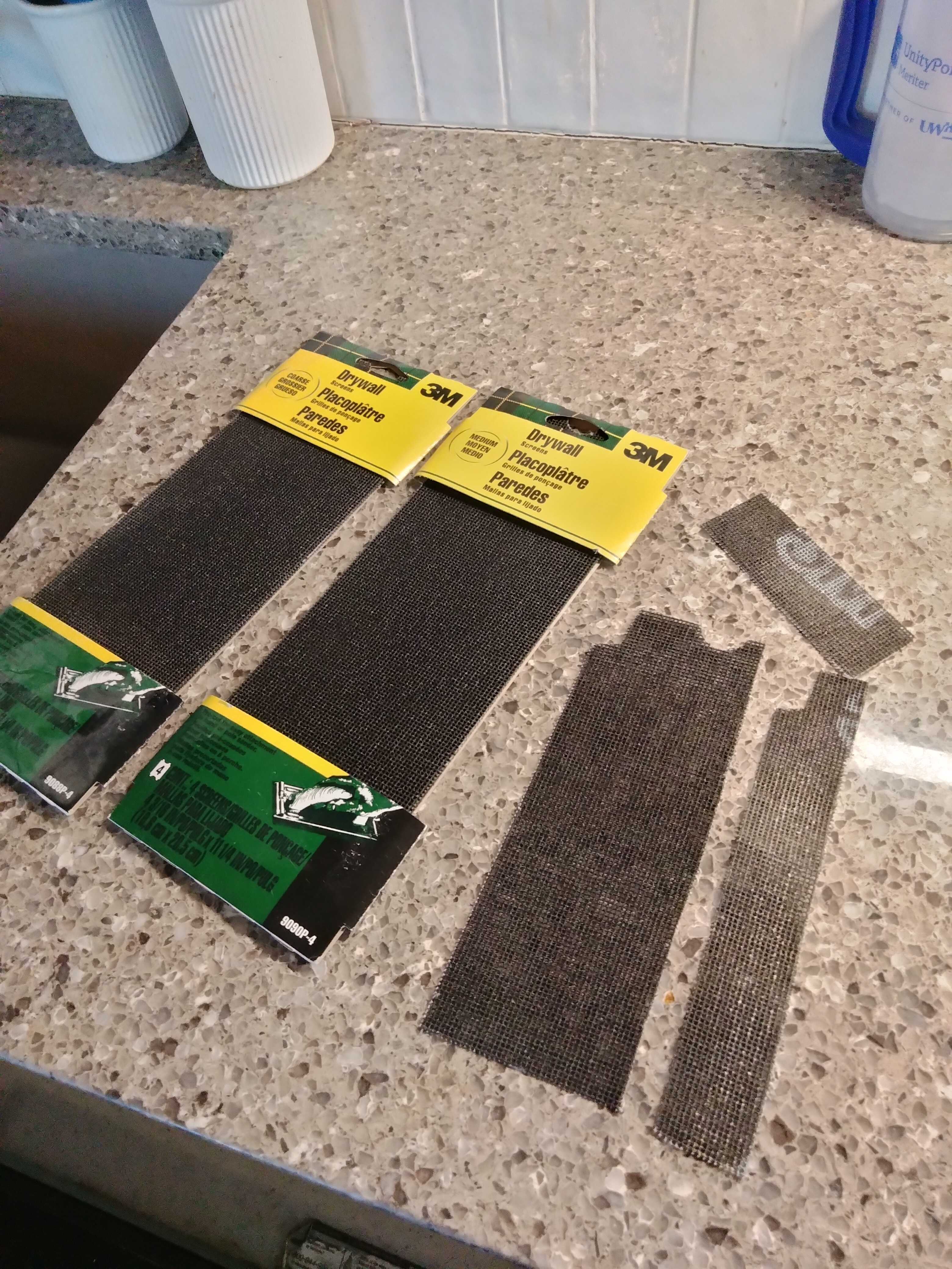

"For what it's worth". I've used drywall screens several times where I've needed to work old adhesive between pieces I didn't want to pull apart. Both on this project and the longeron repair from 5 years ago. I use the medium usually. Sometimes I dull it first so it won't be so aggressive.
Re: N34KP's rebuild
Oh. I have some of that same drywall sanding screen but never thought of using it when an exceptionally rough type of abrasion is just the ticket. Great idea... thanks!

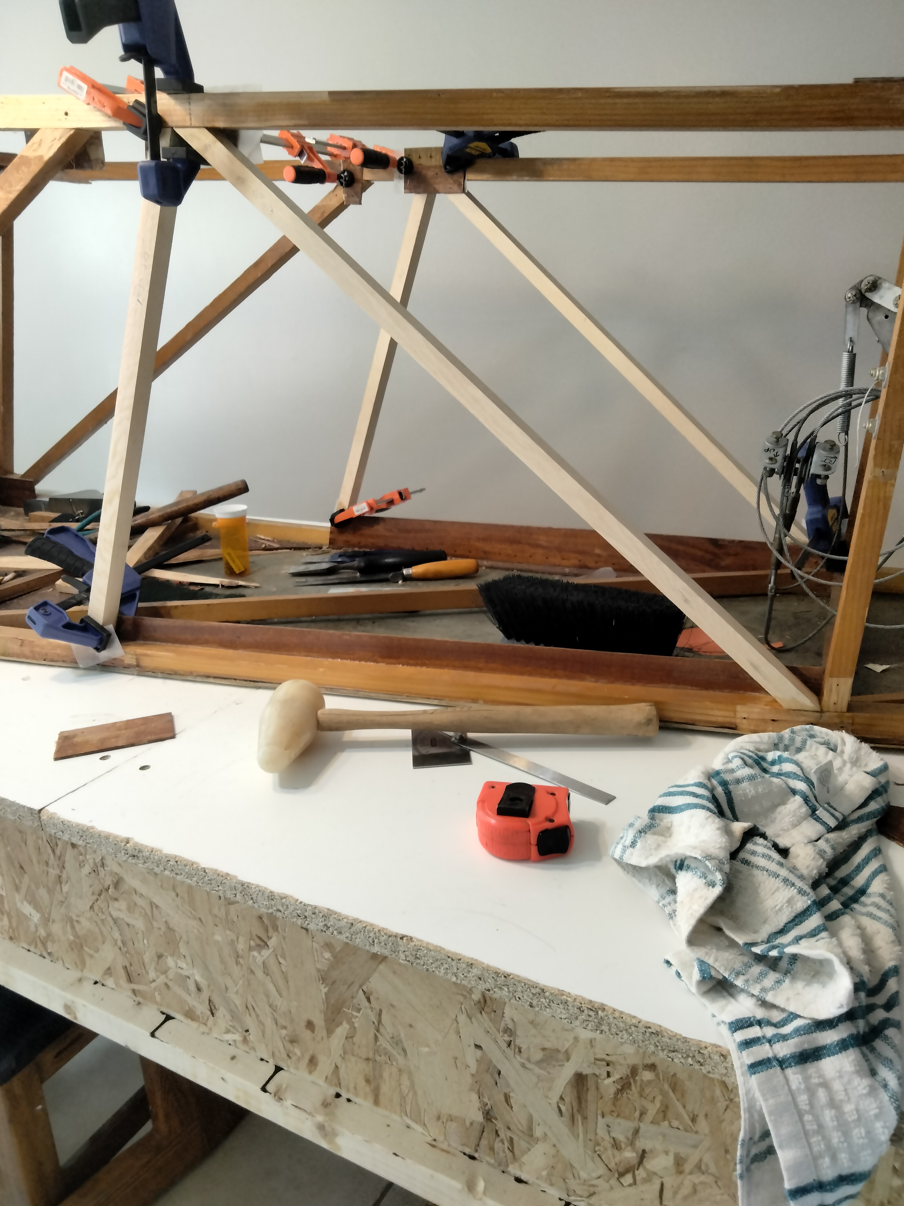

Left and right rear, bottom longerons are being glued.
Re: N34KP's rebuild
Tailpost will be in place in a jiffy.

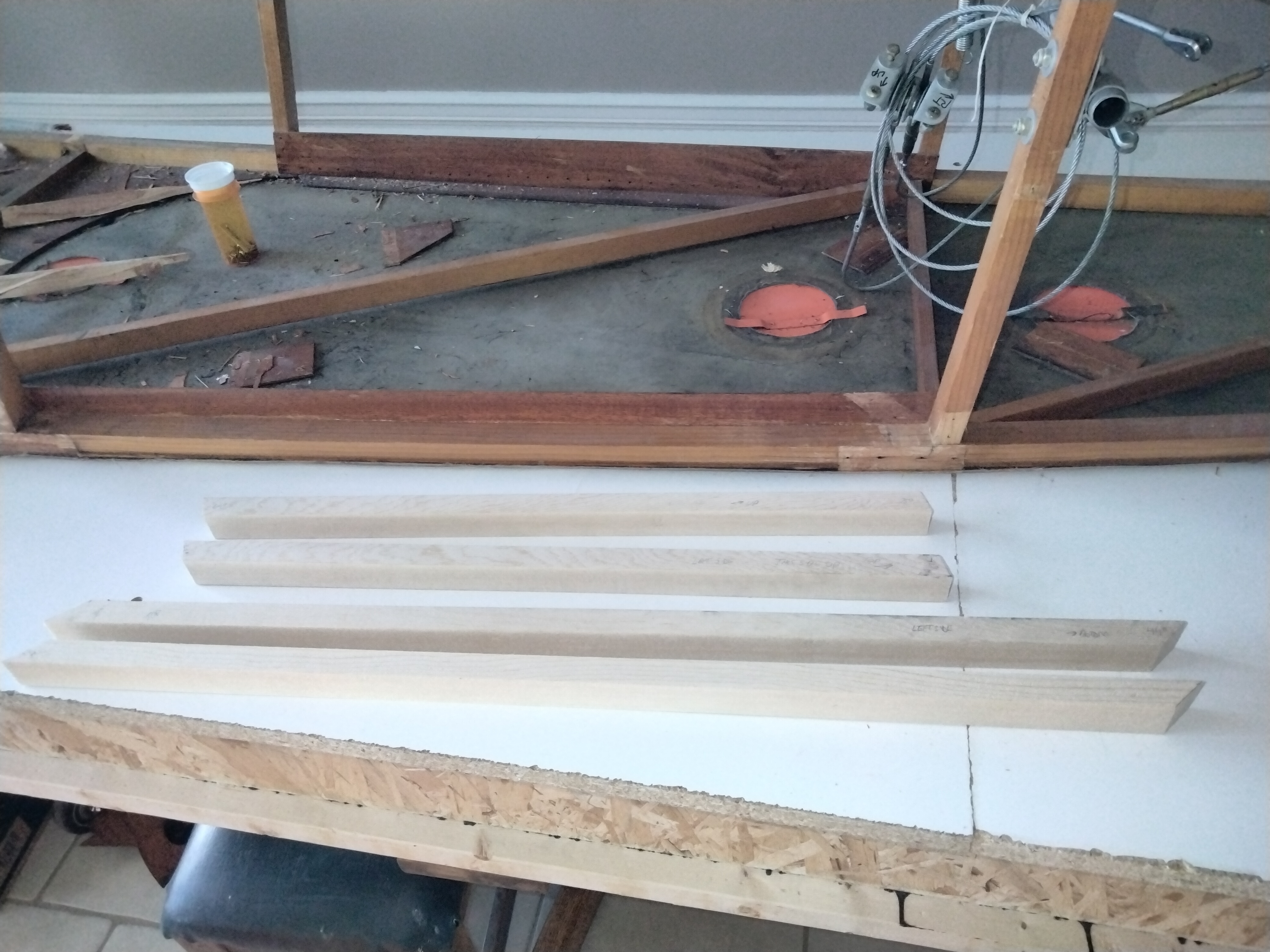

Glued the right lower longeron doublers today, inside and out. Heading south to see my mom and sisters in the morning. First time I'll have seen them since my wife Lisa died.
- Posts: 345
Re: N34KP's rebuild
The glue up turned out good. The edges will need to be planed to fit.
