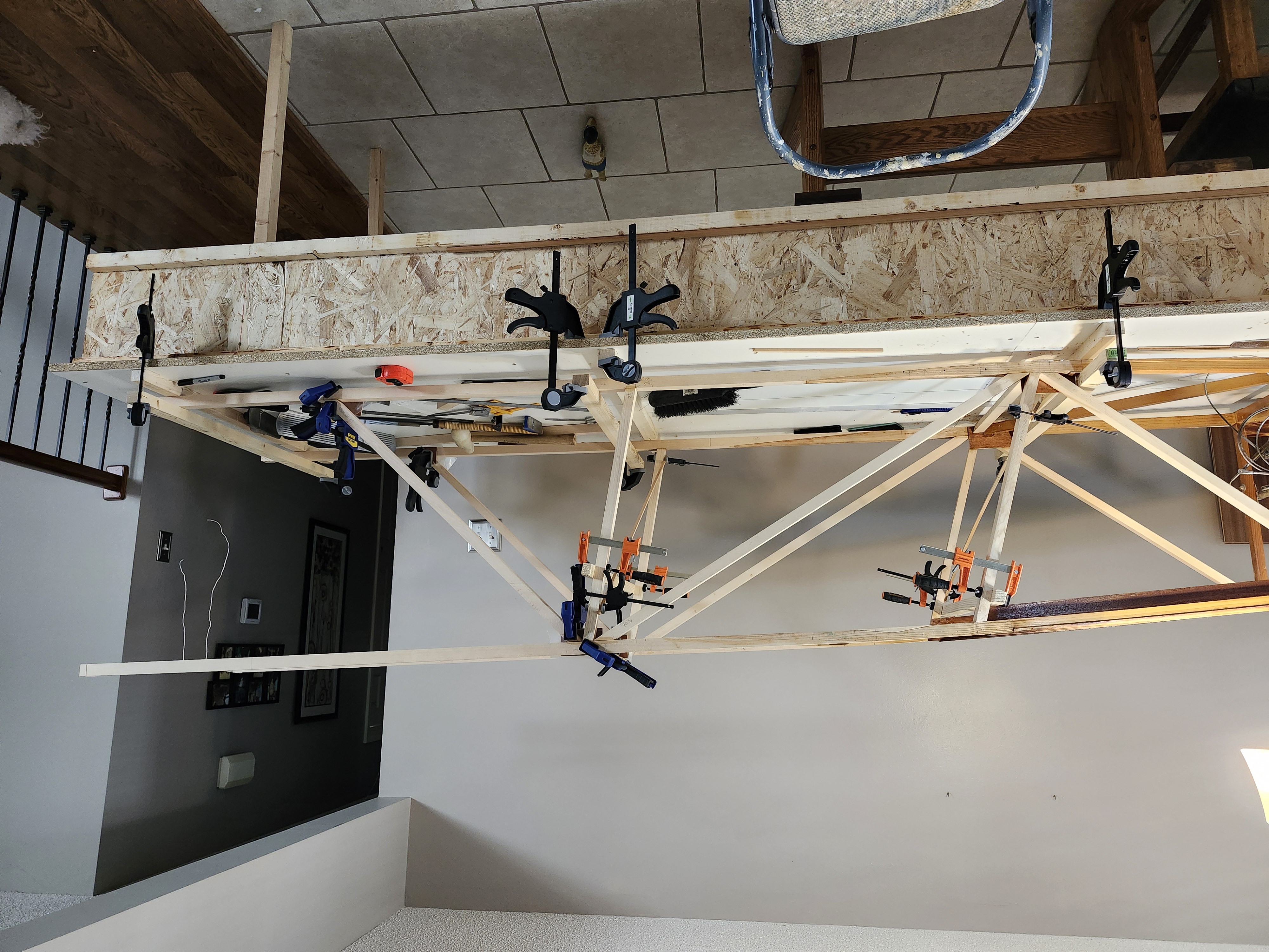

- Posts: 255
Re: N34KP's rebuild
Station piece, diagonal and doublers. Late night glue up.
