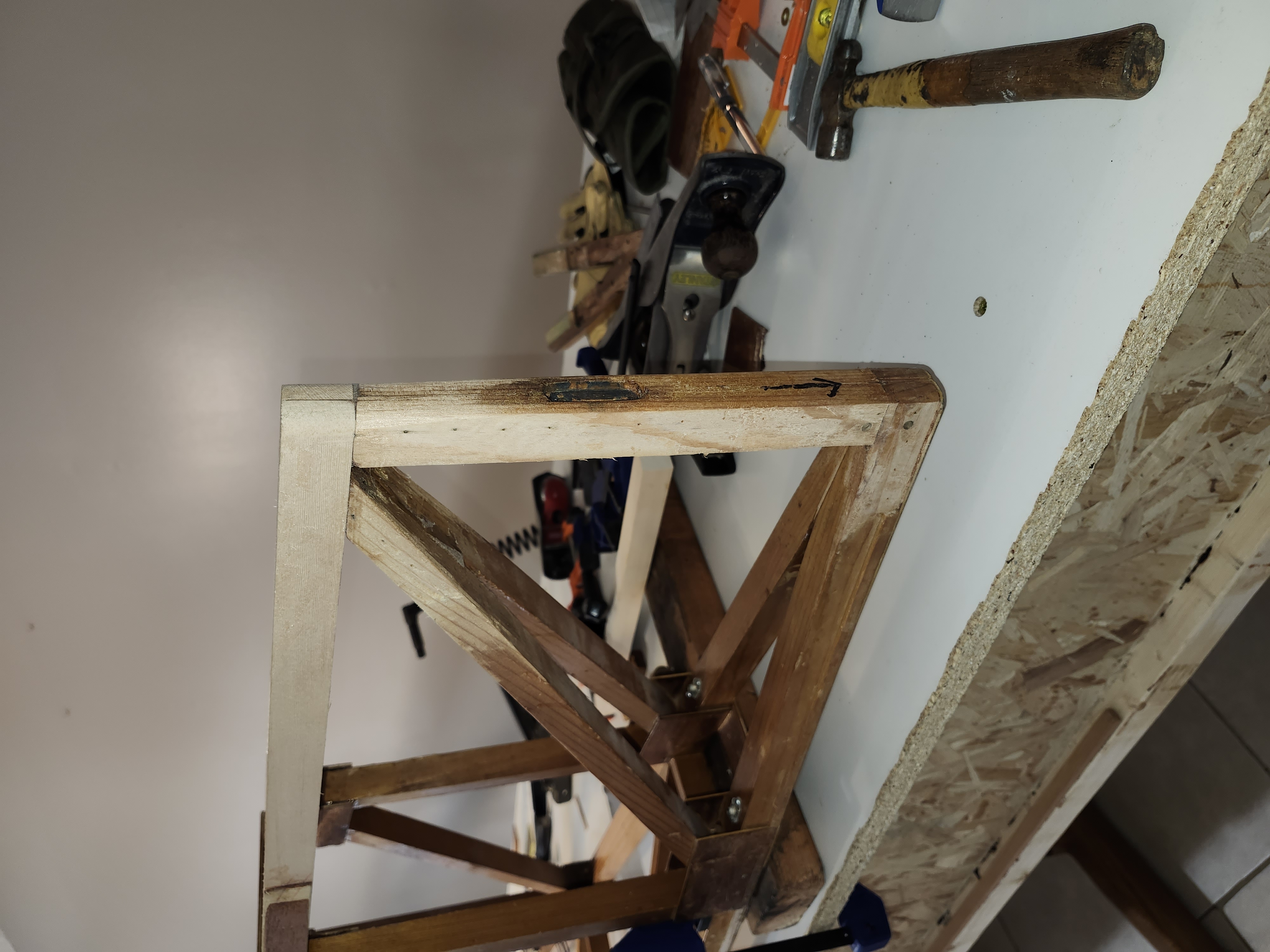

Looks like an airplane, from nose to tail.

Re: N34KP's rebuild
The tail reconstruction is finished except for fairing strips and holes for the fittings.

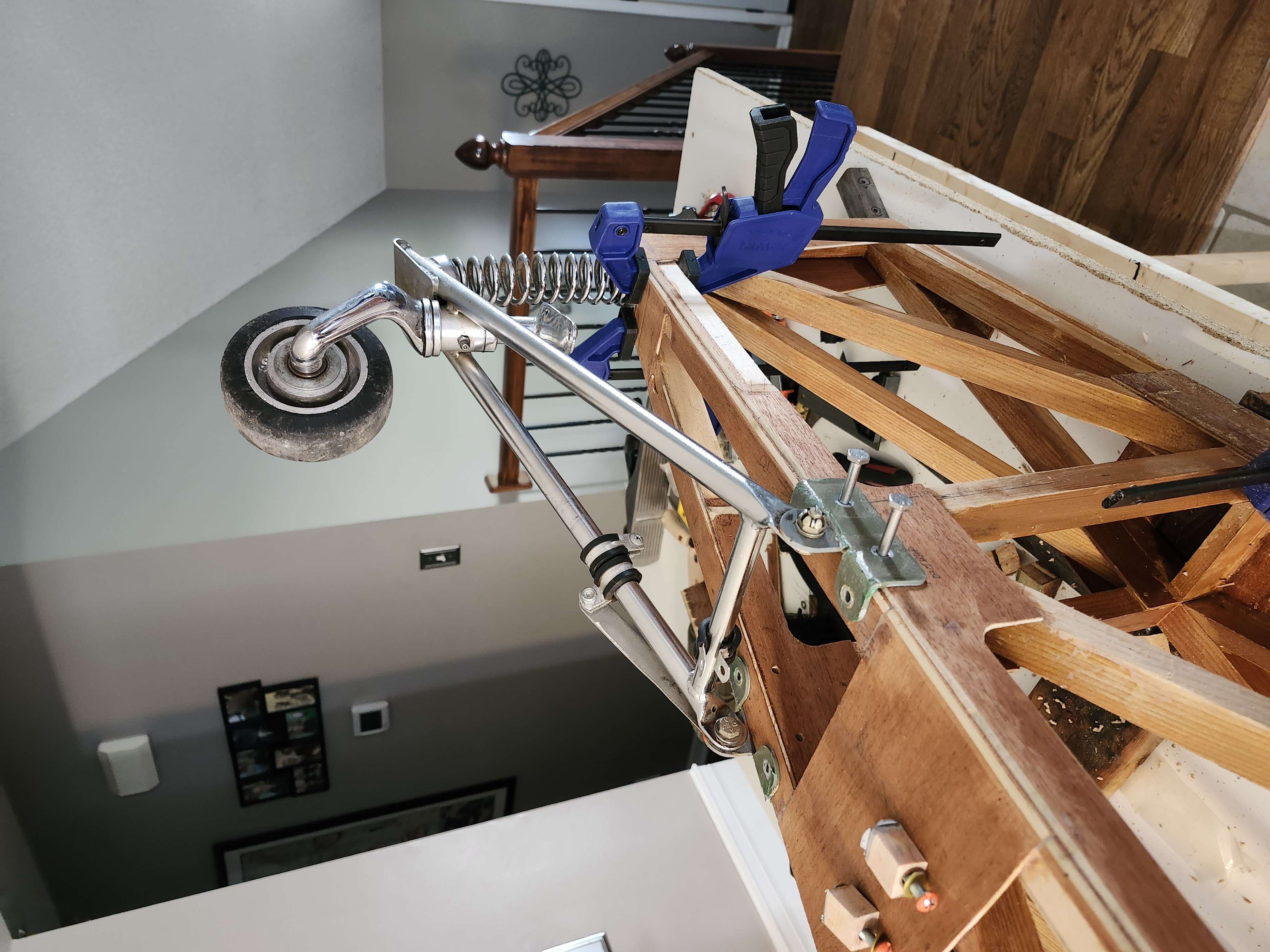

Re: N34KP's rebuild
The holes for the forward tailwheel brackets are drilled.

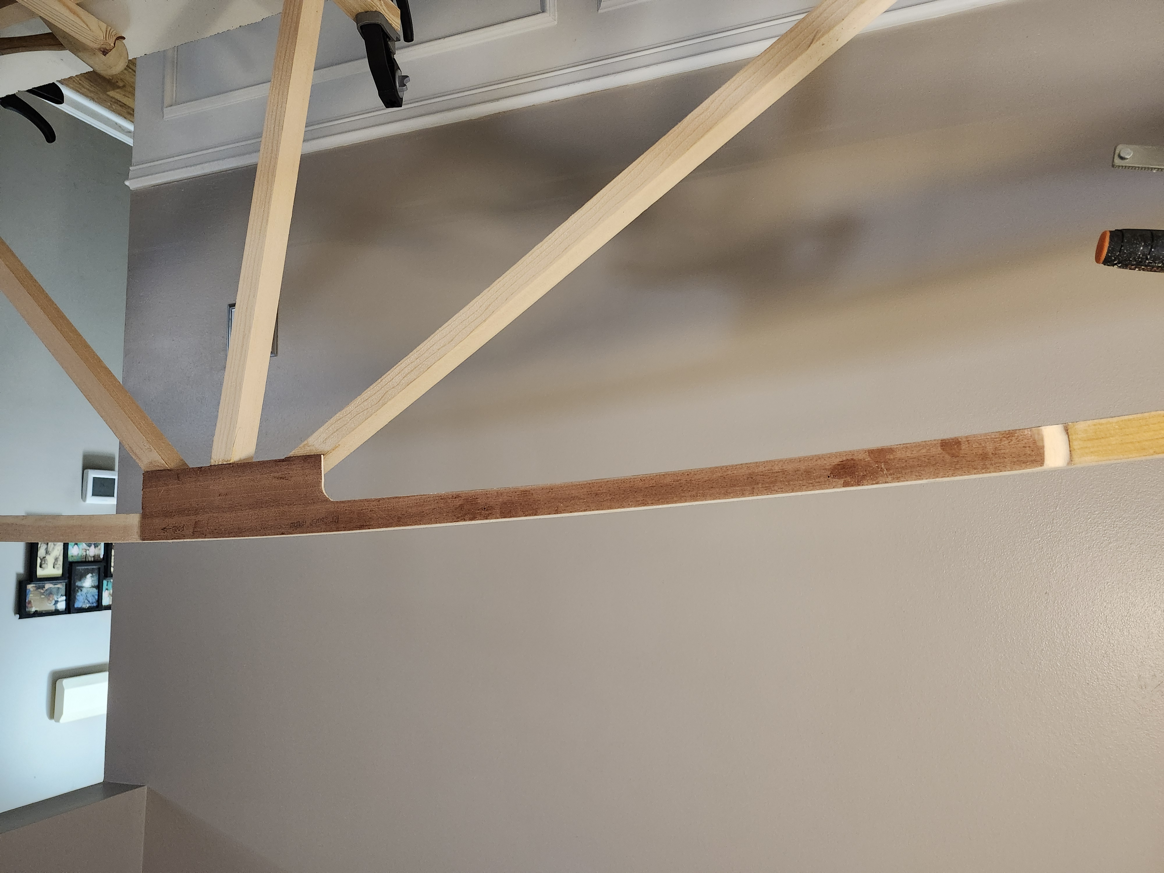

Re: N34KP's rebuild
The first two splices cut.
Re: N34KP's rebuild
Wish I had thought of that nifty scarfing jig. It's nice when you have the working room for nice jigs and clamps and planes and spokeshaves to work with! It seems like anytime I need to make repairs to something, I have to work with small tools and work by eyeball in very tight spaces.

Re: N34KP's rebuild
What did you use to get rid of the biggest part of the scarf?
- Posts: 372
Re: N34KP's rebuild

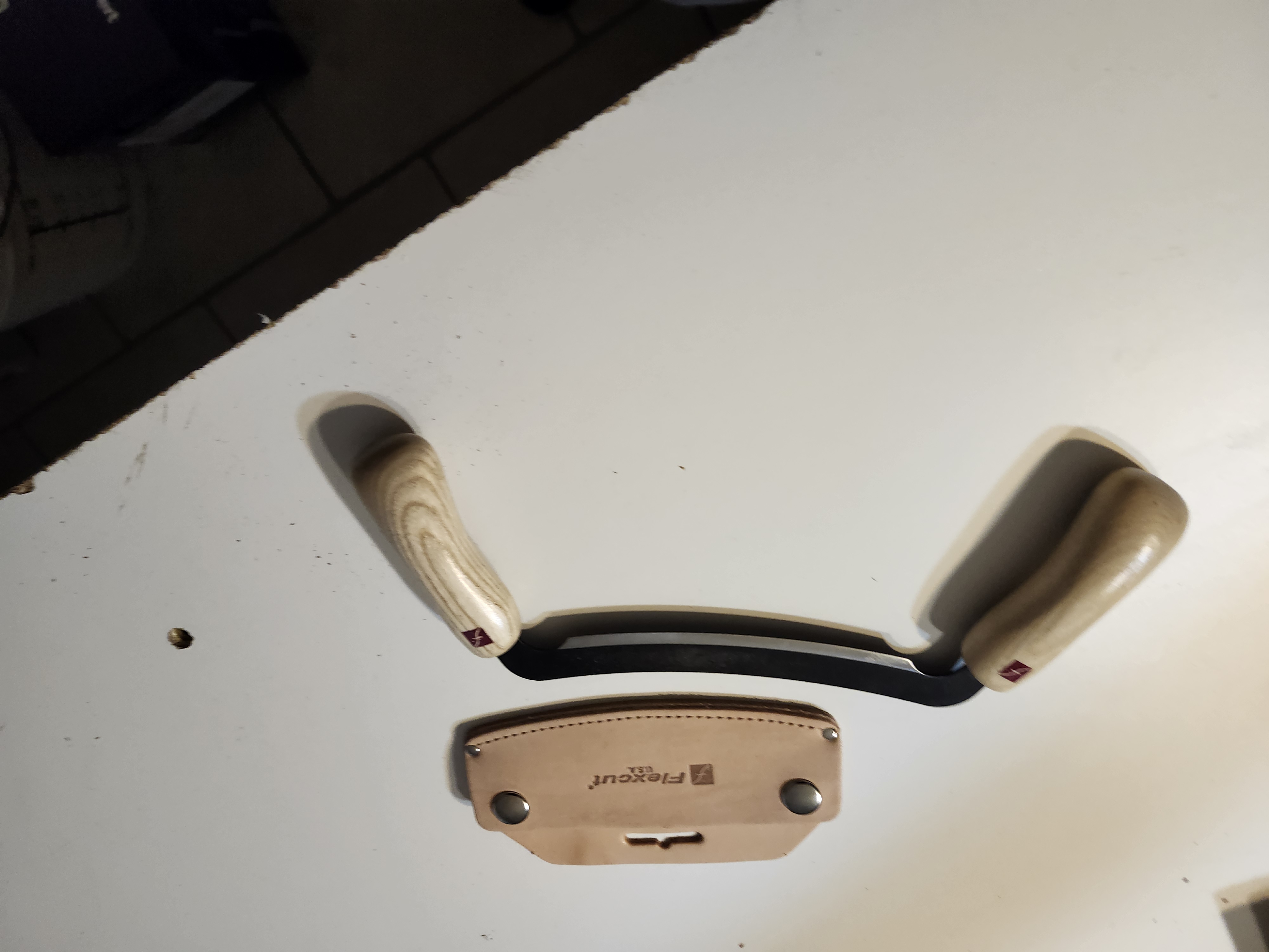

On my first try, back on one of the tail longerons, I tried a saws all and chisels. It was practically uncontrollable. Vibration and catching the wood it jumped all over the place.
Now I use a small draw knife I bought at Rocklers. It takes 3 to 5 minutes to cut down to just shy of the guide, then I finish with a block plane.

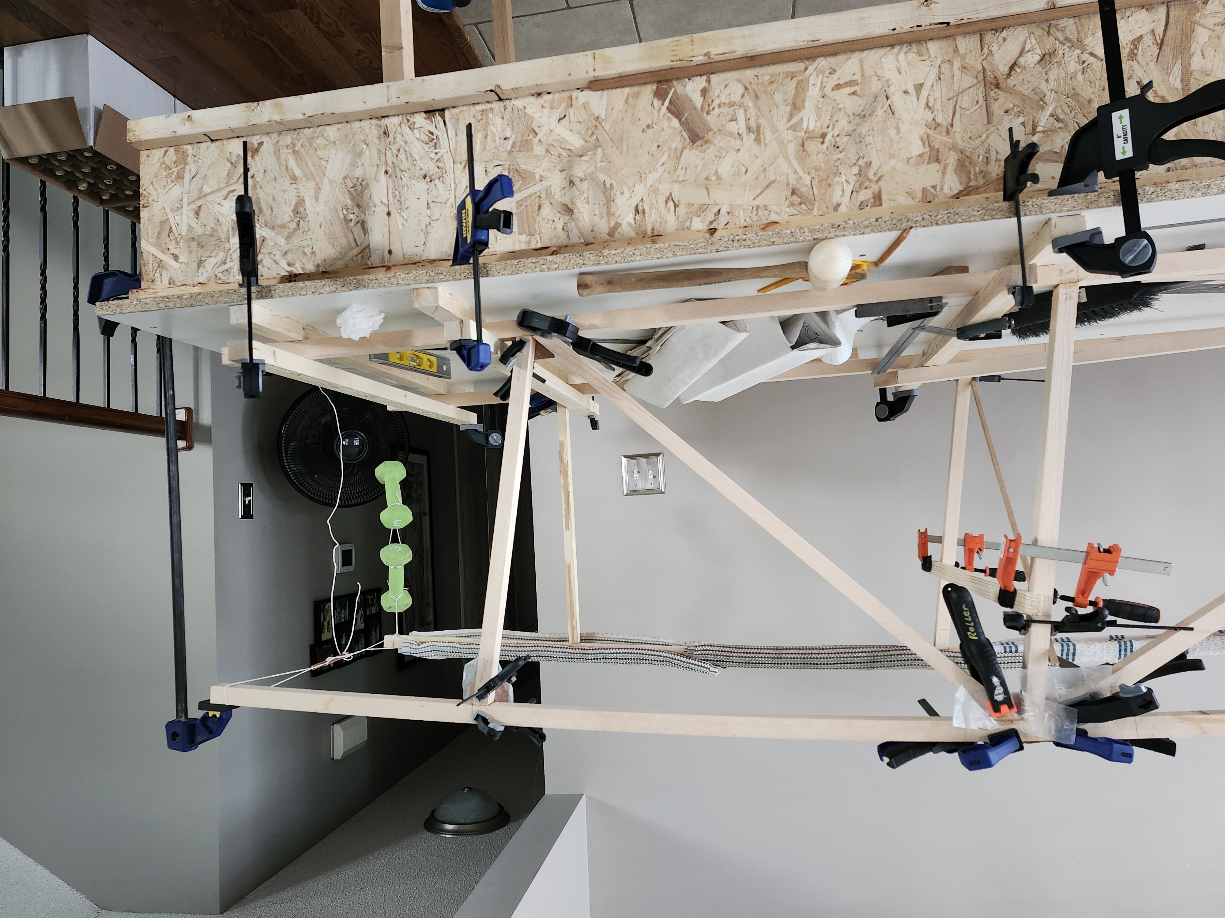

It's been a while since I could work on the Piet. Yesterday I glued in one piece of the left rear cabane station.

Opposite side gluing

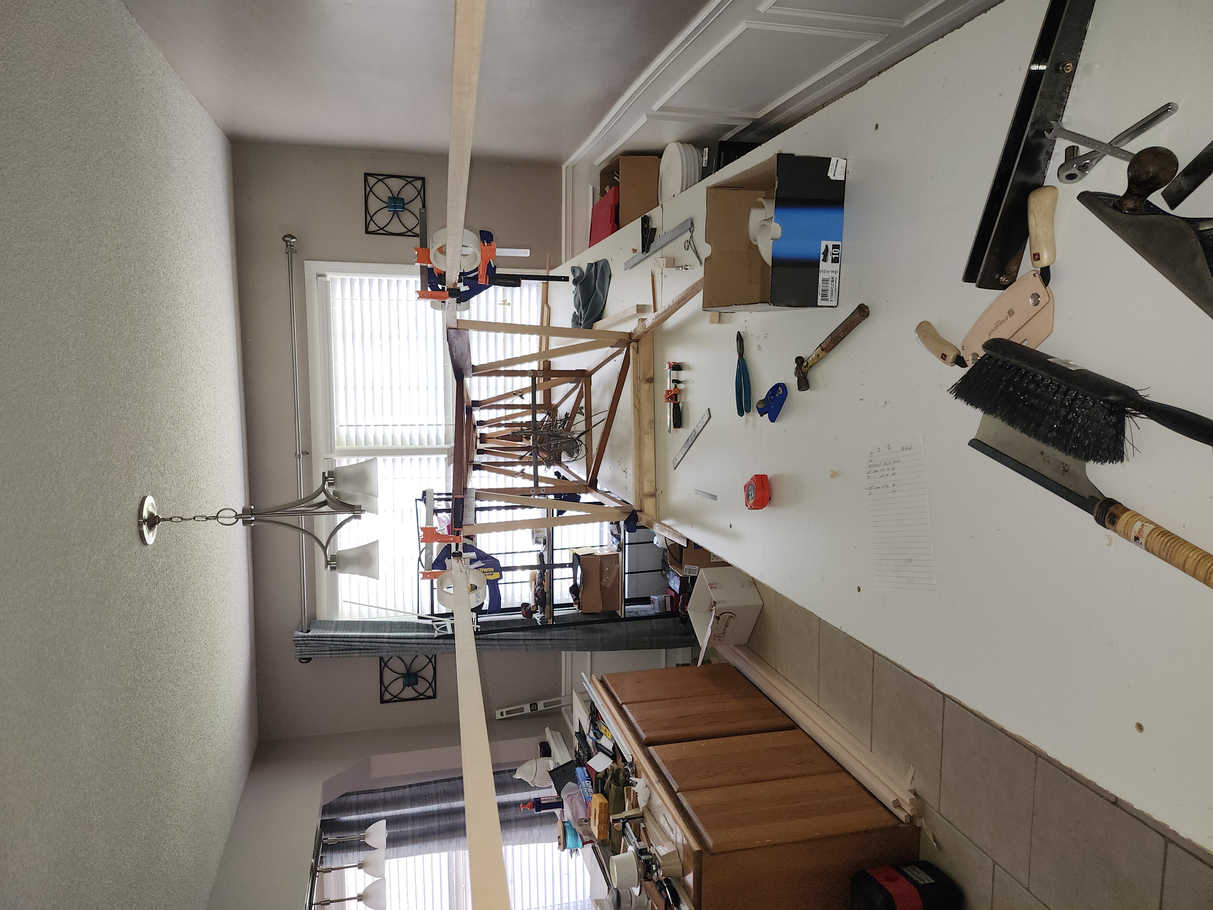

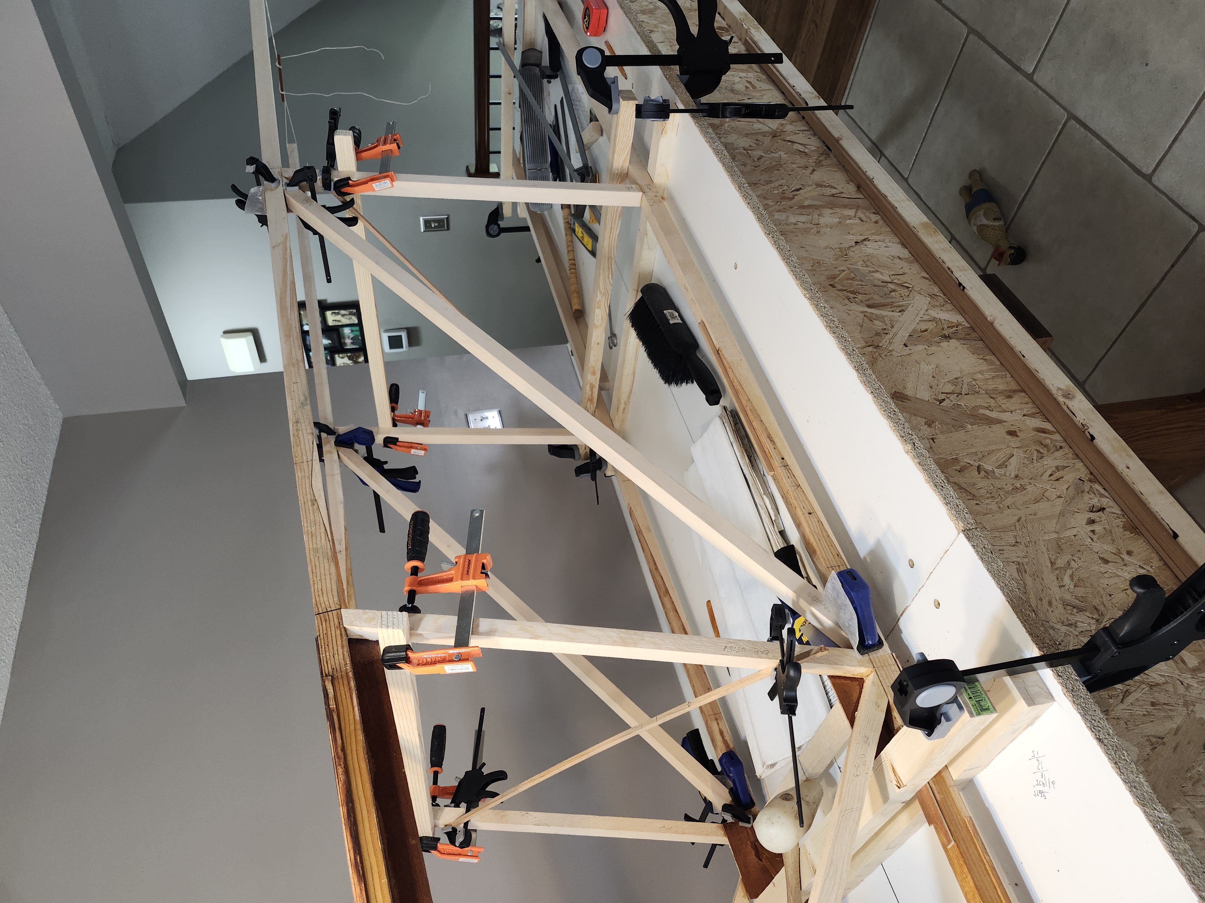

- Posts: 372
Re: N34KP's rebuild
Gluing in diagonals.

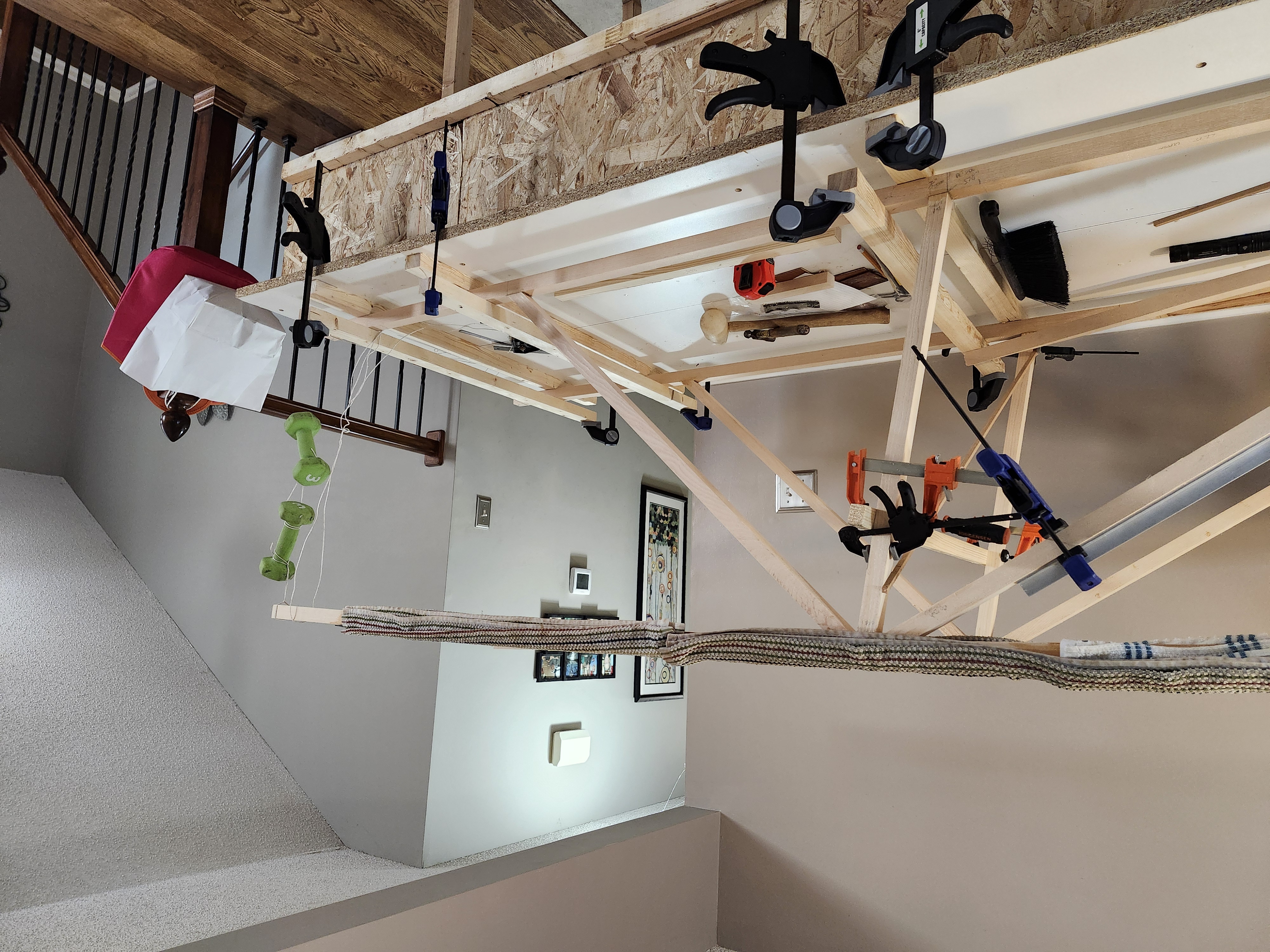

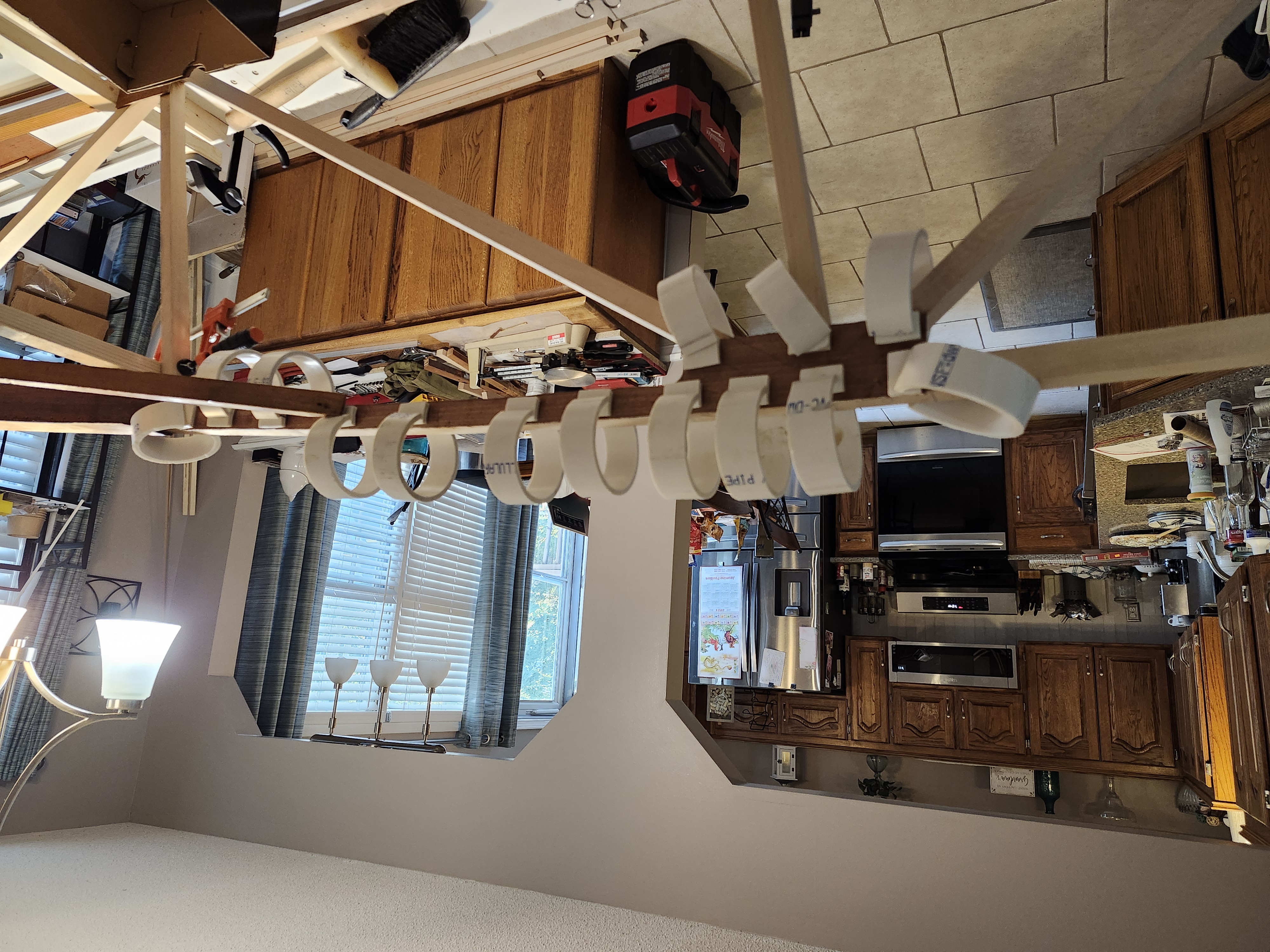

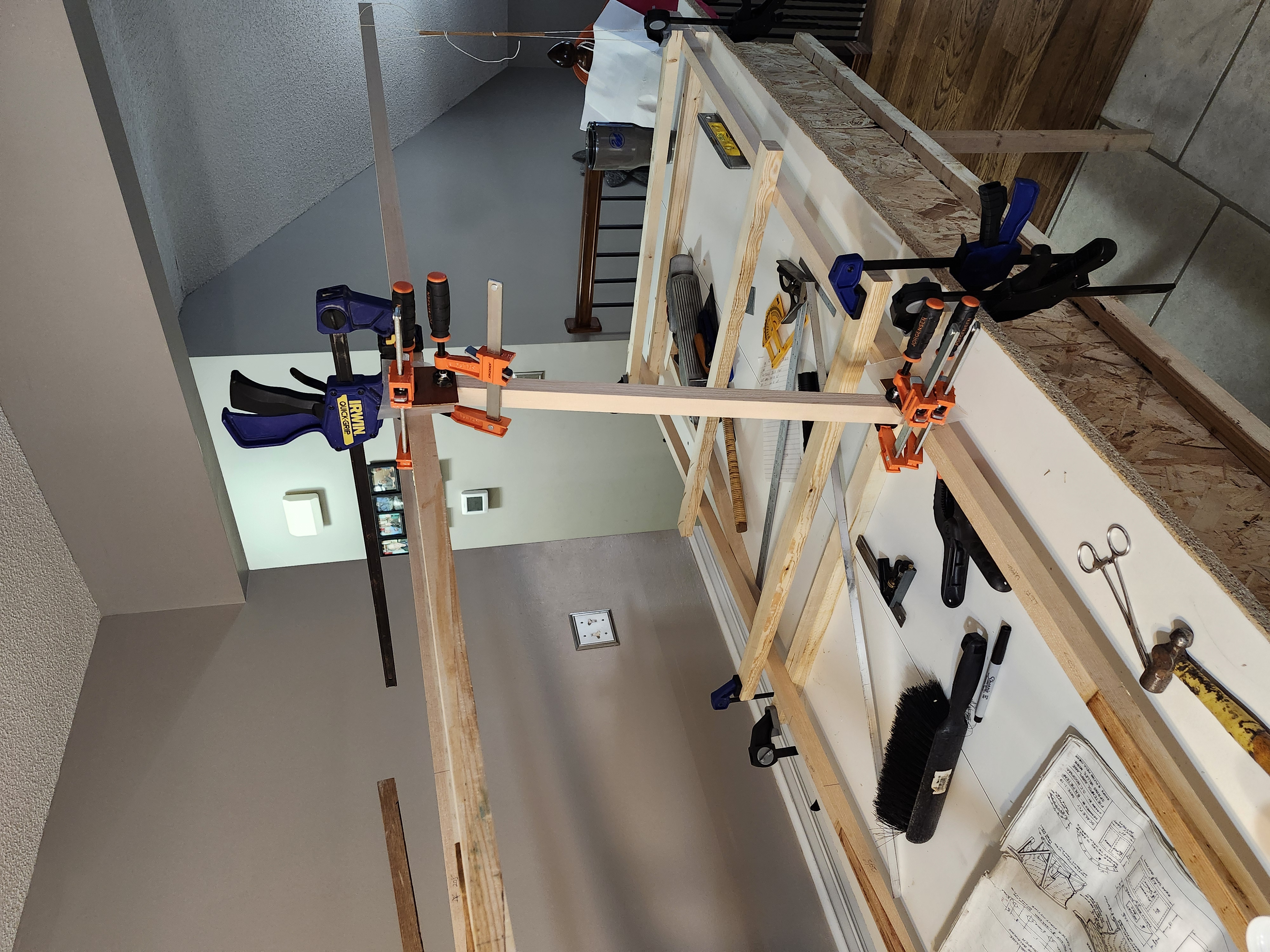

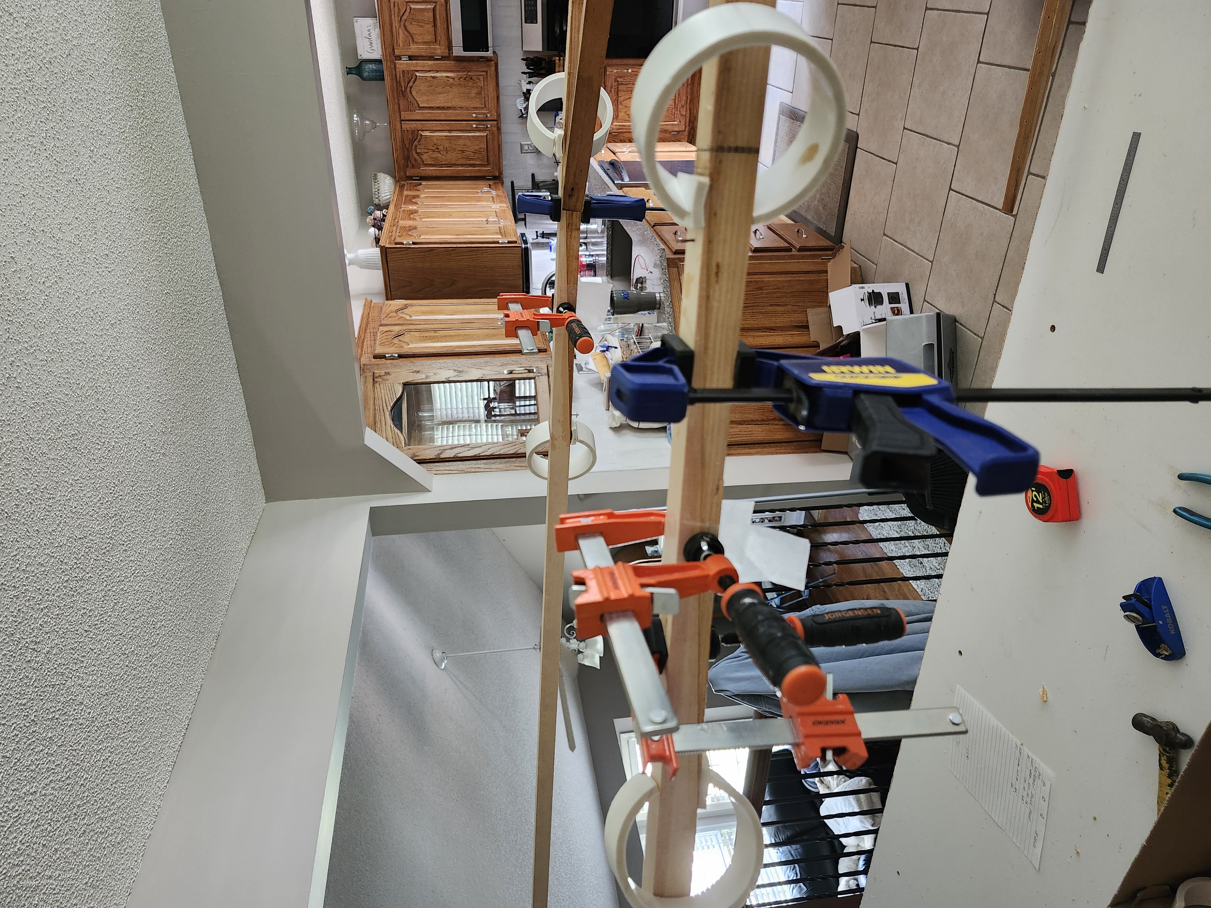

Re: N34KP's rebuild
Bending a longeron. It dropped 2-1/8" at the end overnight. 6 lbs of weight hanging on the end.

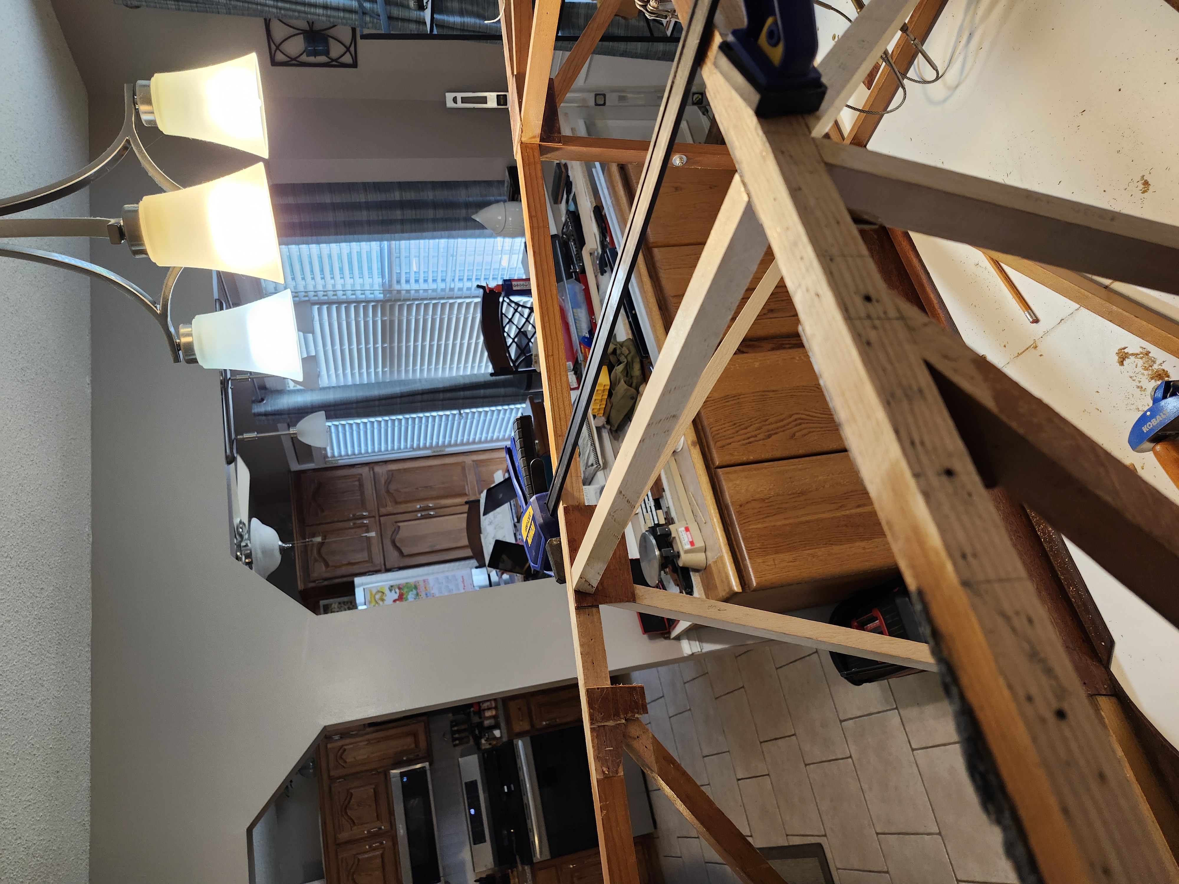

Re: N34KP's rebuild

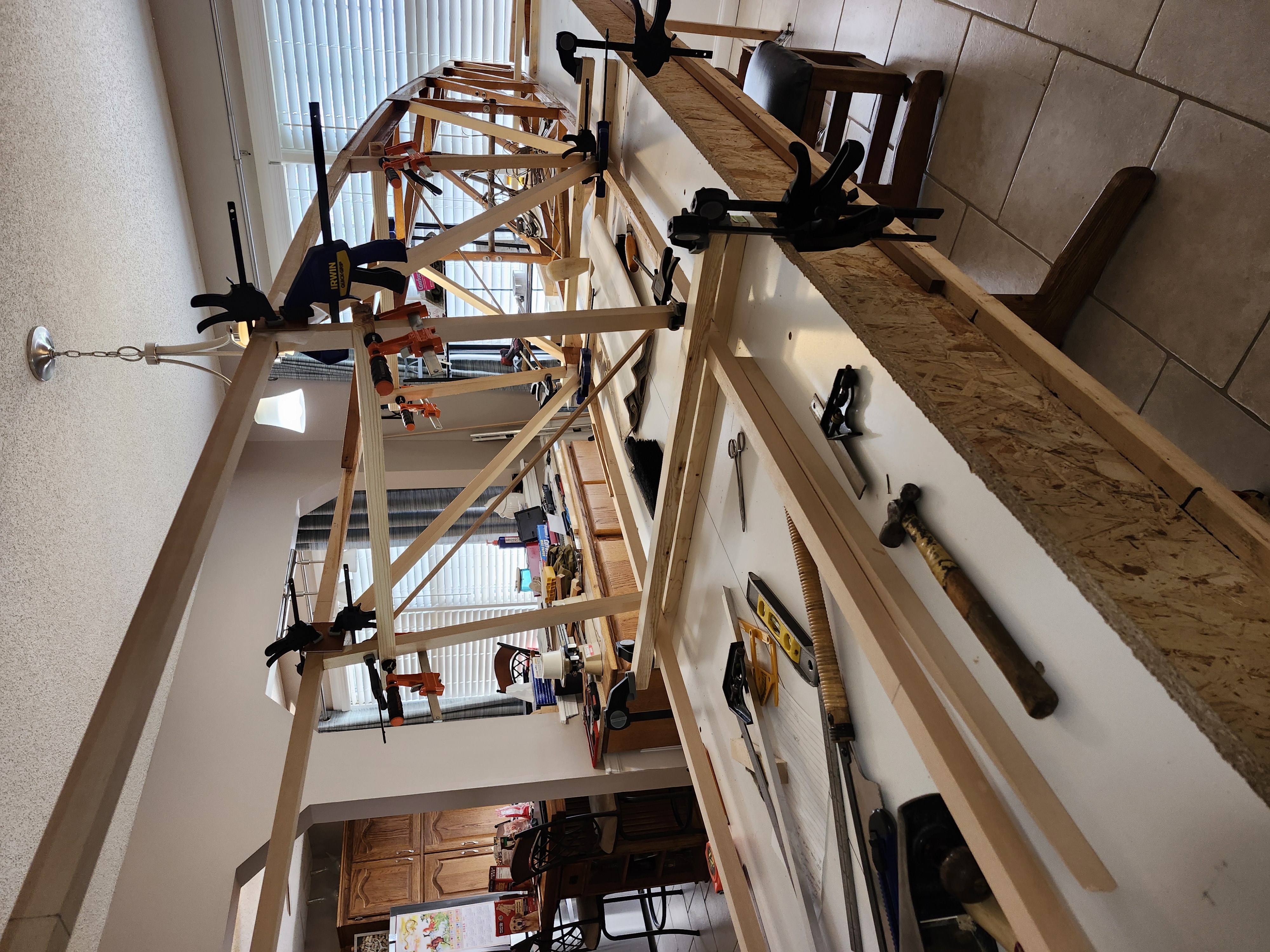

Up to the firewall on the left side.

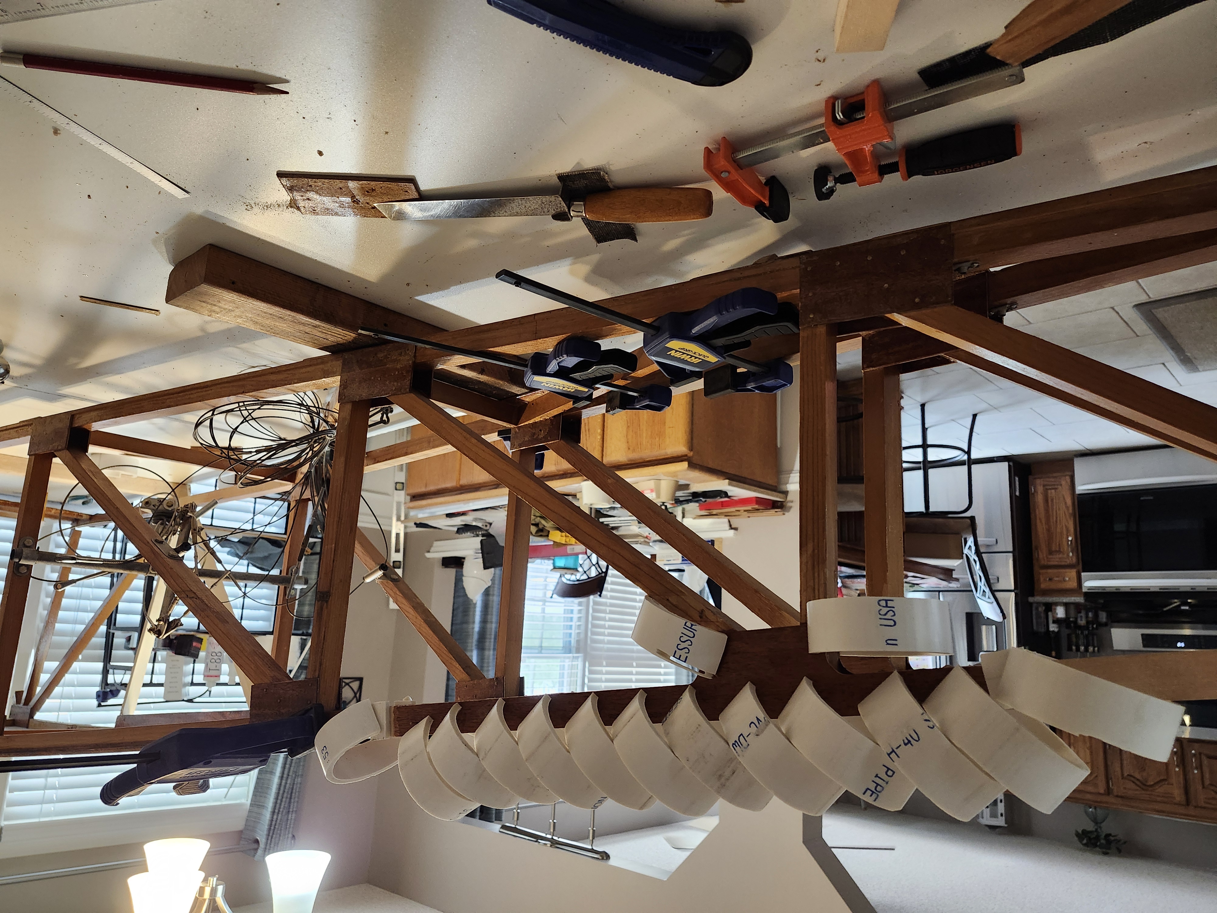

Re: N34KP's rebuild

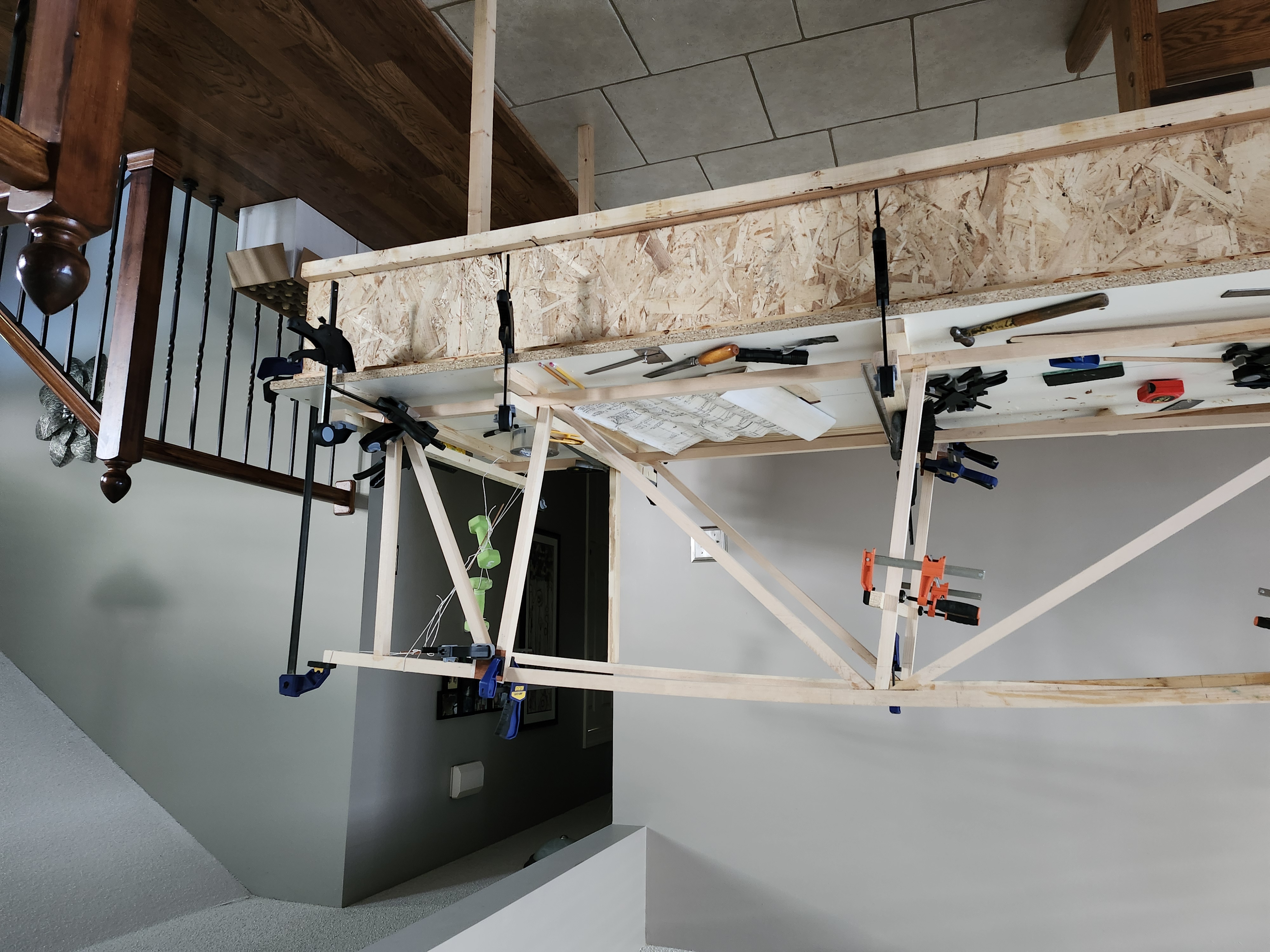

The side trusses are done. Time for inside gussets and station cross pieces.

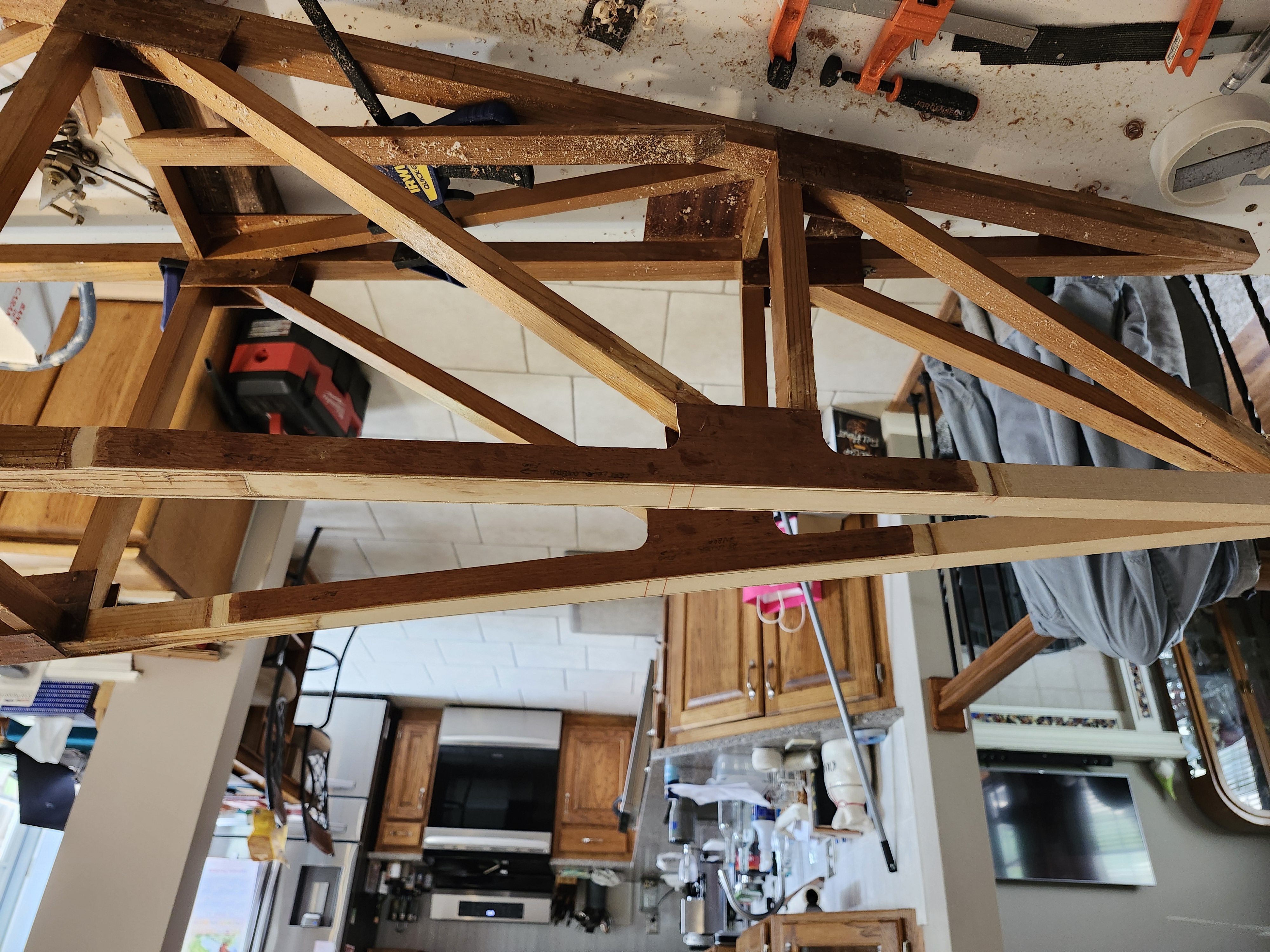

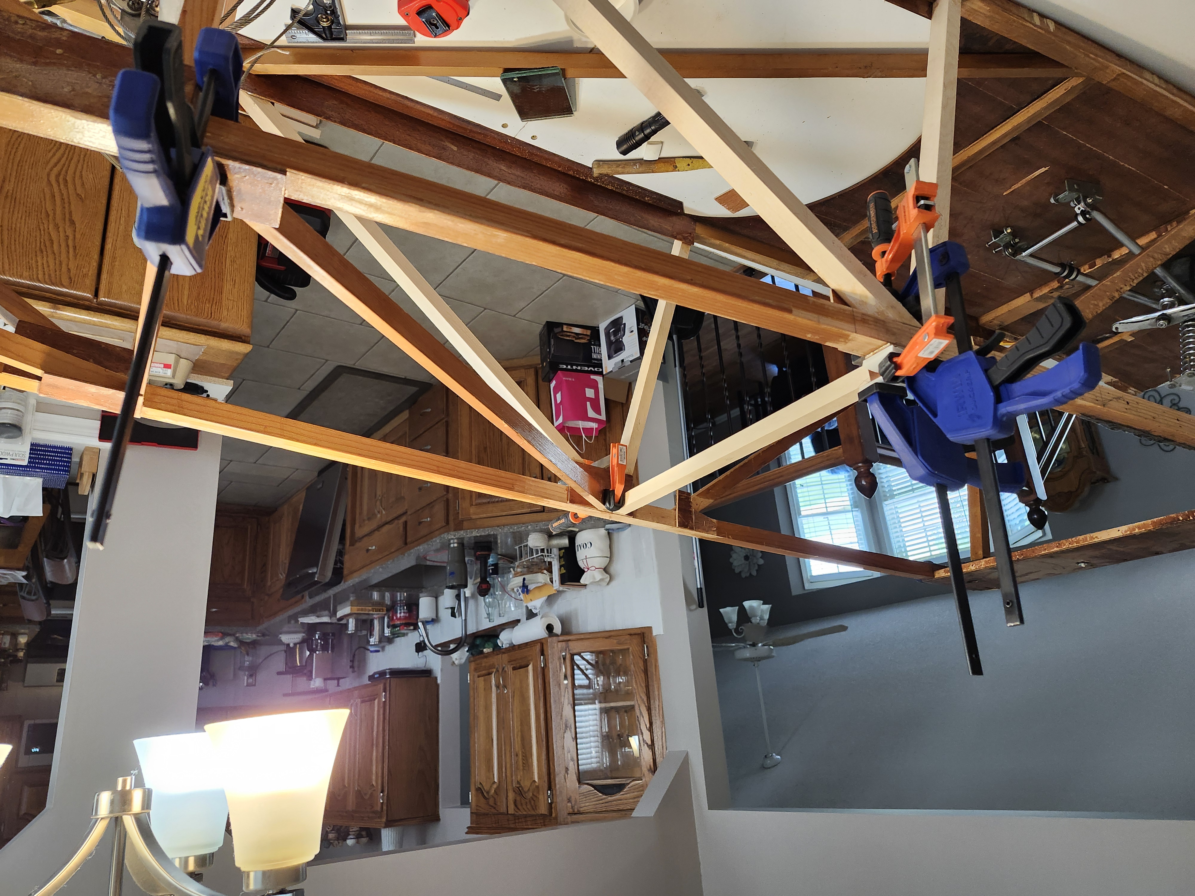

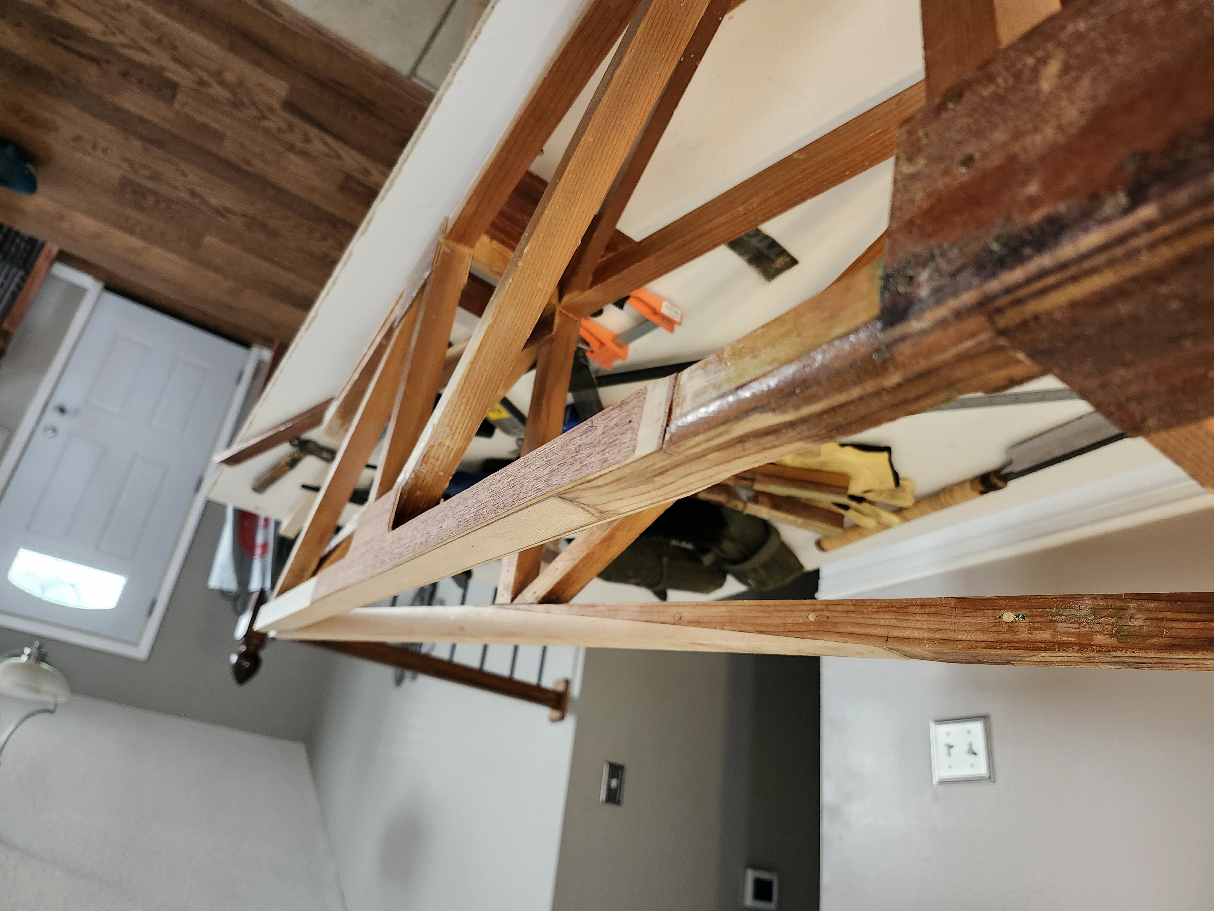

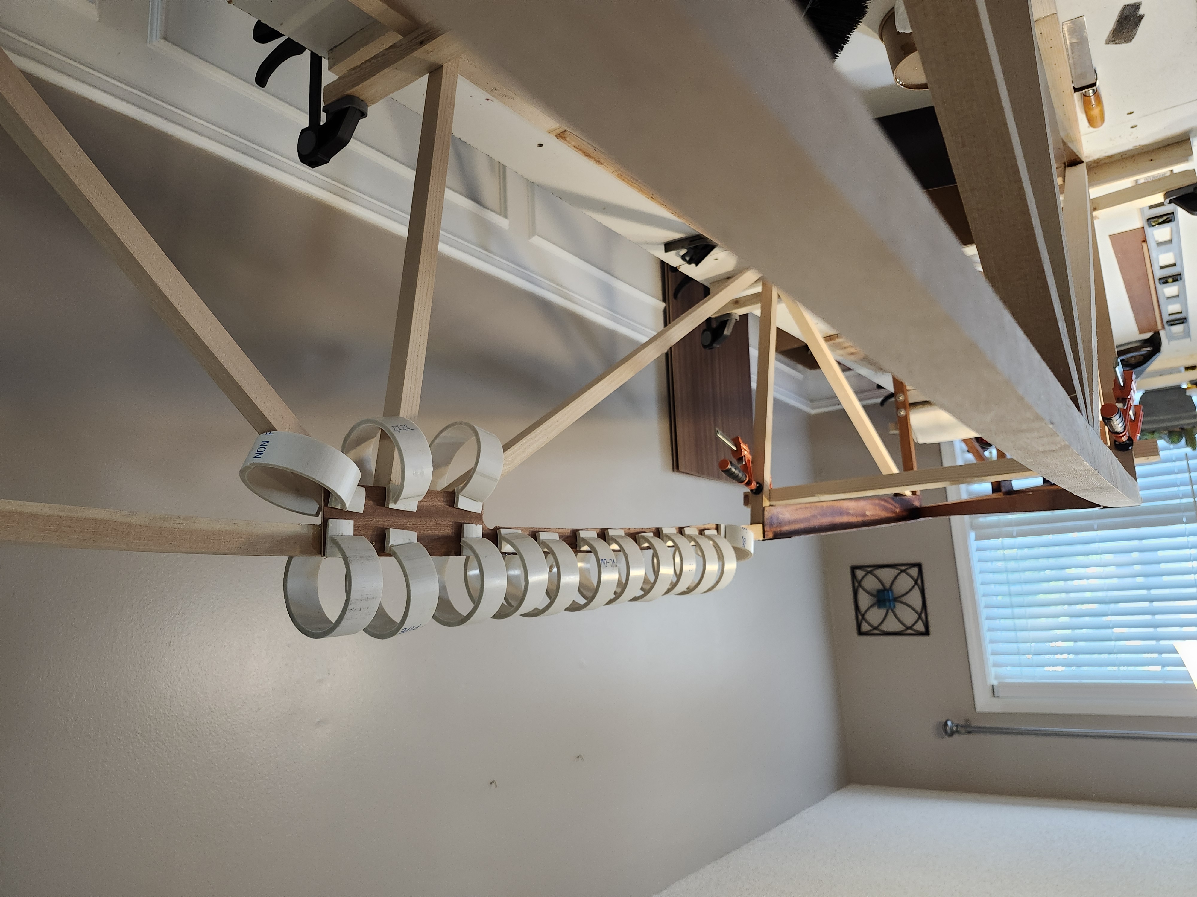

Re: N34KP's rebuild

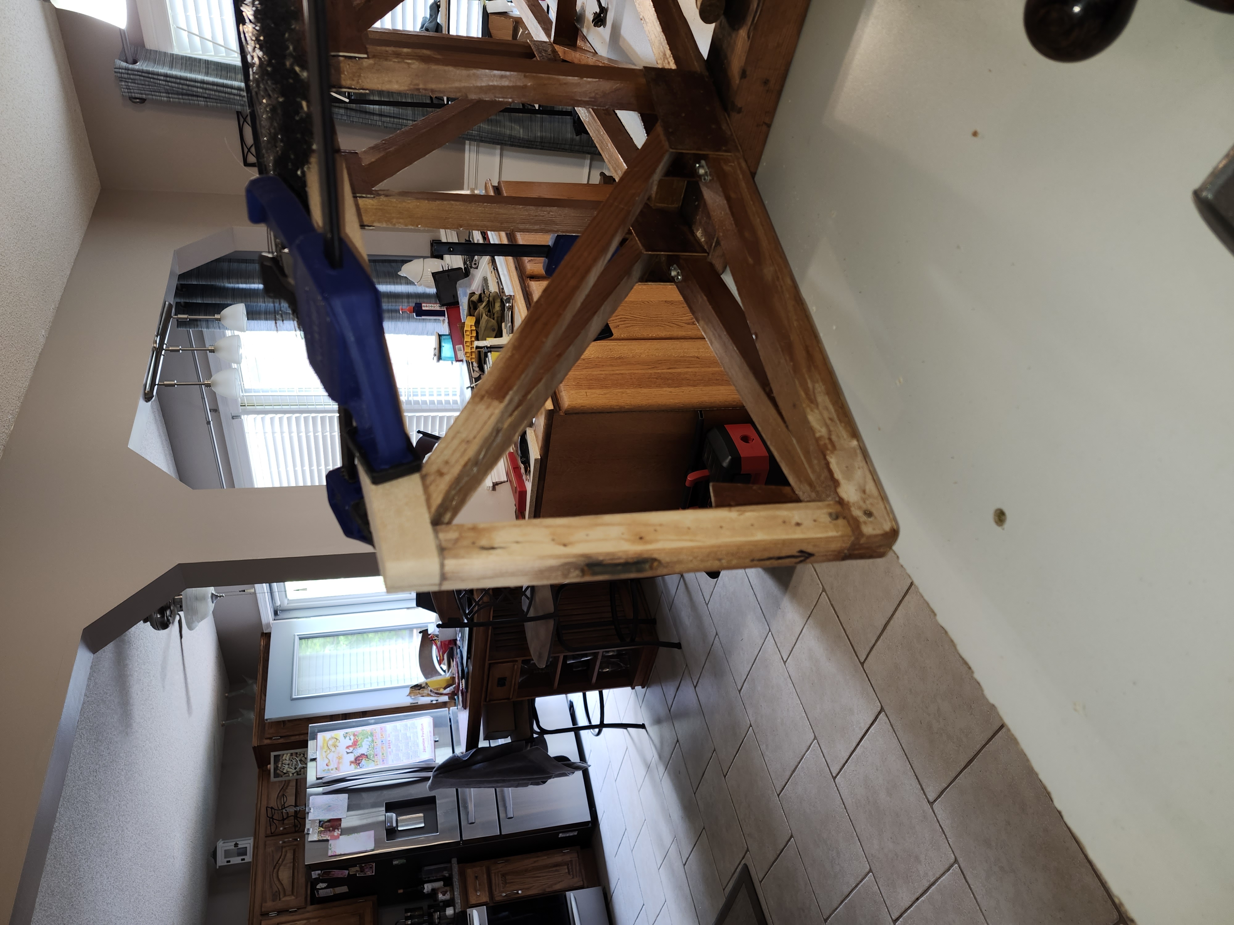

I hadn't worked on the Piet since the third week of June, due to my wife's memorial and my general lack of desire to do anything. But today I started cutting inside gussets. The one shown, inside lower right, has a long one. The gussets for the longeron splice and the station came so close together I decided to combine then. It'll be the same way on the opposite lower longeron.
- Posts: 372
Re: N34KP's rebuild
After the clamps and final shaping.

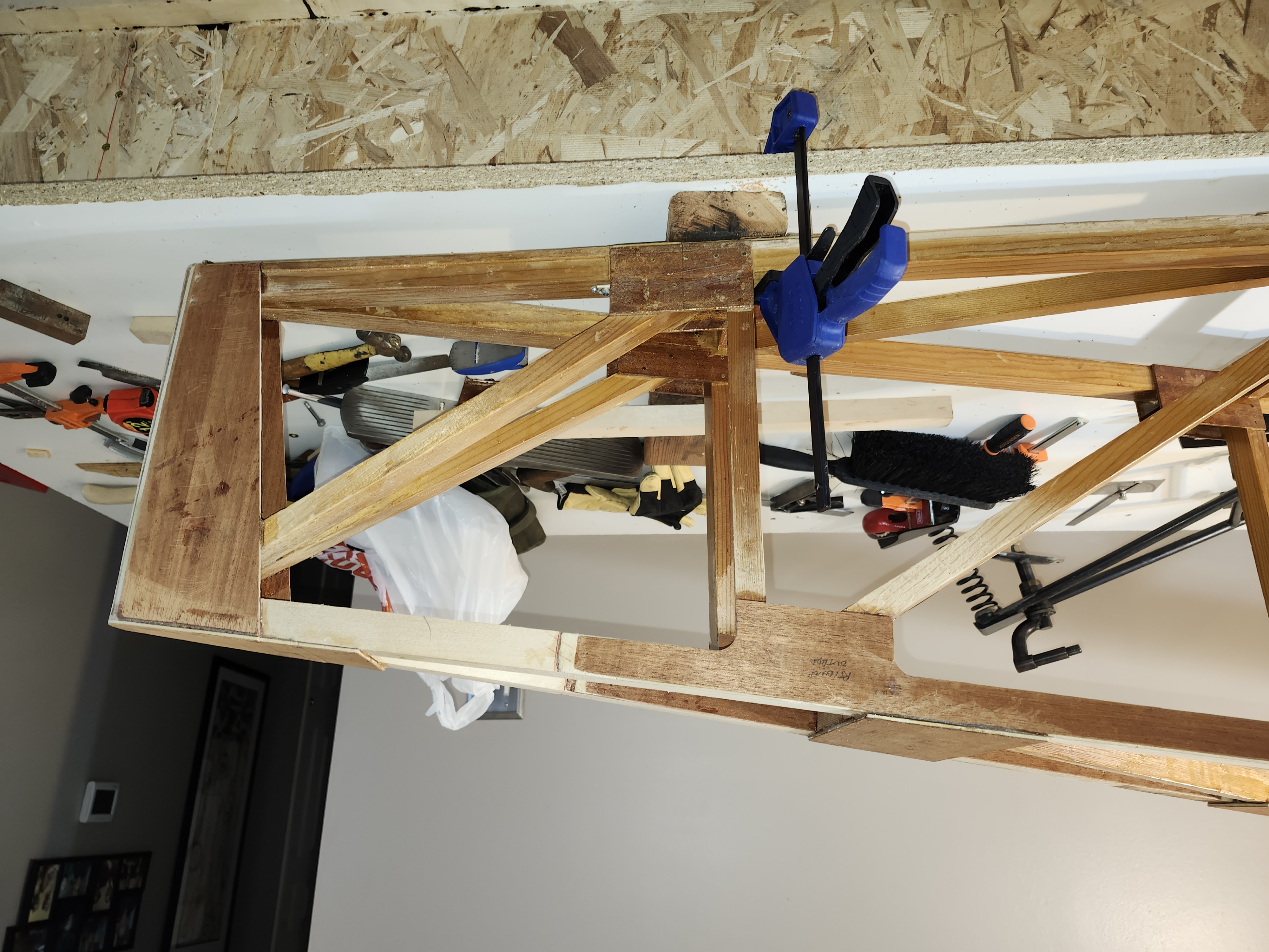

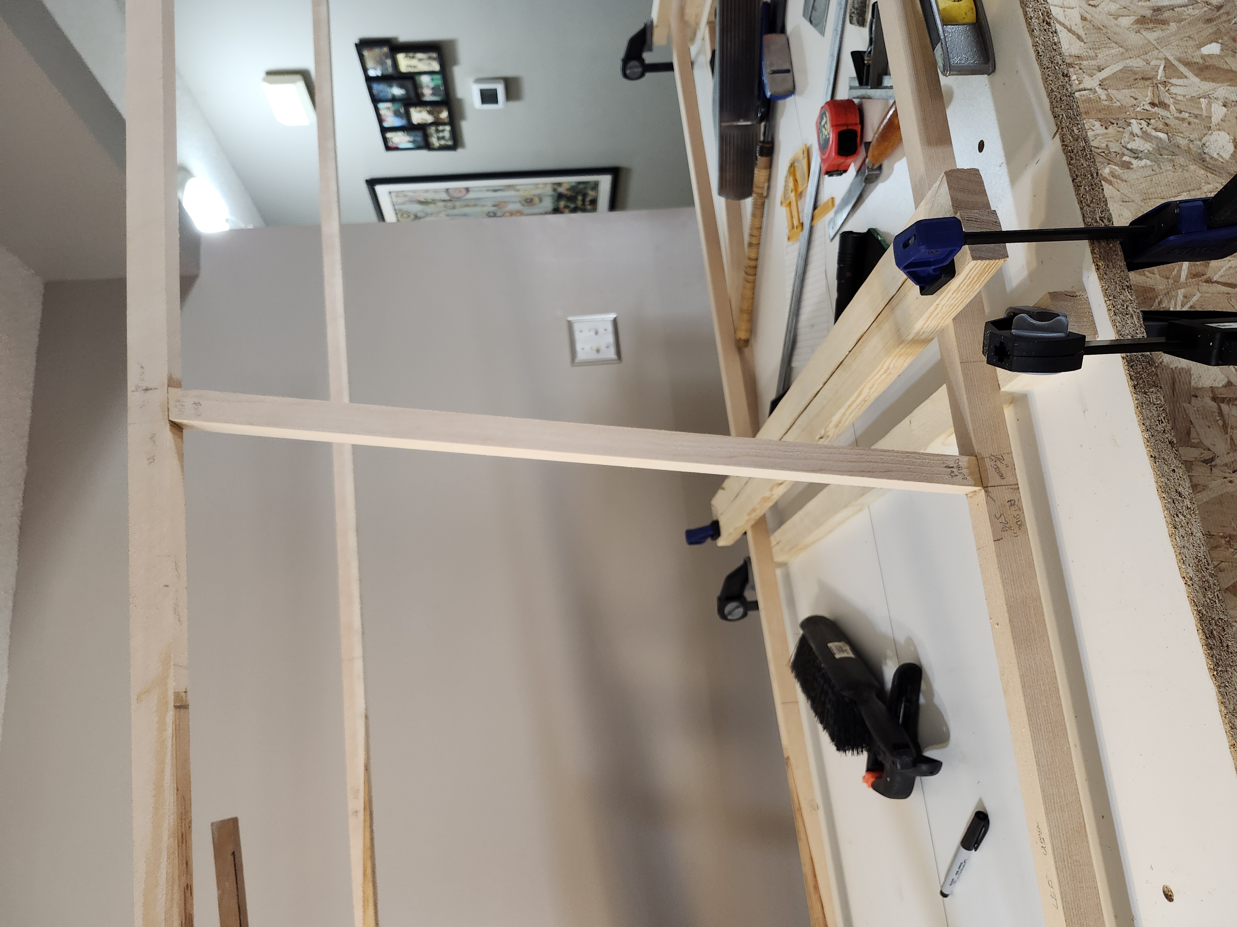

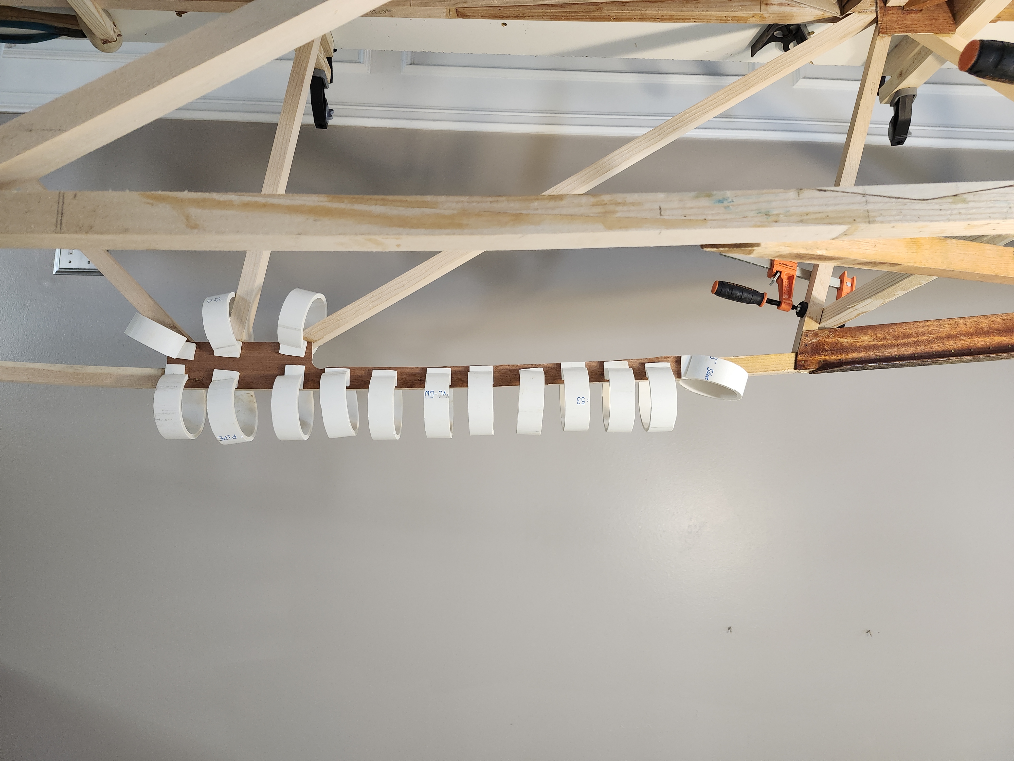

Re: N34KP's rebuild
Left lower longeron splice and station.

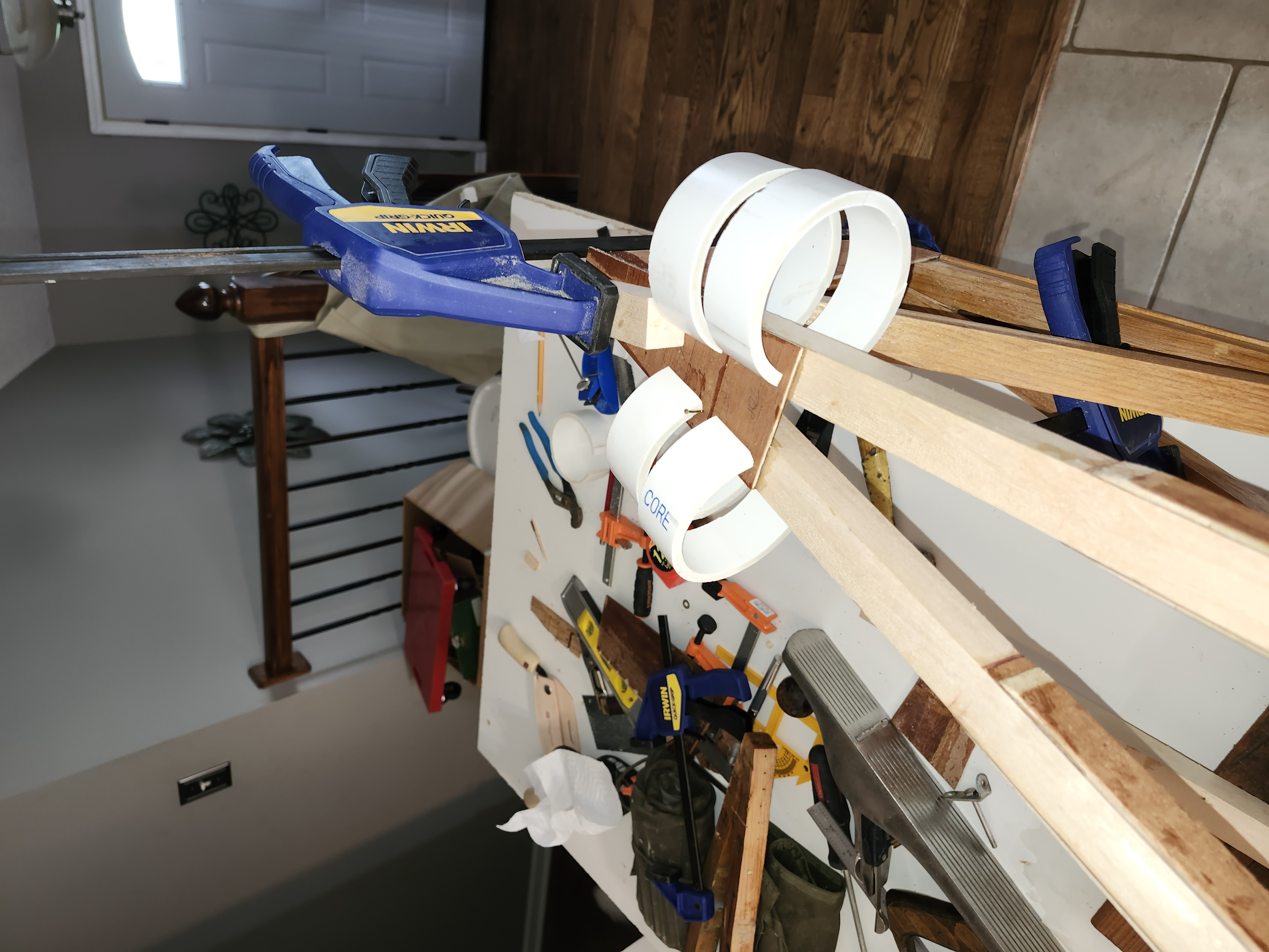

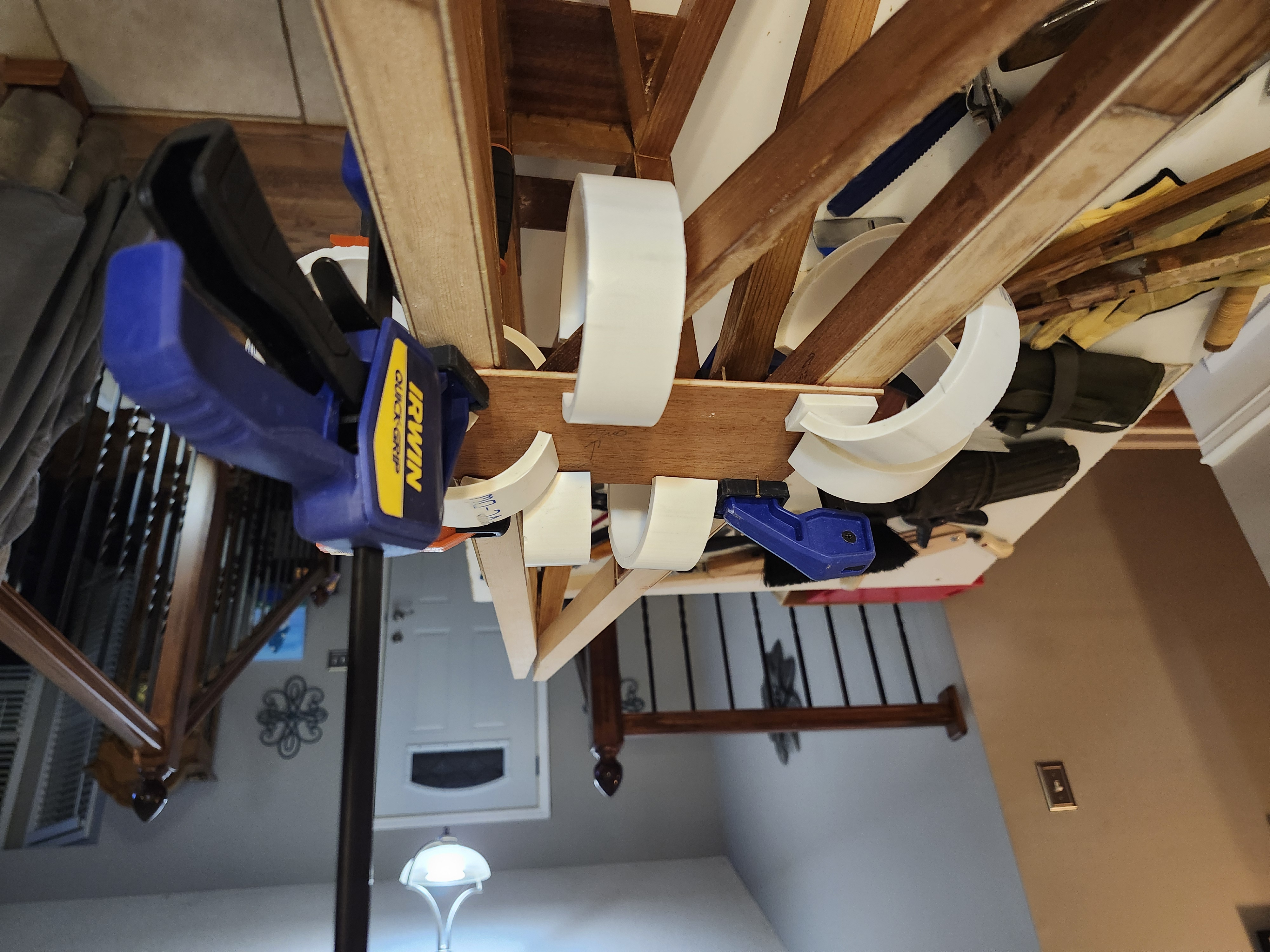

Lots of family crap going on, getting in the way of Piet rebuild time

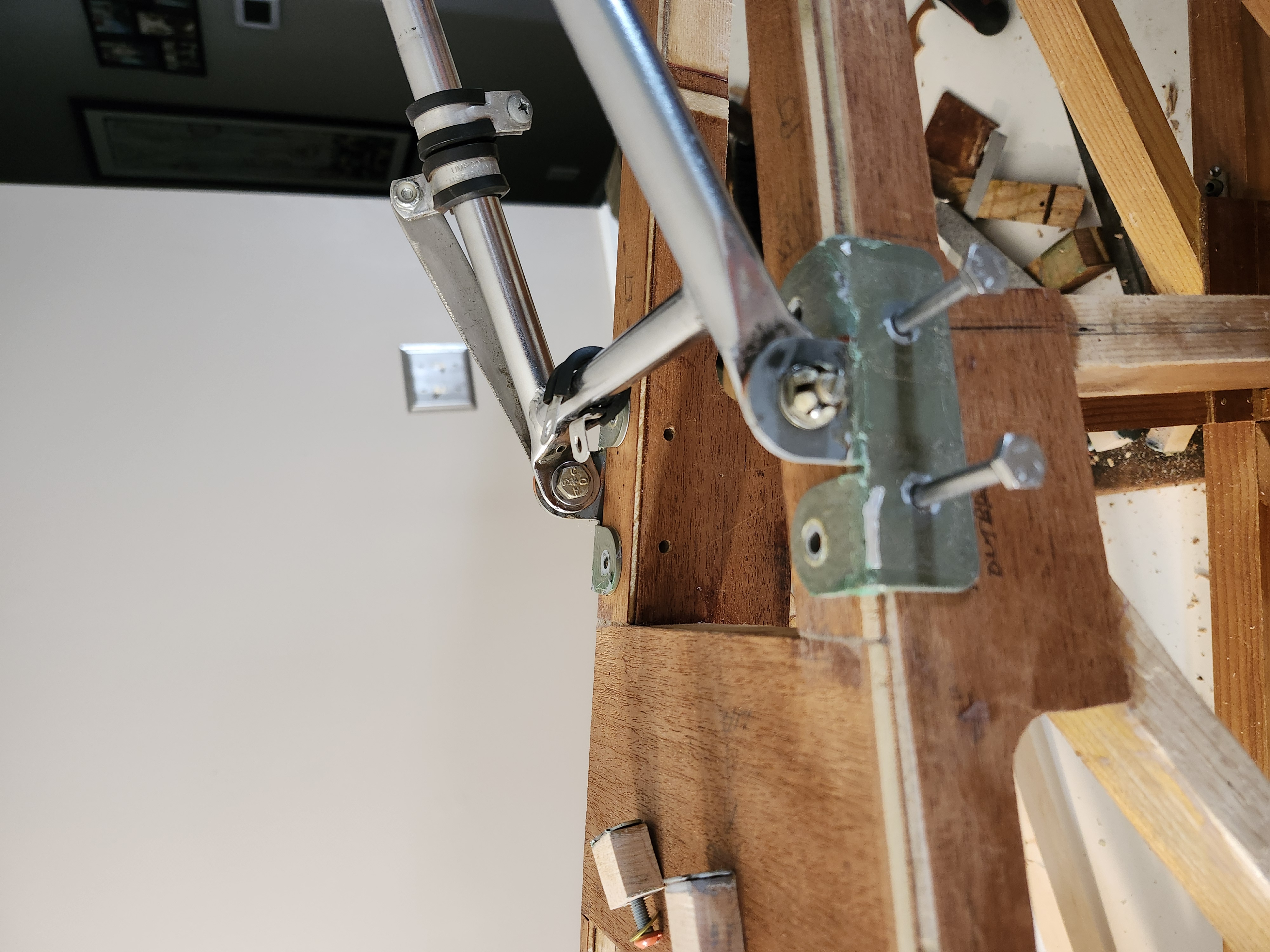

I have managed to get some of the blocking for the landing gear/lift strut fittings started.

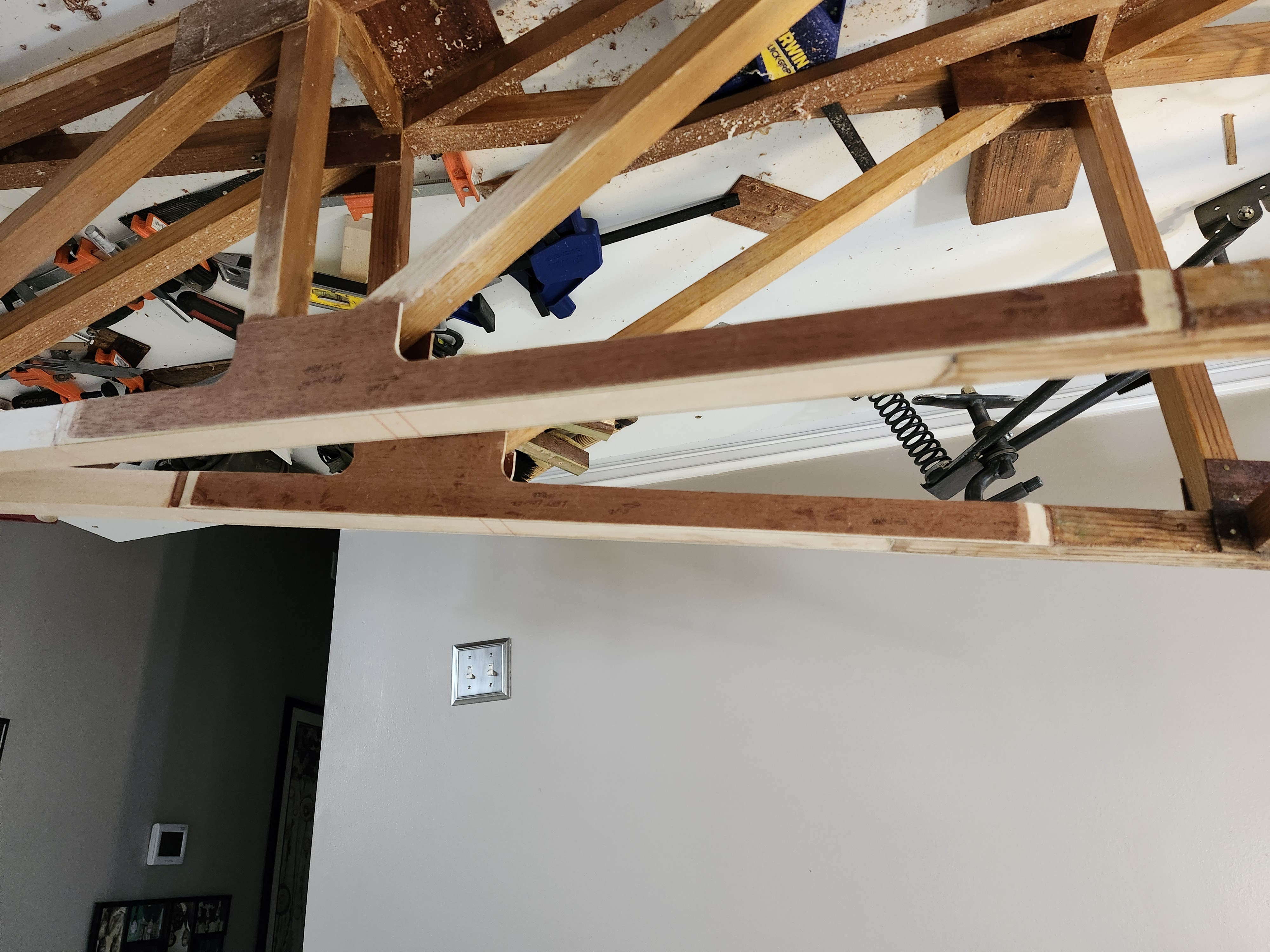

I was out at the hanger taking some measurements on the wing. I found something interesting. When Ken built the wing, he did the compression struts in the middle of the wing different. Instead of offsetting the struts with the 1/4" plywood to clear the bottom of the wing fabric, he cut a curve, like the lower center section pieces, flipped the cut out piece over and glued it to the top of the strut.
Re: N34KP's rebuild
And yet another example of how the simple things are often the most elegant. Very nice detail.
