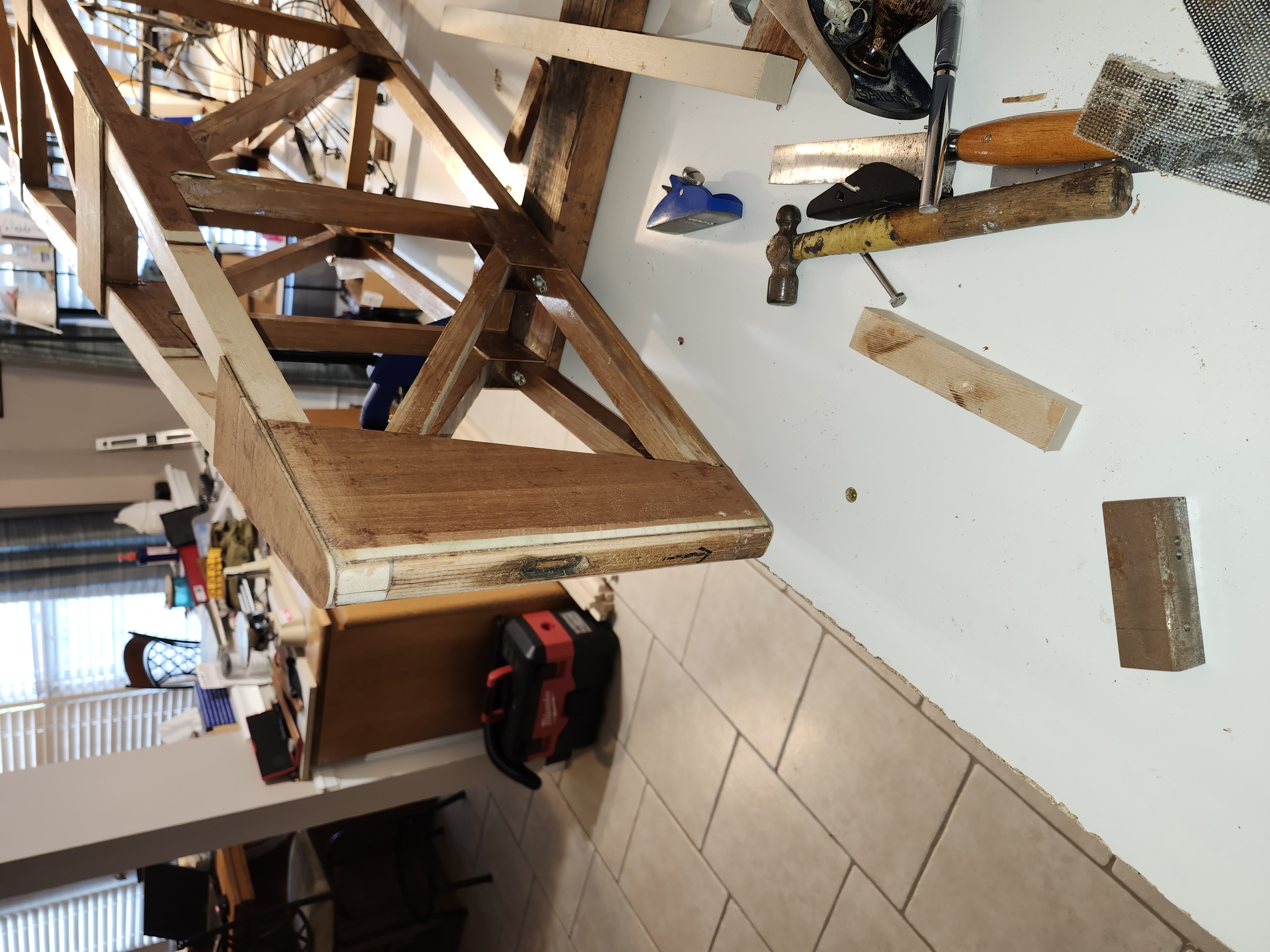

Back from visiting my sisters and mother. I planed the doublers on the lower right longeron this morning. Time to glue up the lower left.
- Posts: 266
Re: N34KP's rebuild
Glued up the lower left longeron doublers today.

The rear splices are complete. Station piece and pulling them together at the tail post next.

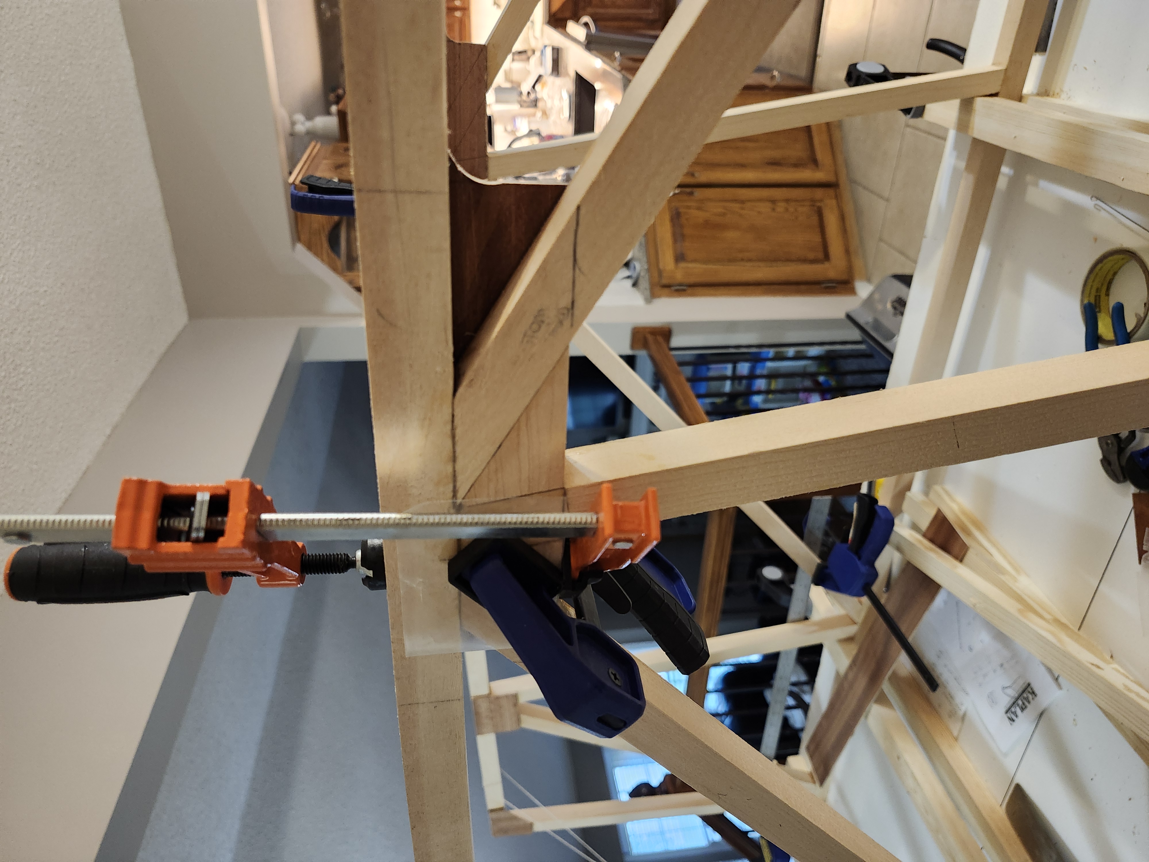

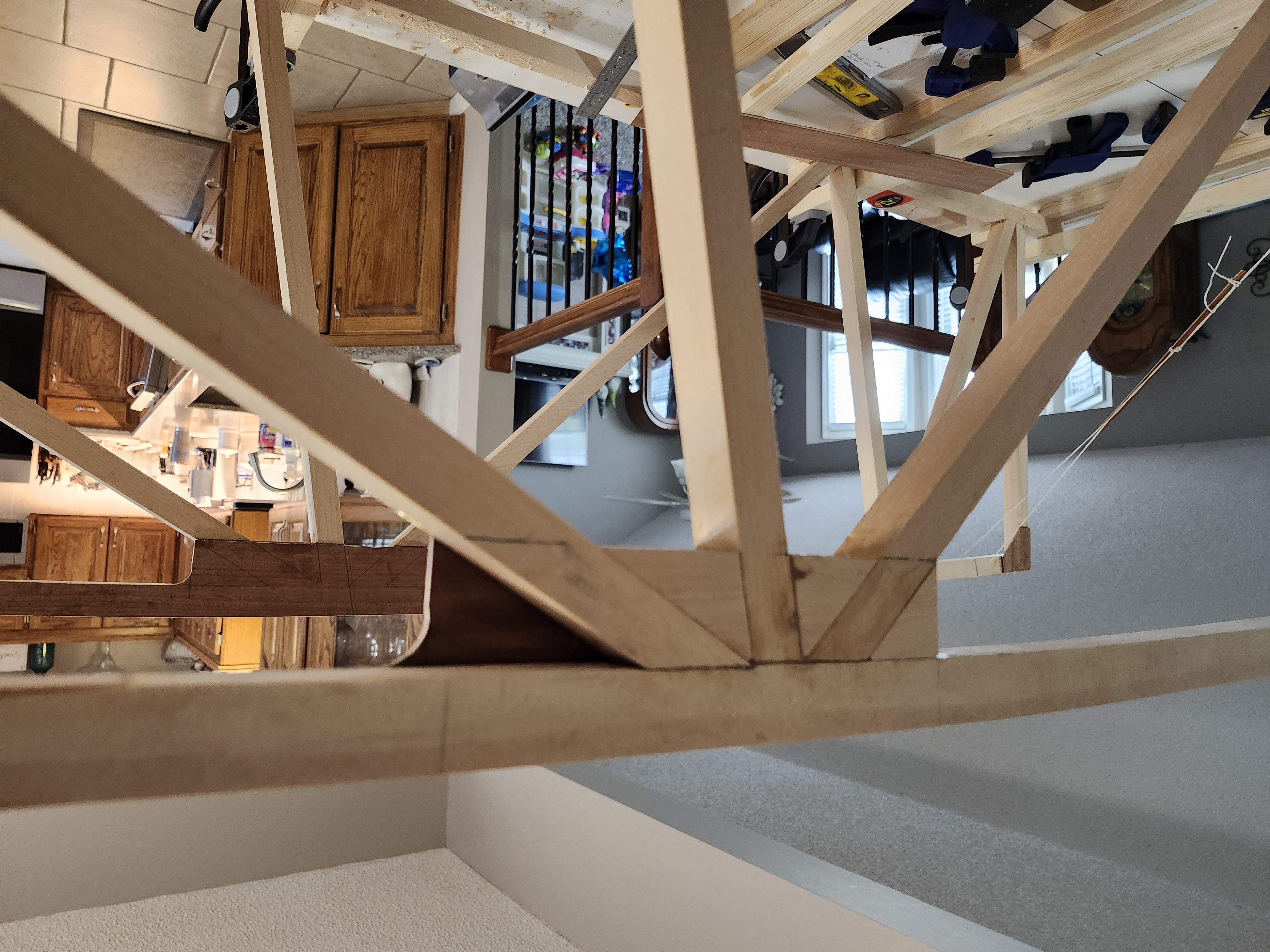

Station piece, diagonal and doublers. Late night glue up.
- Posts: 266
Re: N34KP's rebuild
I glued in the old tailpost last night. Gussets next.

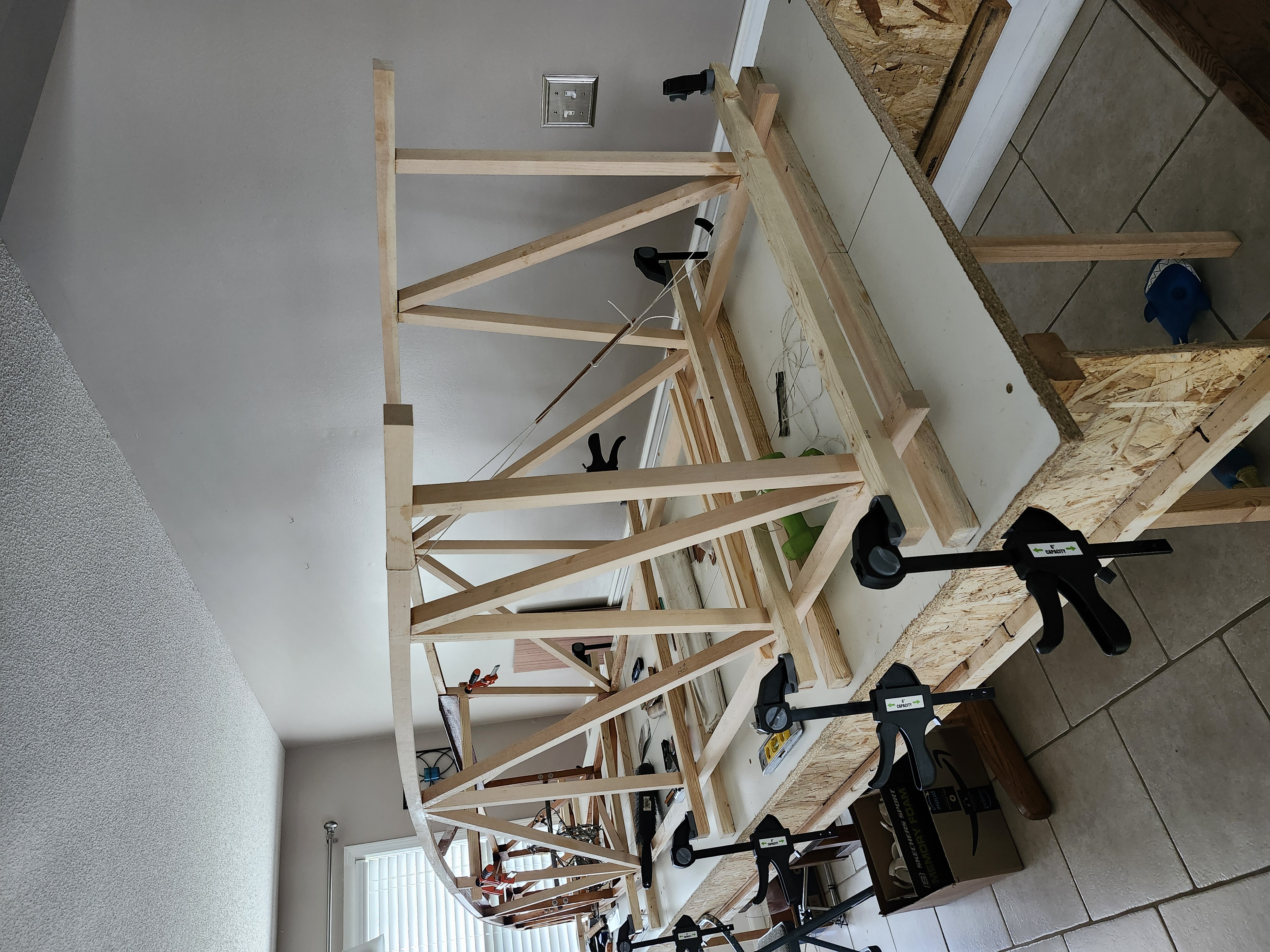

Looks like an airplane, from nose to tail.

The tail reconstruction is finished except for fairing strips and holes for the fittings.

That's gotta be a great feeling, Richard. I know it was a great feeling for me every time I completed a subassembly back when I was making repairs to my Air Camper. Patience and determination will eventually win the day.

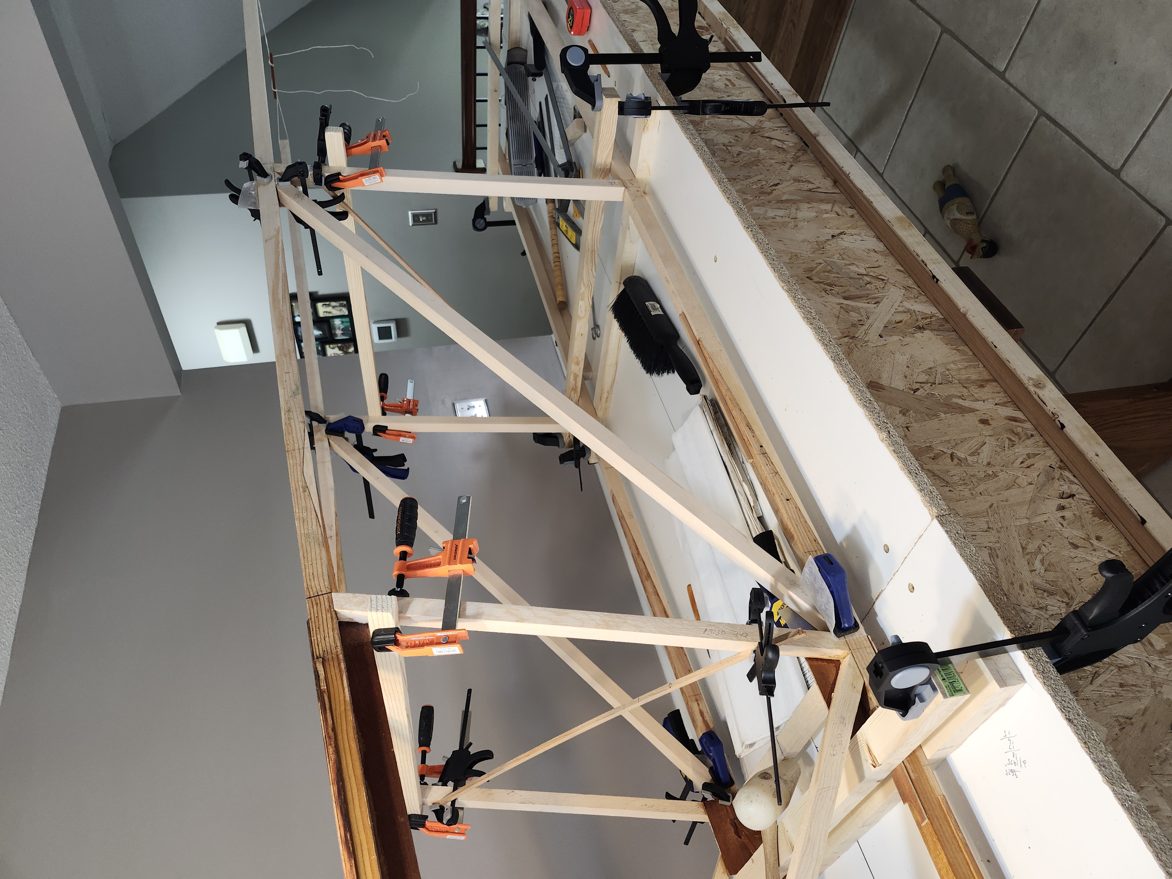

Since I moved the upper seat back aft 3-1/2" I was able to reuse the diagonal brace behind the seat back by re-cutting to the new angles. I still need to install the forward gusset.

One piece at a time.. attaboy!

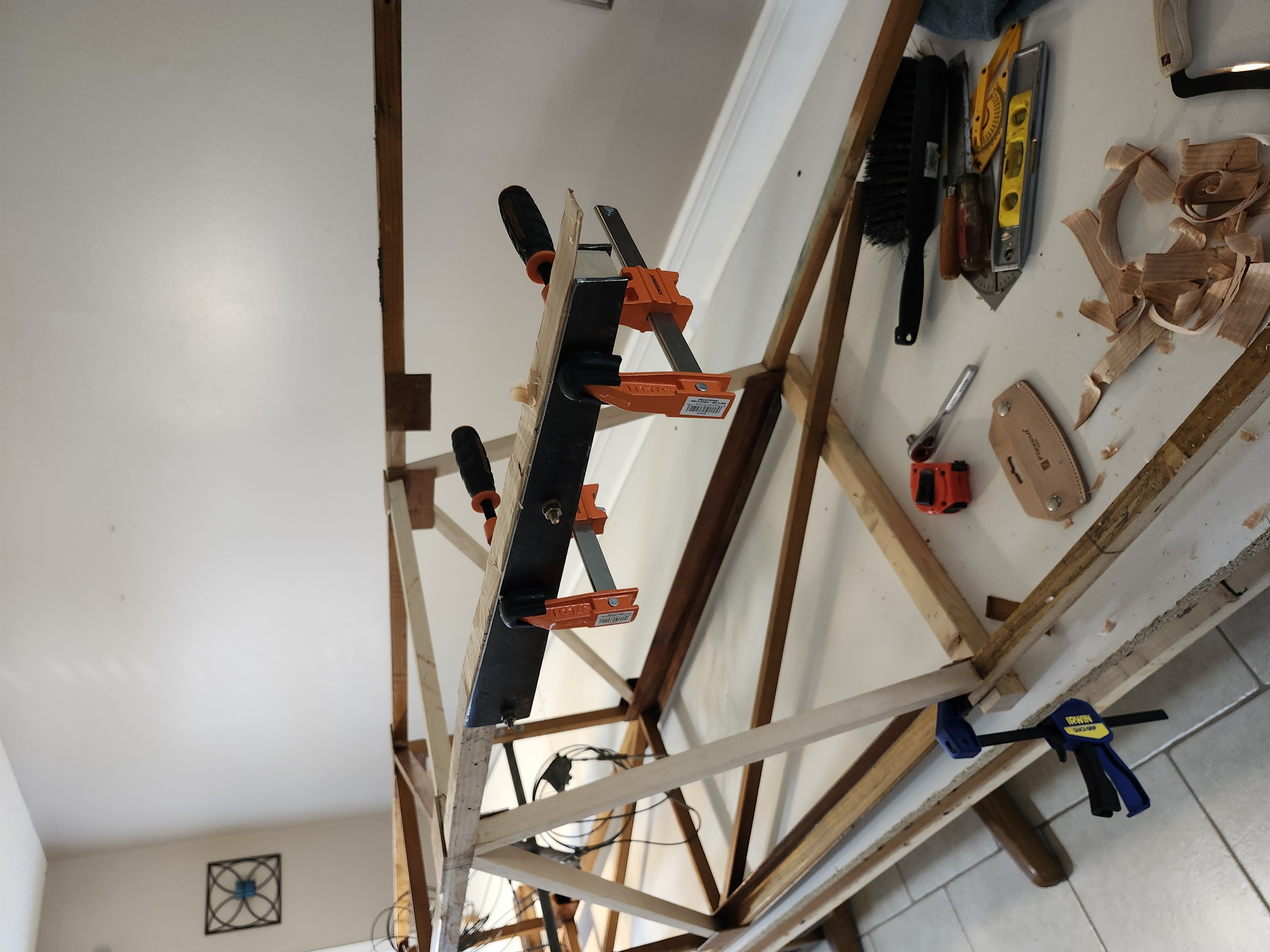

Well crap...., while marking up the longerons for cuts for the splices, I found a crack in the lower left one, right where I wanted to do the splice. Always something. Time for another inspection for additional damage I might have missed and to re-evaluate the splice location on the lower left longeron.

Good eyes. I'm glad you caught the crack now and not when it might matter later. It seems you're doing this just right!

The first two splices cut.

Wish I had thought of that nifty scarfing jig. It's nice when you have the working room for nice jigs and clamps and planes and spokeshaves to work with! It seems like anytime I need to make repairs to something, I have to work with small tools and work by eyeball in very tight spaces.

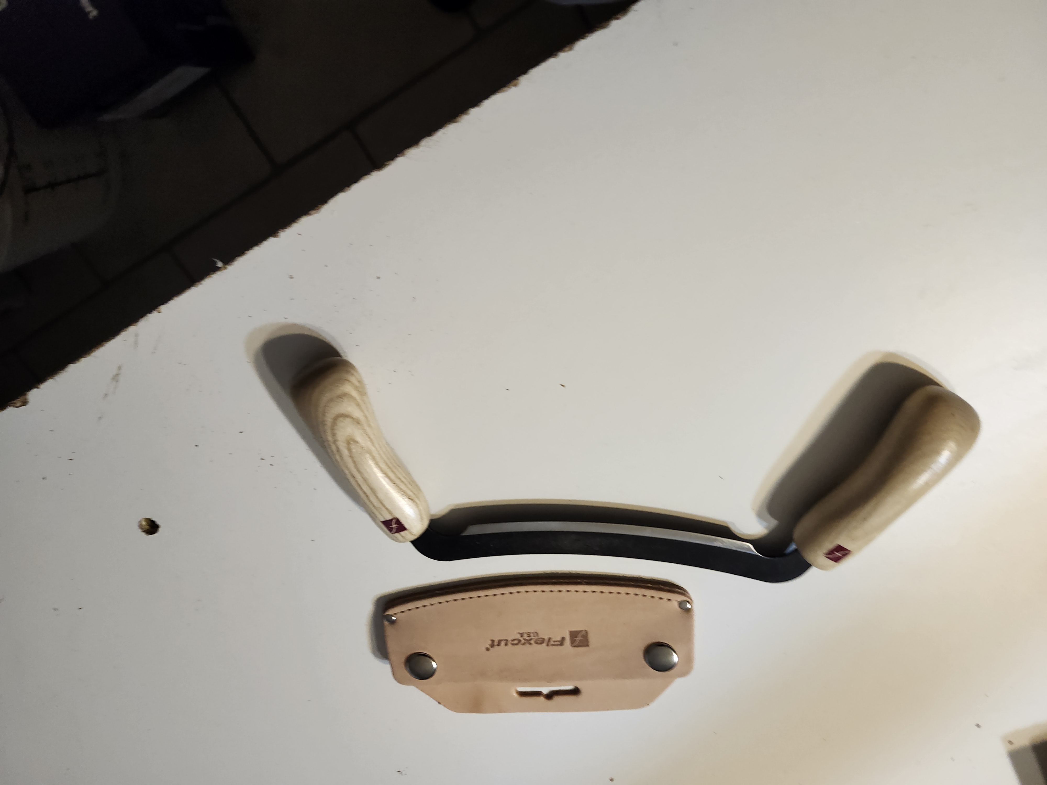

What did you use to get rid of the biggest part of the scarf?

On my first try, back on one of the tail longerons, I tried a saws all and chisels. It was practically uncontrollable. Vibration and catching the wood it jumped all over the place.
Now I use a small draw knife I bought at Rocklers. It takes 3 to 5 minutes to cut down to just shy of the guide, then I finish with a block plane.

Alrighty, now! Thanks for that..

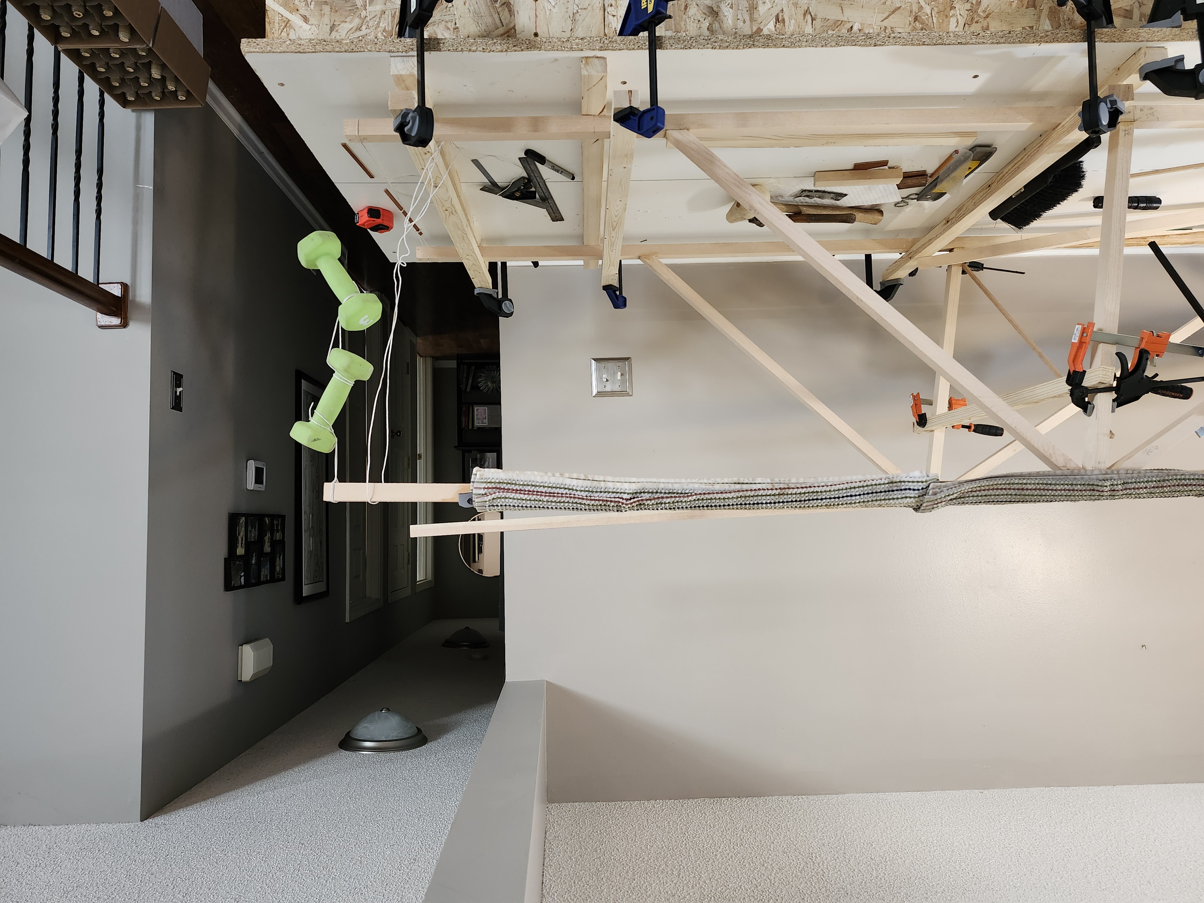

The four pieces for the front of the fuselage are ready to be glued on.
- Posts: 266
Re: N34KP's rebuild
The bottom longerons are gluing.
- Posts: 266
Re: N34KP's rebuild
The two upper longerons are gluing.
