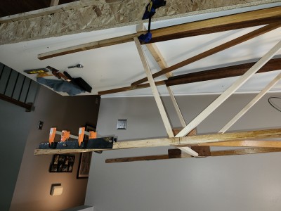

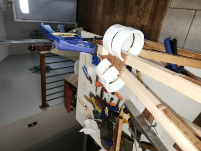

Back from visiting my sisters and mother. I planed the doublers on the lower right longeron this morning. Time to glue up the lower left.

Glued up the lower left longeron doublers today.

Nice work, Richard. I'm a machinist, not a woodworker, but have been learning about hand planes on this Piet project. It's strangely satisfying watching a chip roll of them. :D

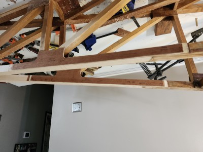

The rear splices are complete. Station piece and pulling them together at the tail post next.

Station piece, diagonal and doublers. Late night glue up.

I glued in the old tailpost last night. Gussets next.

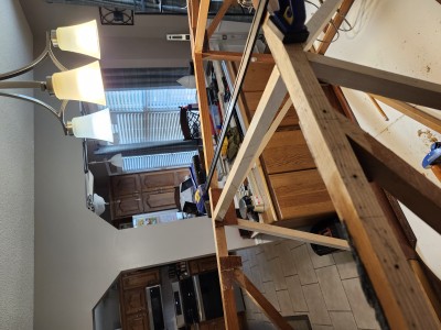

The tail reconstruction is finished except for fairing strips and holes for the fittings.

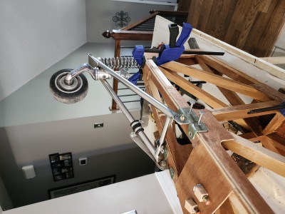

The holes for the forward tailwheel brackets are drilled.

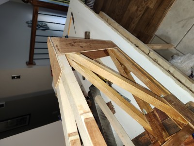

Since I moved the upper seat back aft 3-1/2" I was able to reuse the diagonal brace behind the seat back by re-cutting to the new angles. I still need to install the forward gusset.

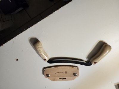

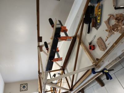

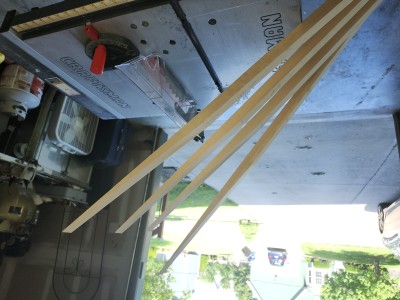

What did you use to get rid of the biggest part of the scarf?
Posts: 372
Re: N34KP's rebuild
On my first try, back on one of the tail longerons, I tried a saws all and chisels. It was practically uncontrollable. Vibration and catching the wood it jumped all over the place.
Now I use a small draw knife I bought at Rocklers. It takes 3 to 5 minutes to cut down to just shy of the guide, then I finish with a block plane.

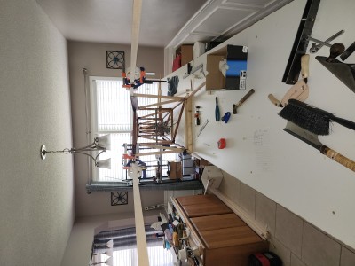

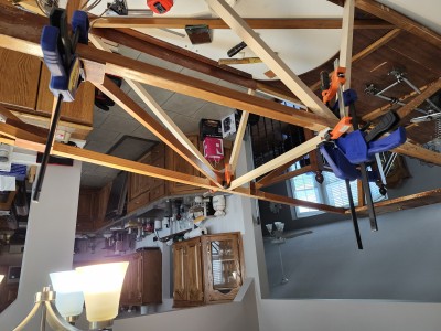

All four fuselage forward longerons scarphed. Now to do the repair pieces.

Inquiring minds want to know.. did you just run the plane down the steel jig?
Posts: 372
Re: N34KP's rebuild
After cutting close with the draw knife, yes.

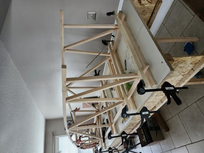

Re: N34KP's rebuild
The four pieces for the front of the fuselage are ready to be glued on.
Posts: 372
Re: N34KP's rebuild

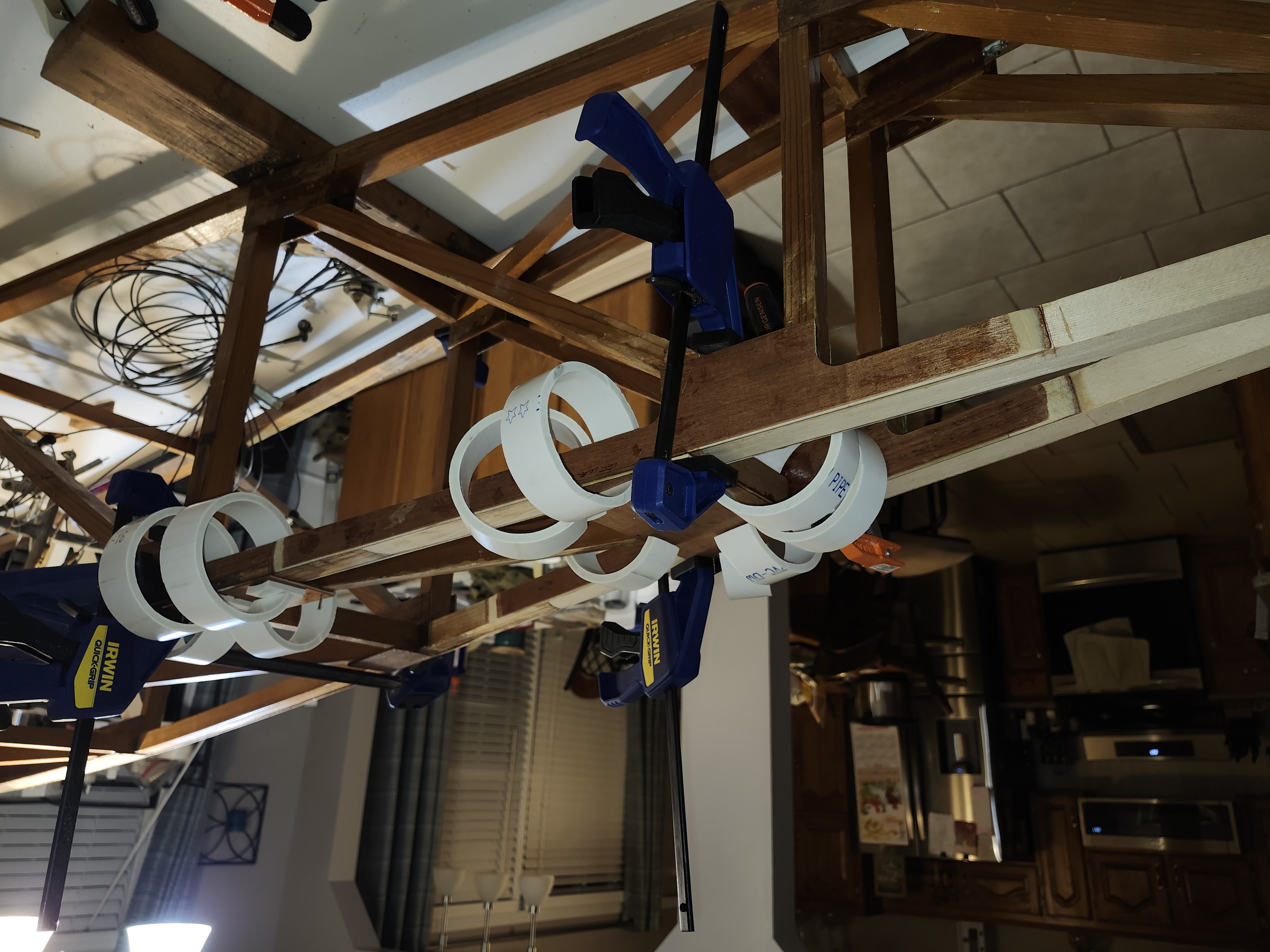

The bottom longerons are gluing.
Posts: 372
Re: N34KP's rebuild
The two upper longerons are gluing.

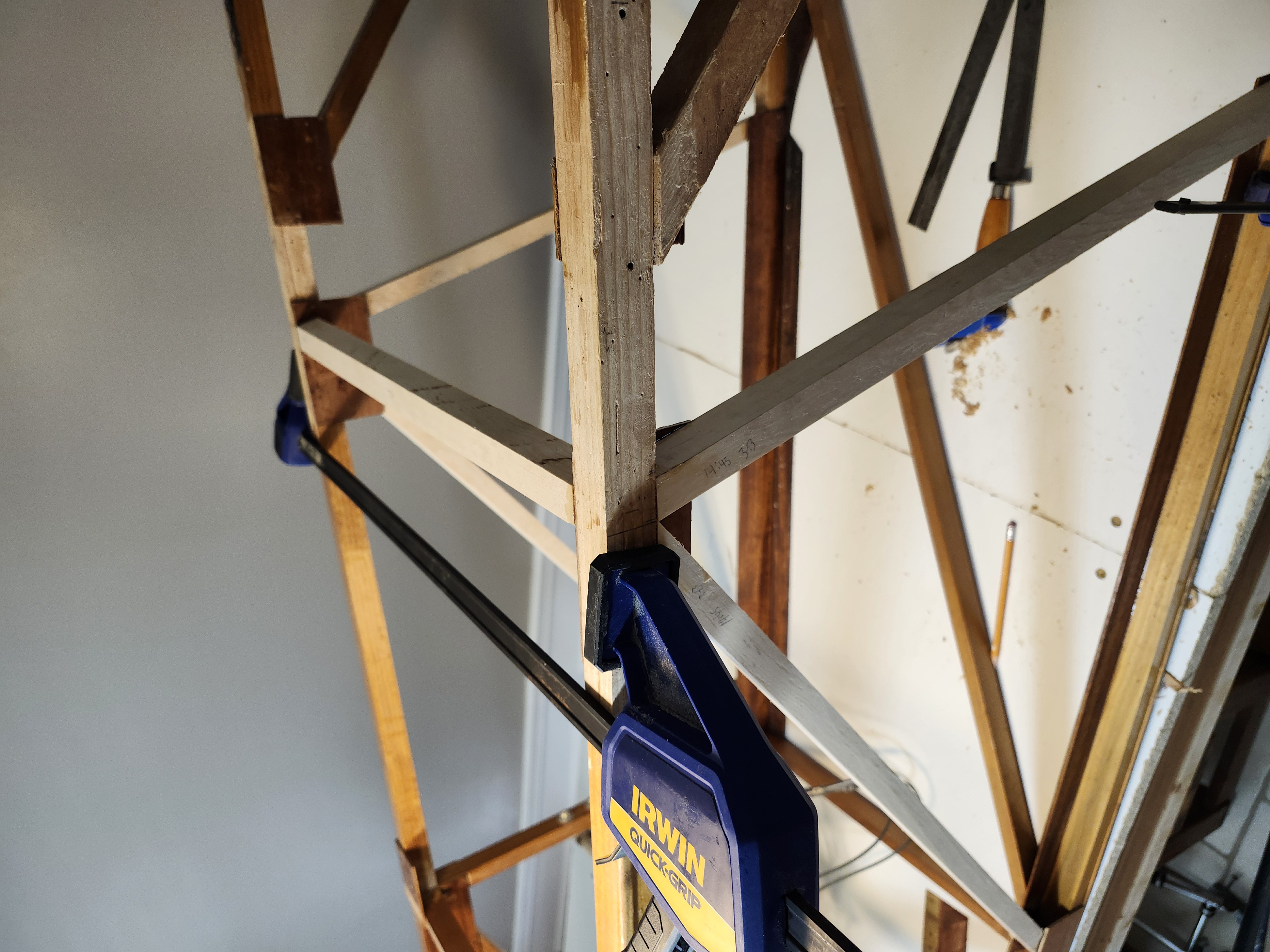

Posts: 372
Re: N34KP's rebuild
Gluing in diagonals.

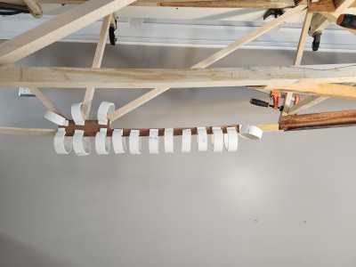

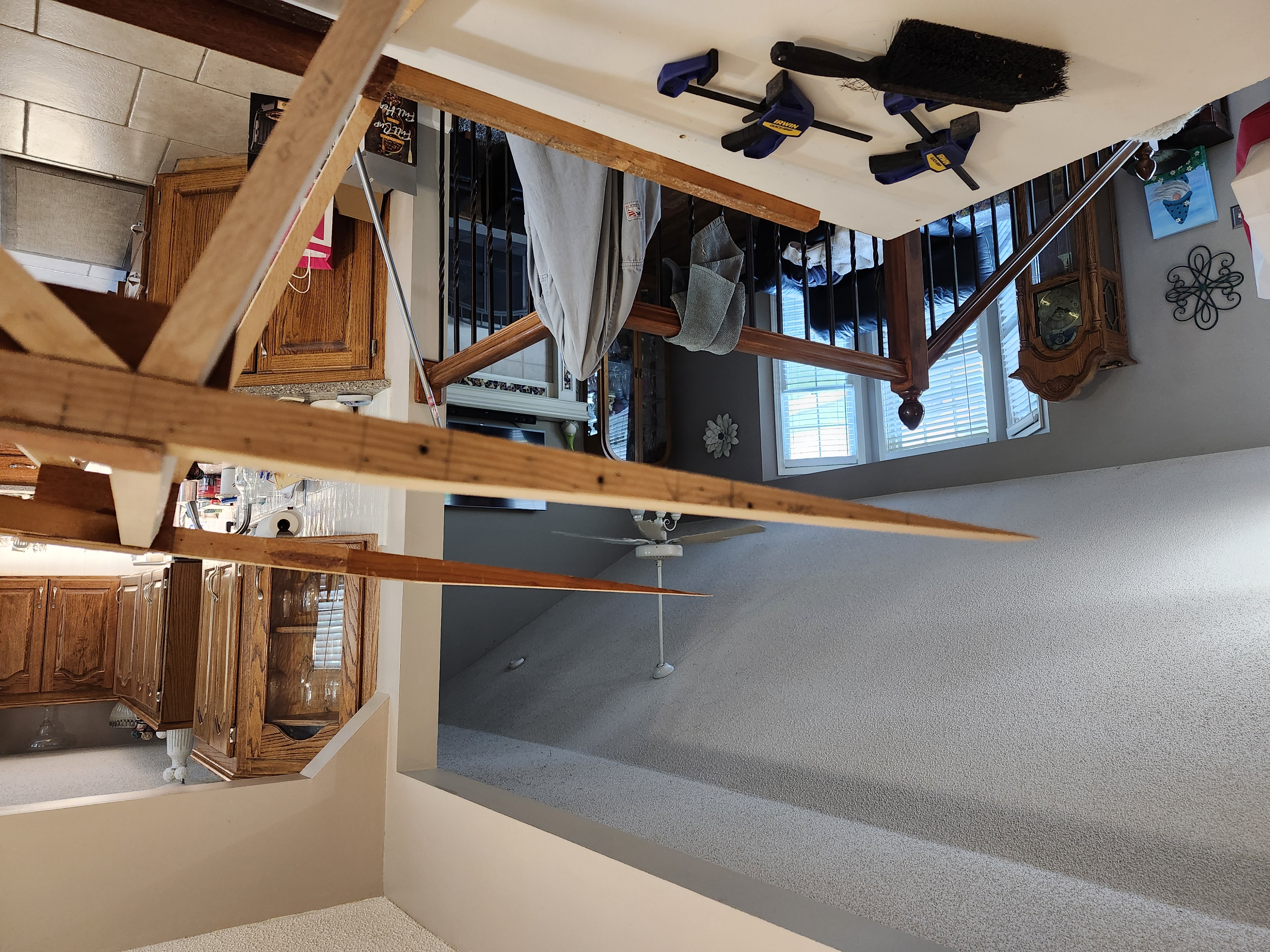

Re: N34KP's rebuild

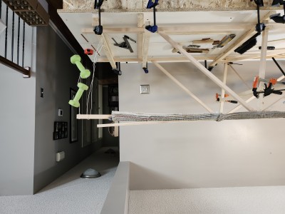

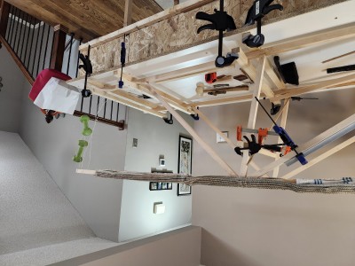

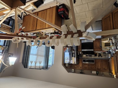

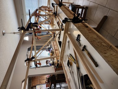

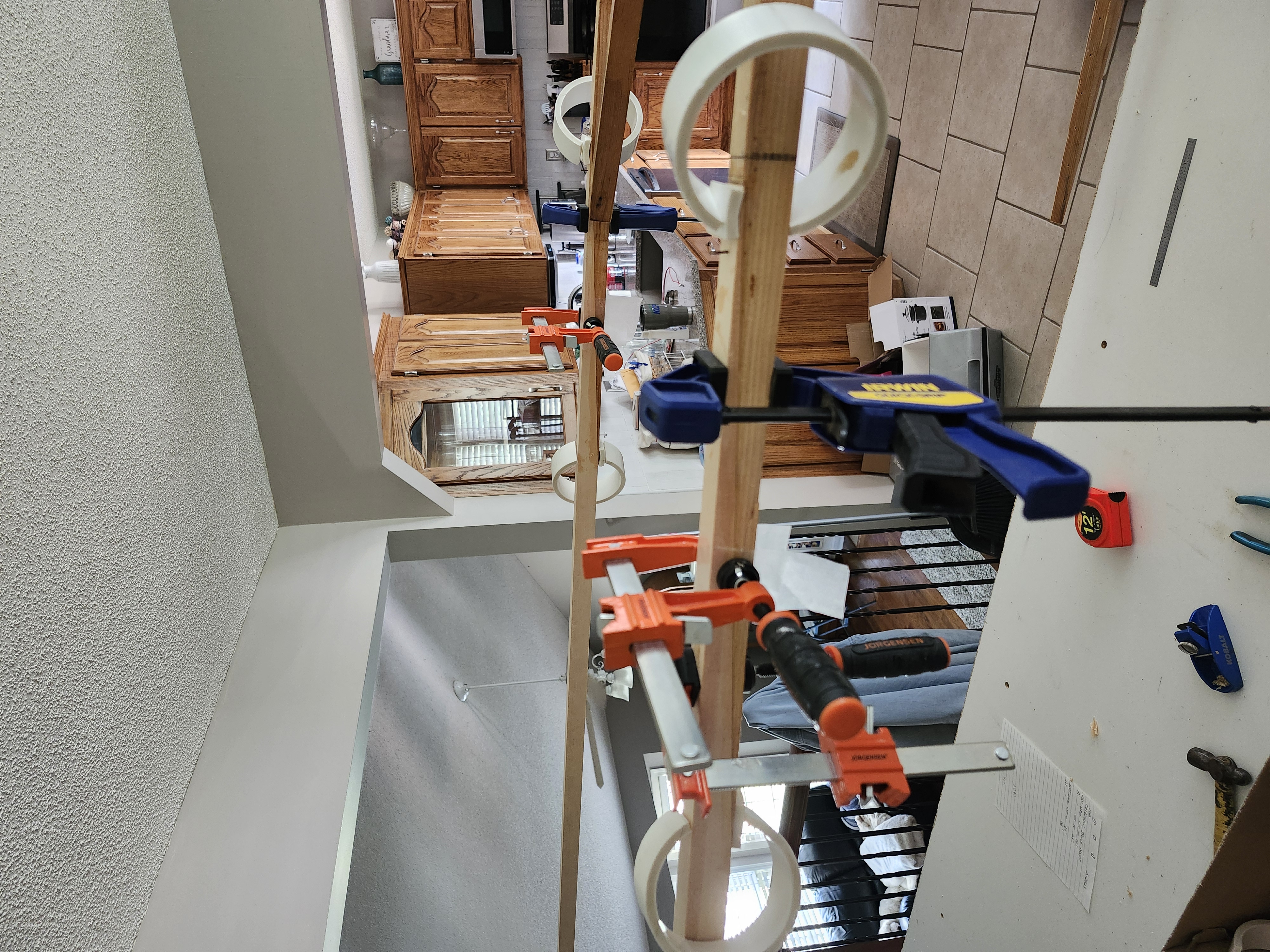

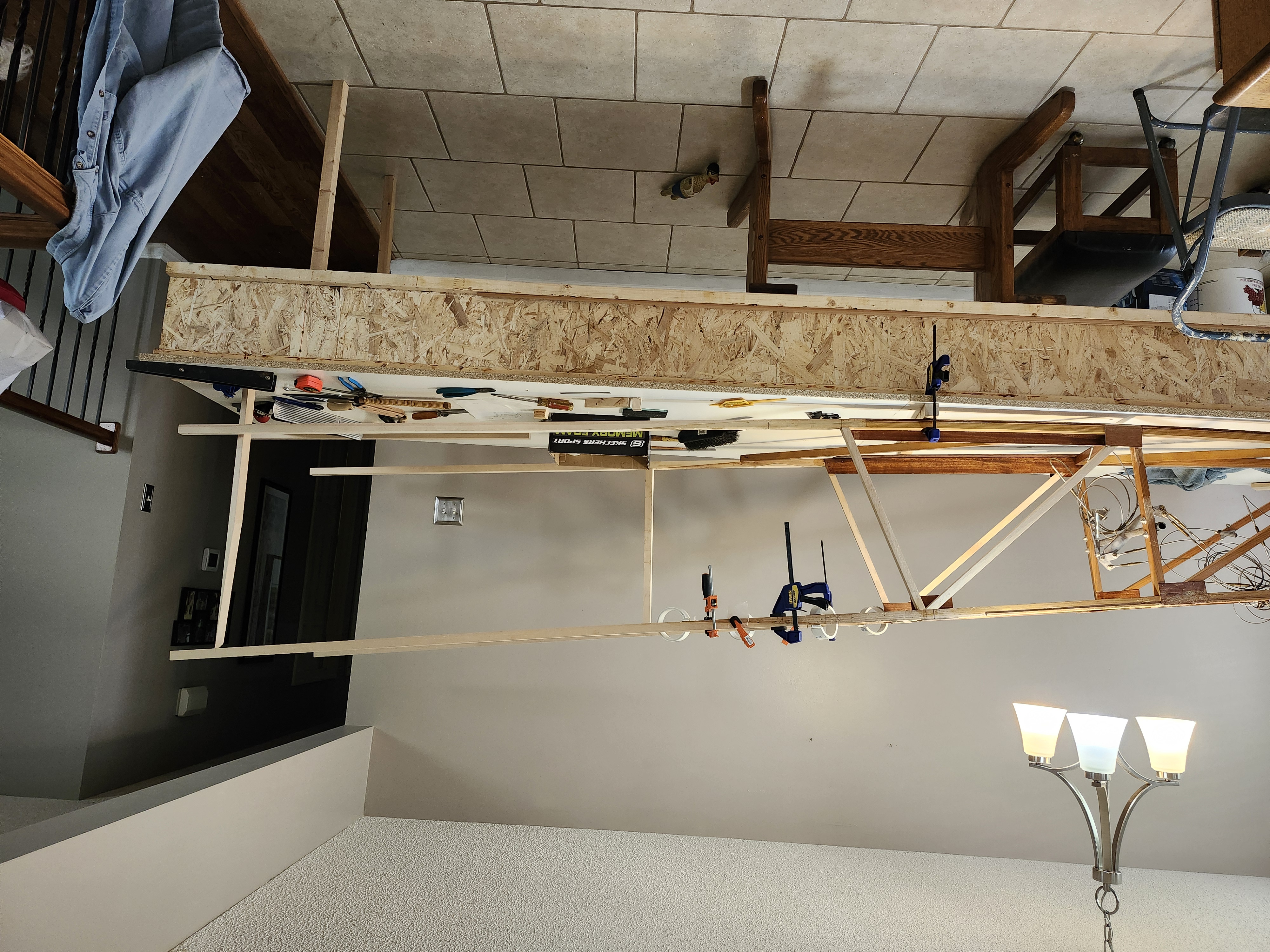

Bending a longeron. It dropped 2-1/8" at the end overnight. 6 lbs of weight hanging on the end.

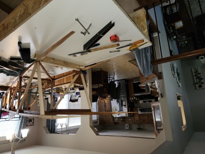

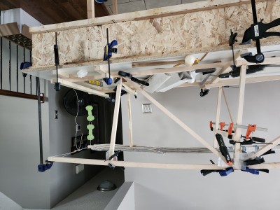

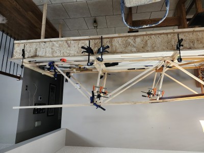

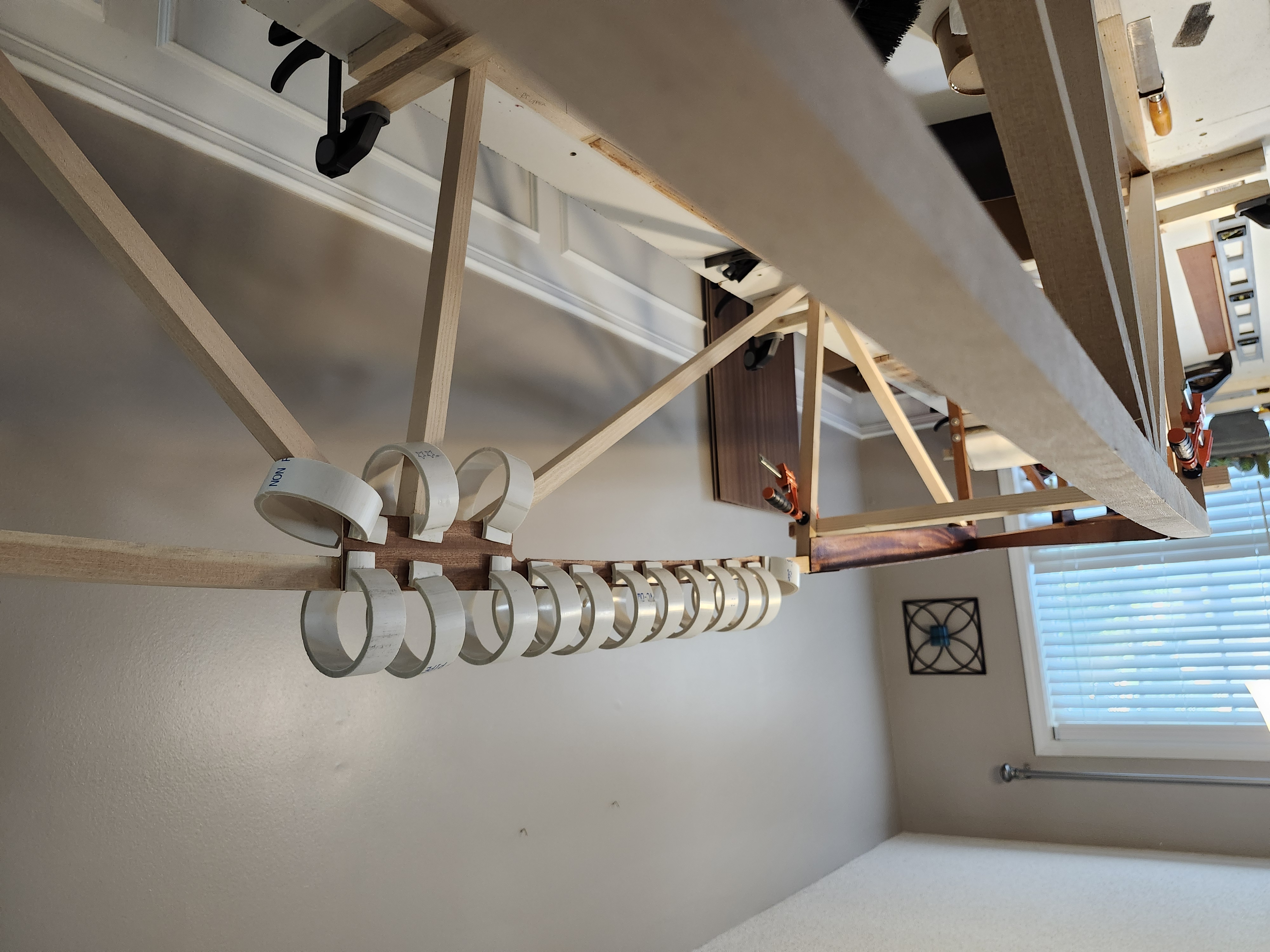

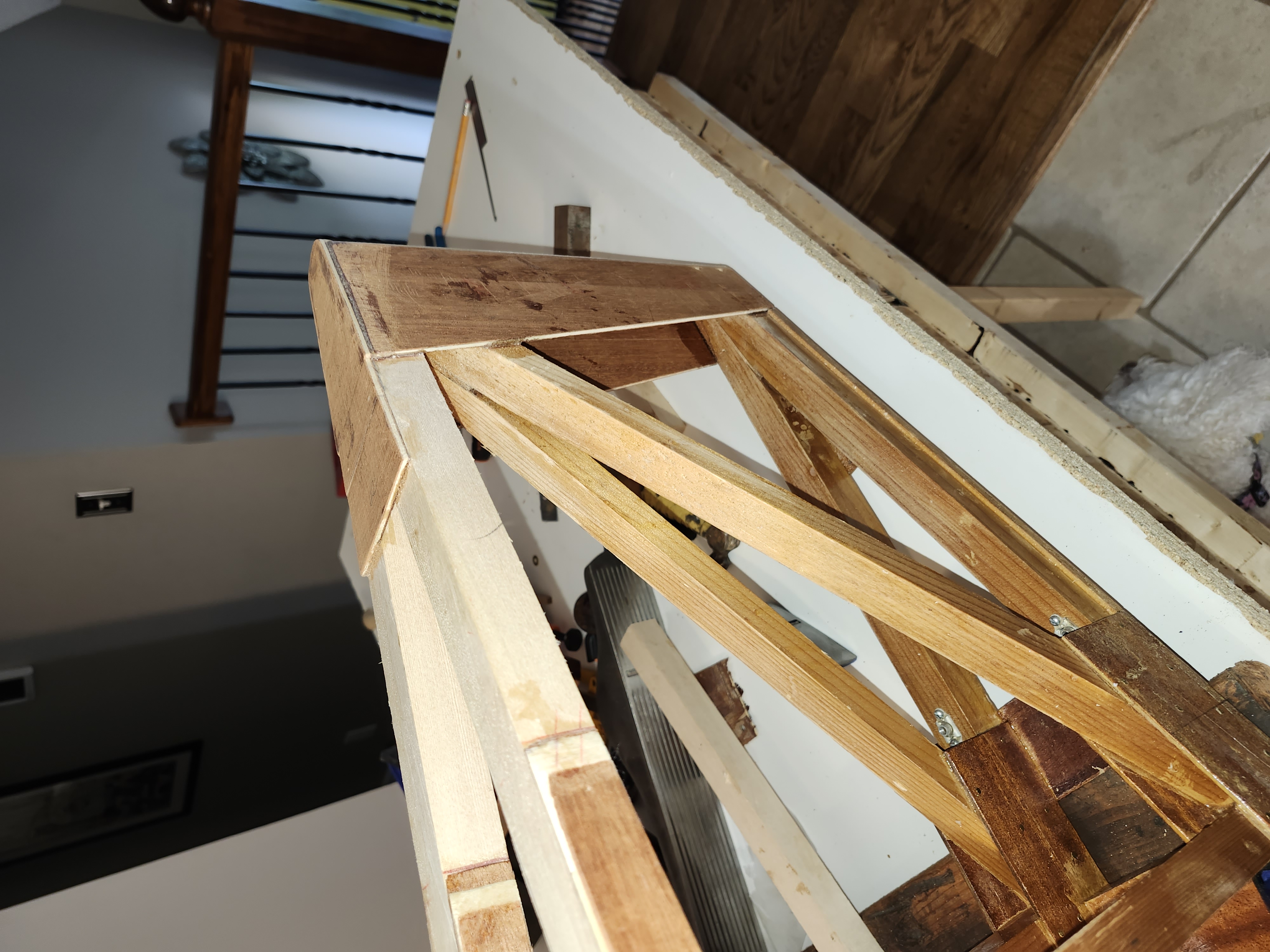

Up to the firewall on the left side.
Posts: 372

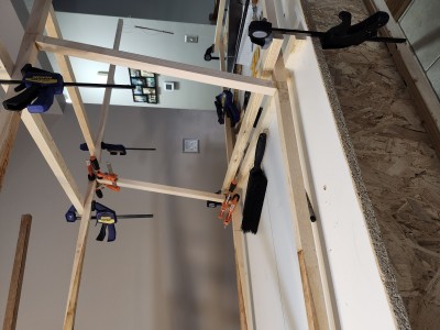

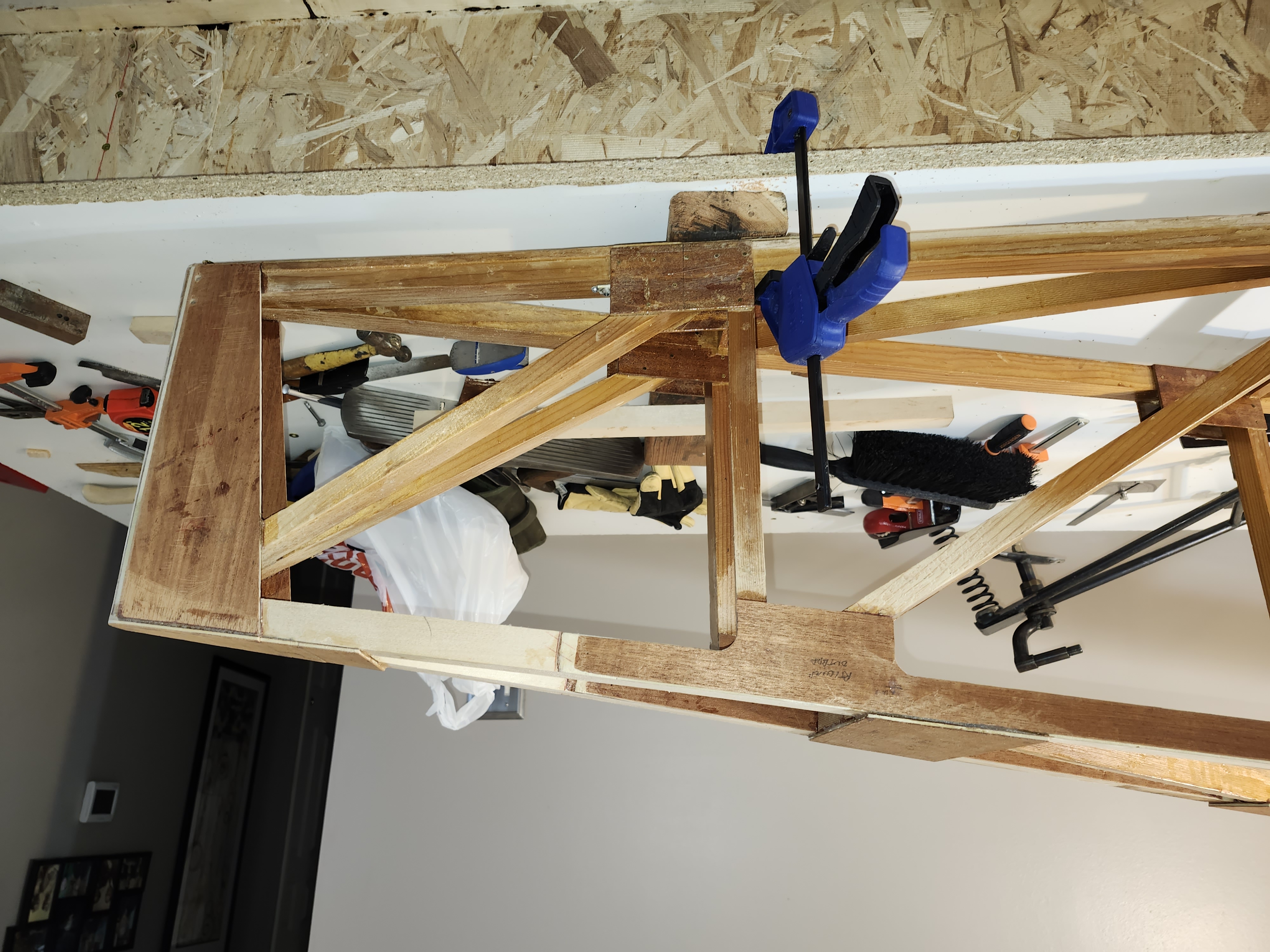

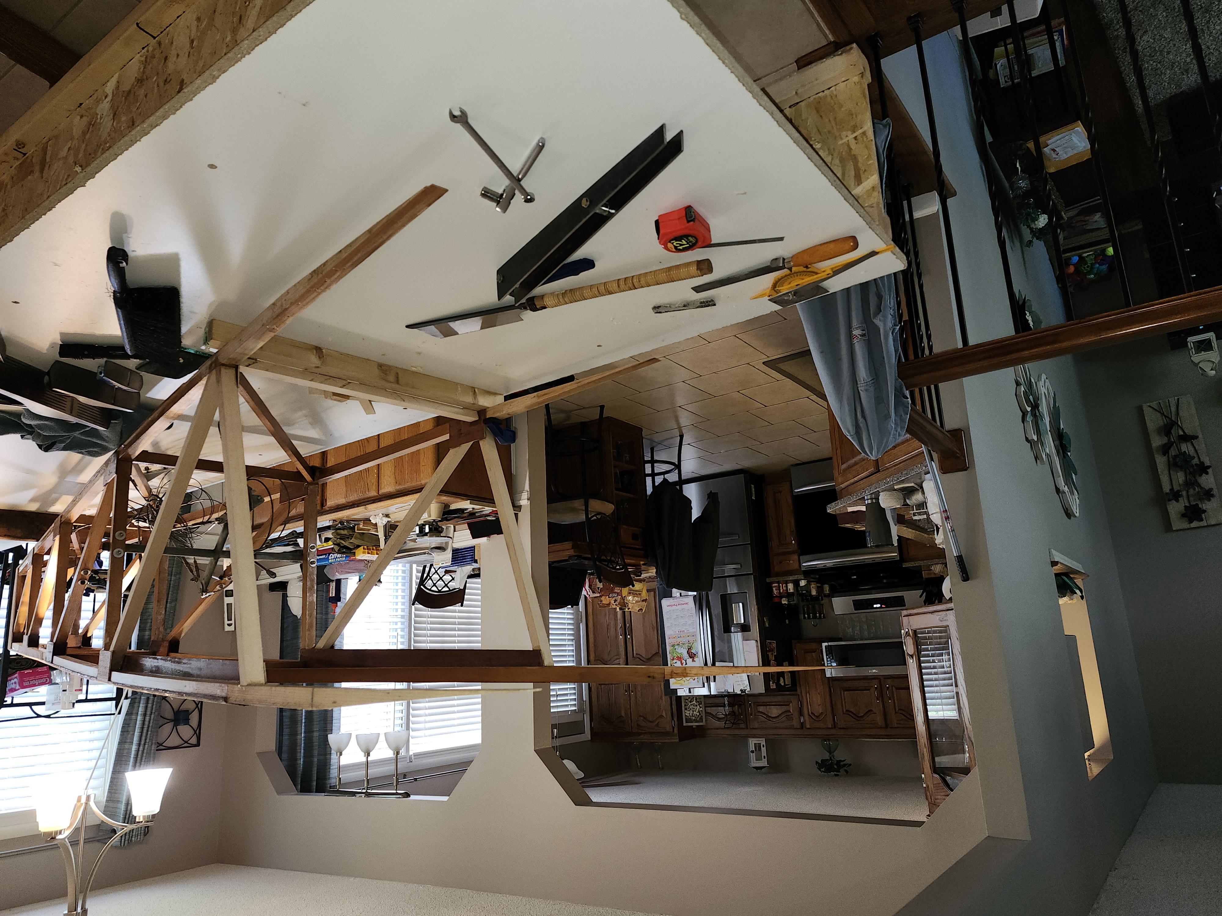

Re: N34KP's rebuild

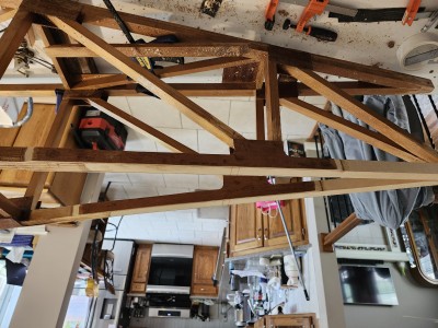

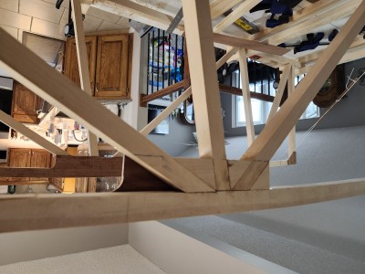

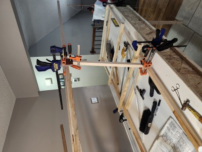

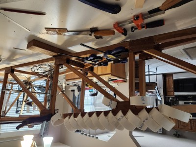

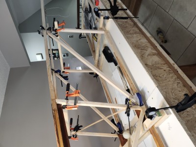

The side trusses are done. Time for inside gussets and station cross pieces.

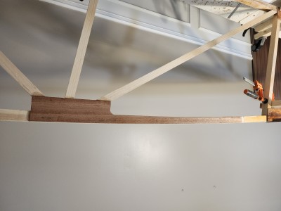

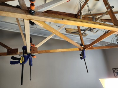

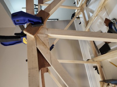

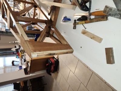

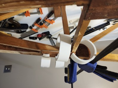

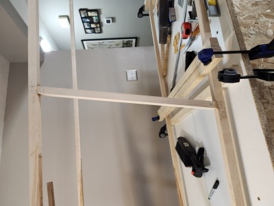

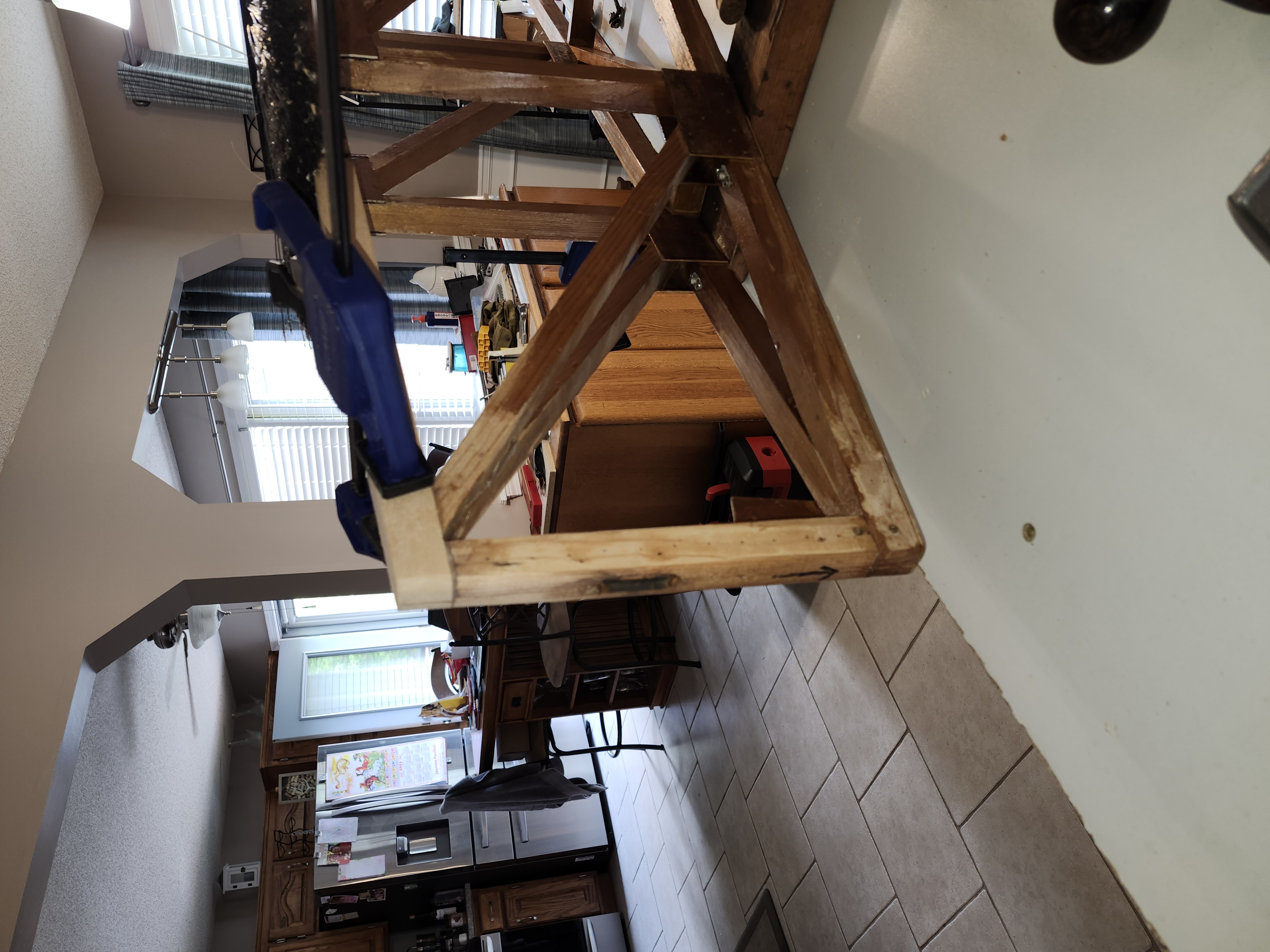

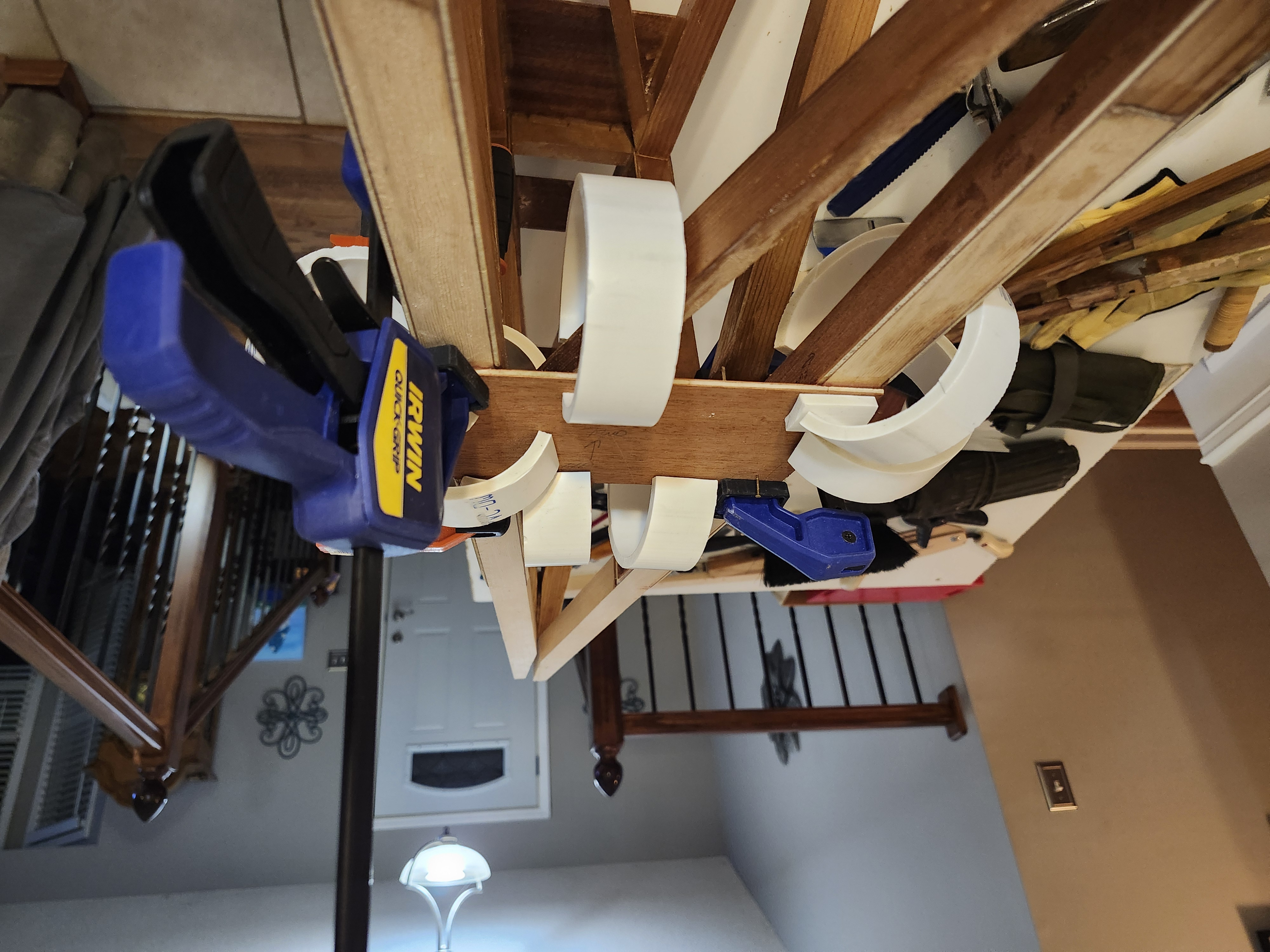

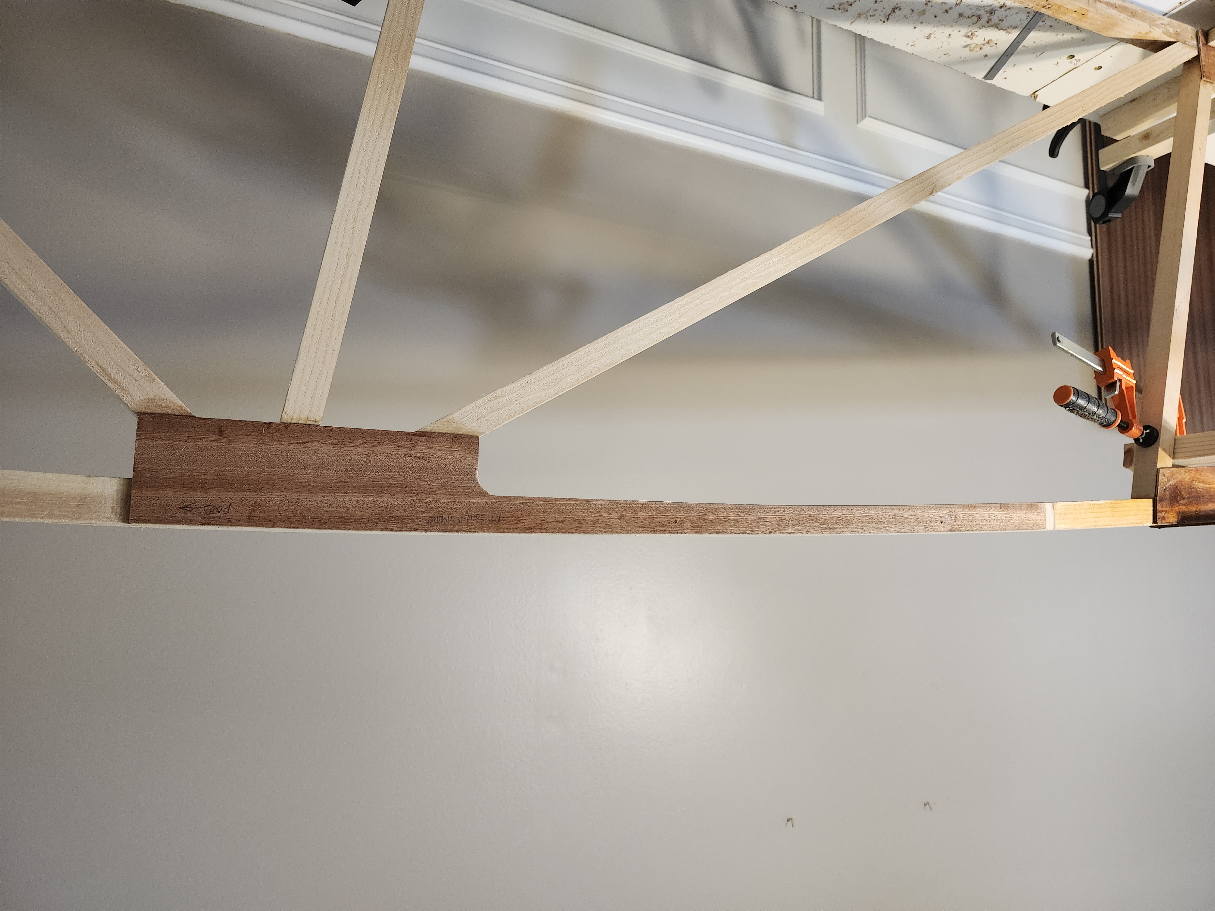

I hadn't worked on the Piet since the third week of June, due to my wife's memorial and my general lack of desire to do anything. But today I started cutting inside gussets. The one shown, inside lower right, has a long one. The gussets for the longeron splice and the station came so close together I decided to combine then. It'll be the same way on the opposite lower longeron.
Posts: 372
Re: N34KP's rebuild

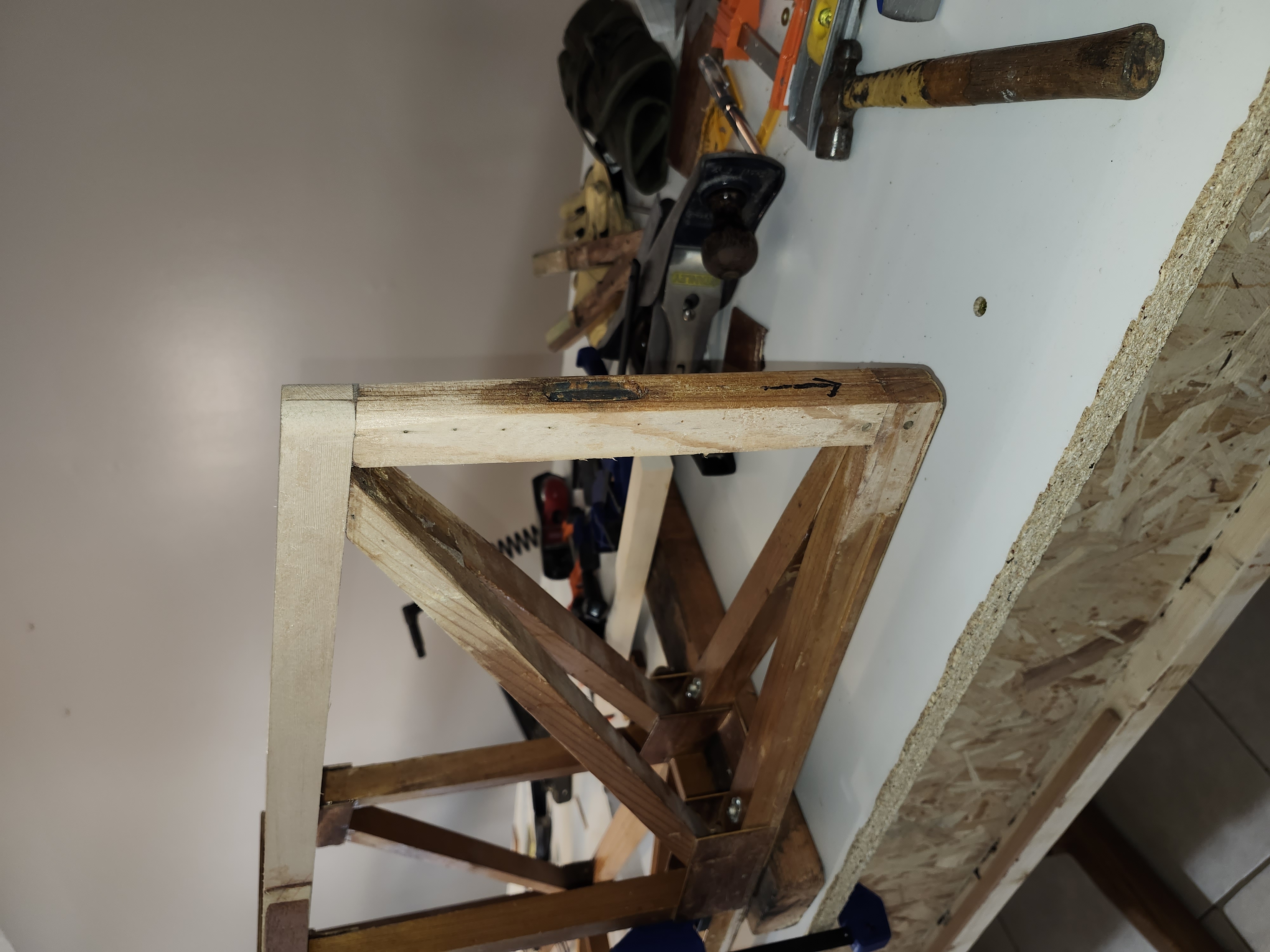

After the clamps and final shaping.

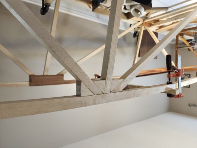

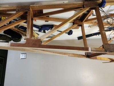

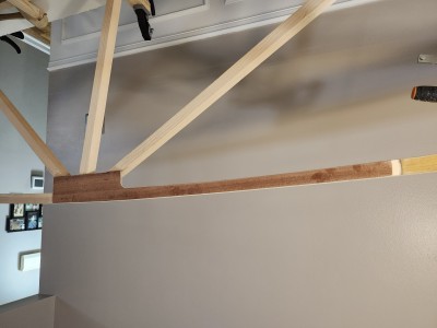

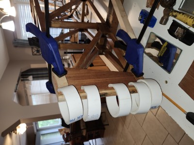

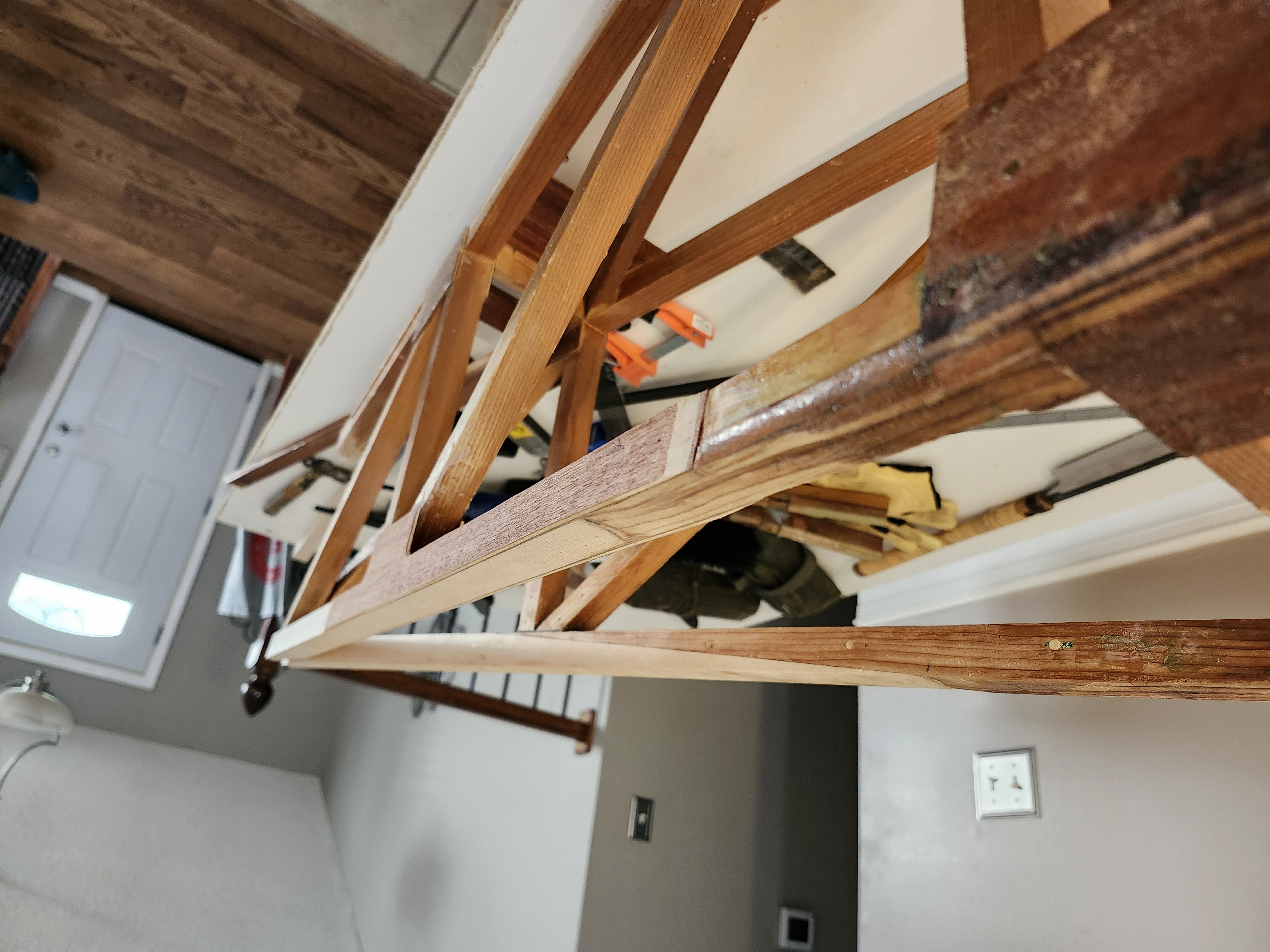

Left lower longeron splice and station.

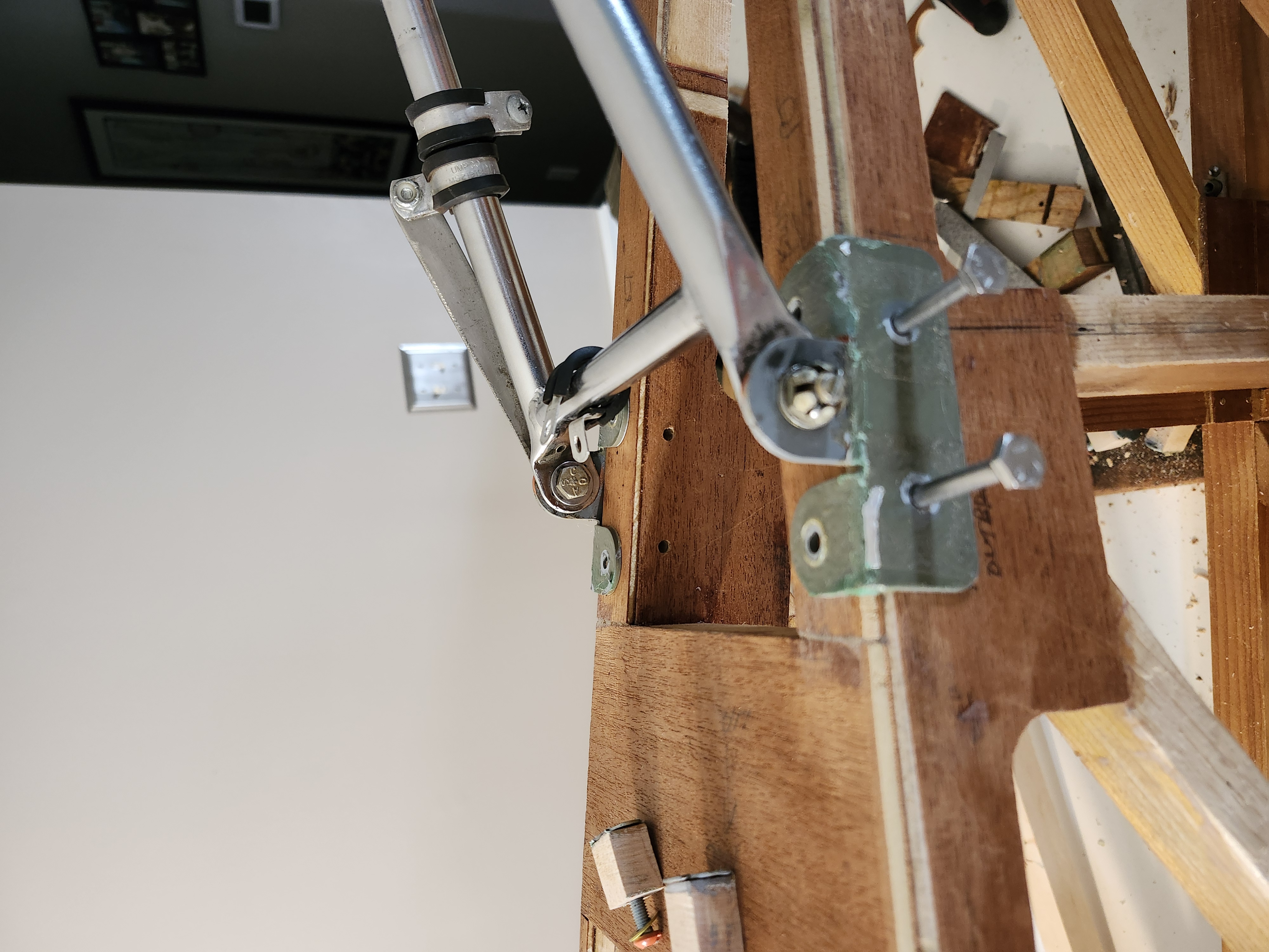

Posts: 372
Re: N34KP's rebuild
Lots of family crap going on, getting in the way of Piet rebuild time

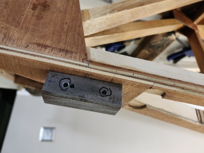

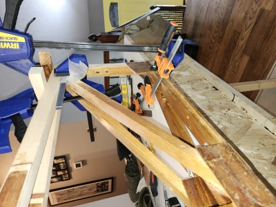

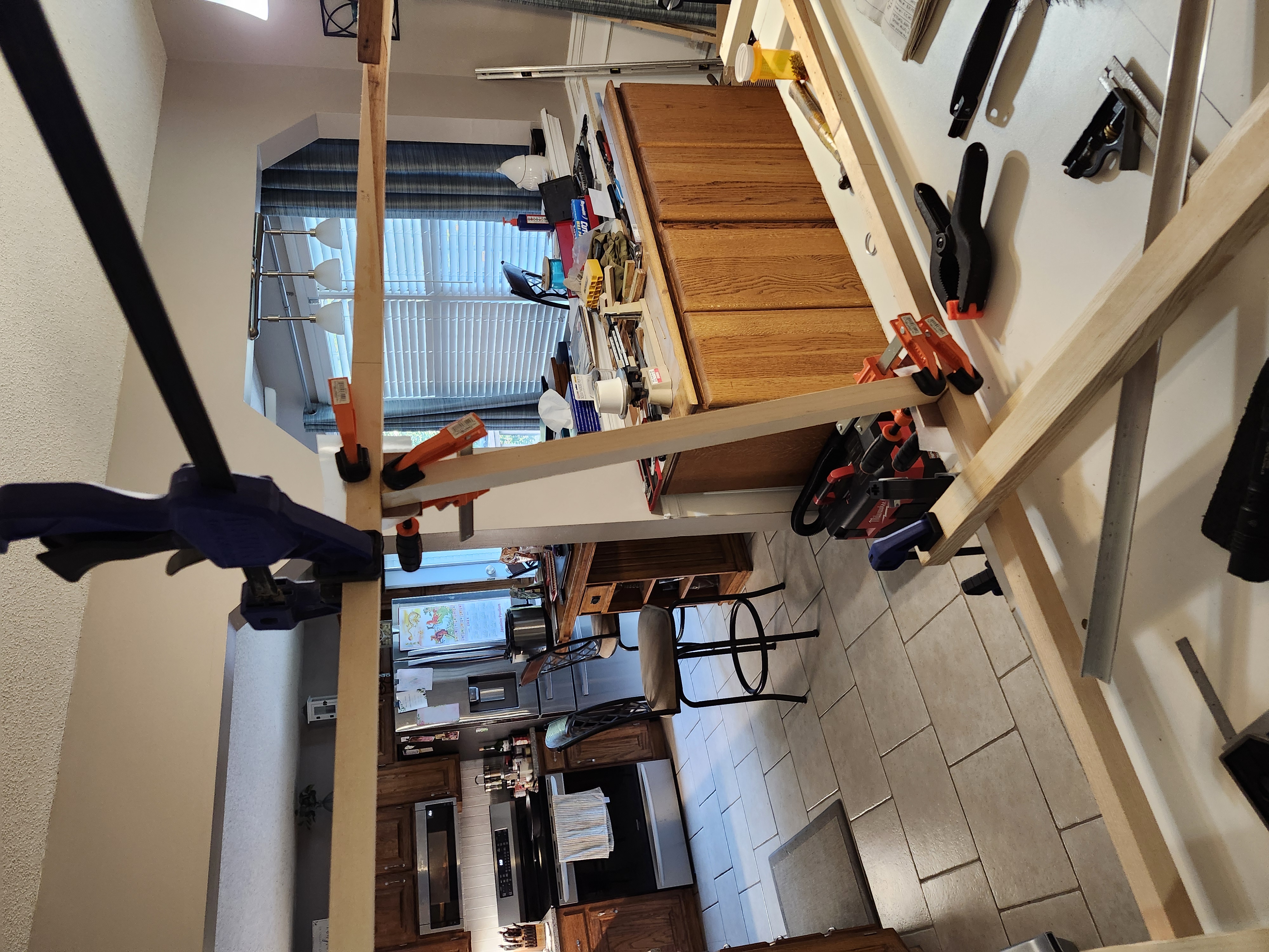

I have managed to get some of the blocking for the landing gear/lift strut fittings started.

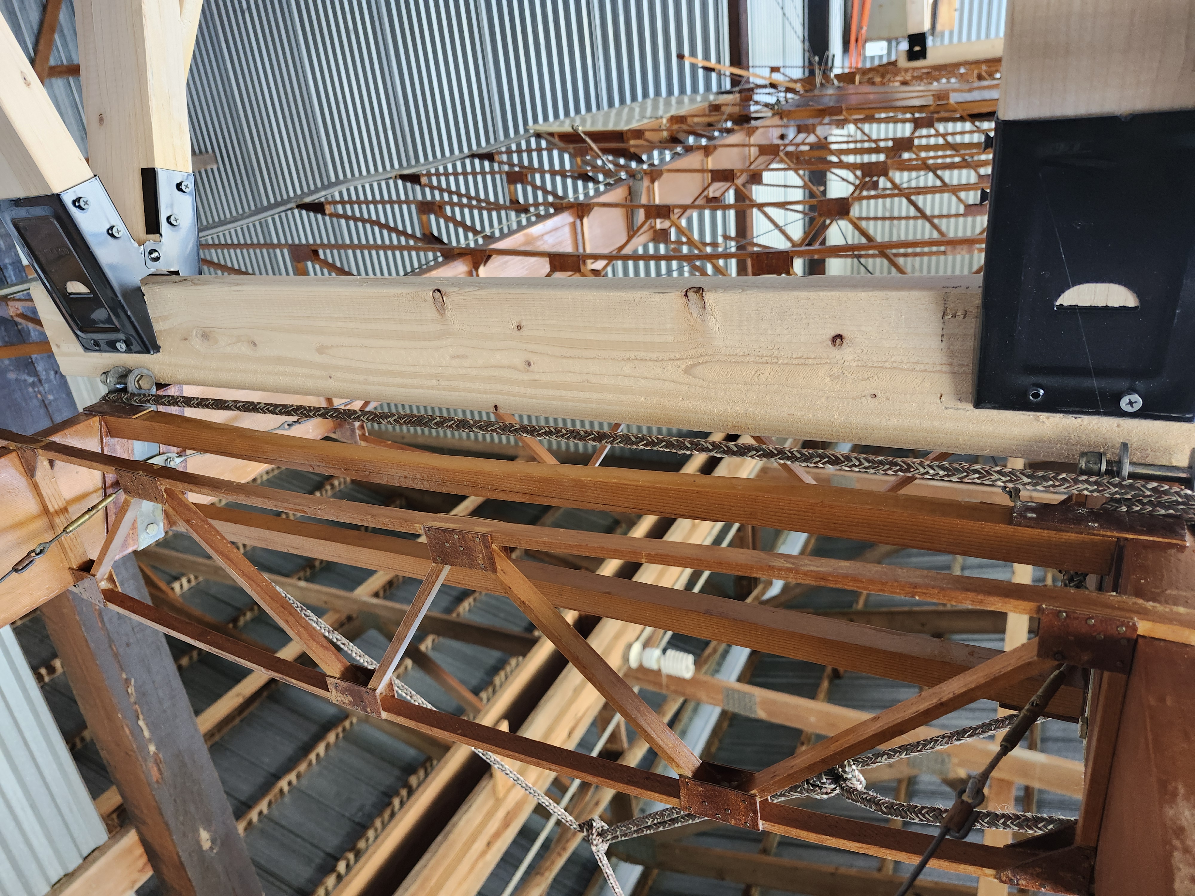

Re: N34KP's rebuild

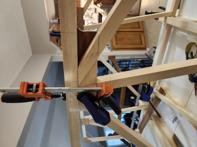

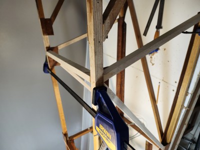

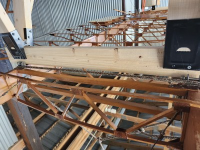

I was out at the hanger taking some measurements on the wing. I found something interesting. When Ken built the wing, he did the compression struts in the middle of the wing different. Instead of offsetting the struts with the 1/4" plywood to clear the bottom of the wing fabric, he cut a curve, like the lower center section pieces, flipped the cut out piece over and glued it to the top of the strut.
Re: N34KP's rebuild
And yet another example of how the simple things are often the most elegant. Very nice detail.
