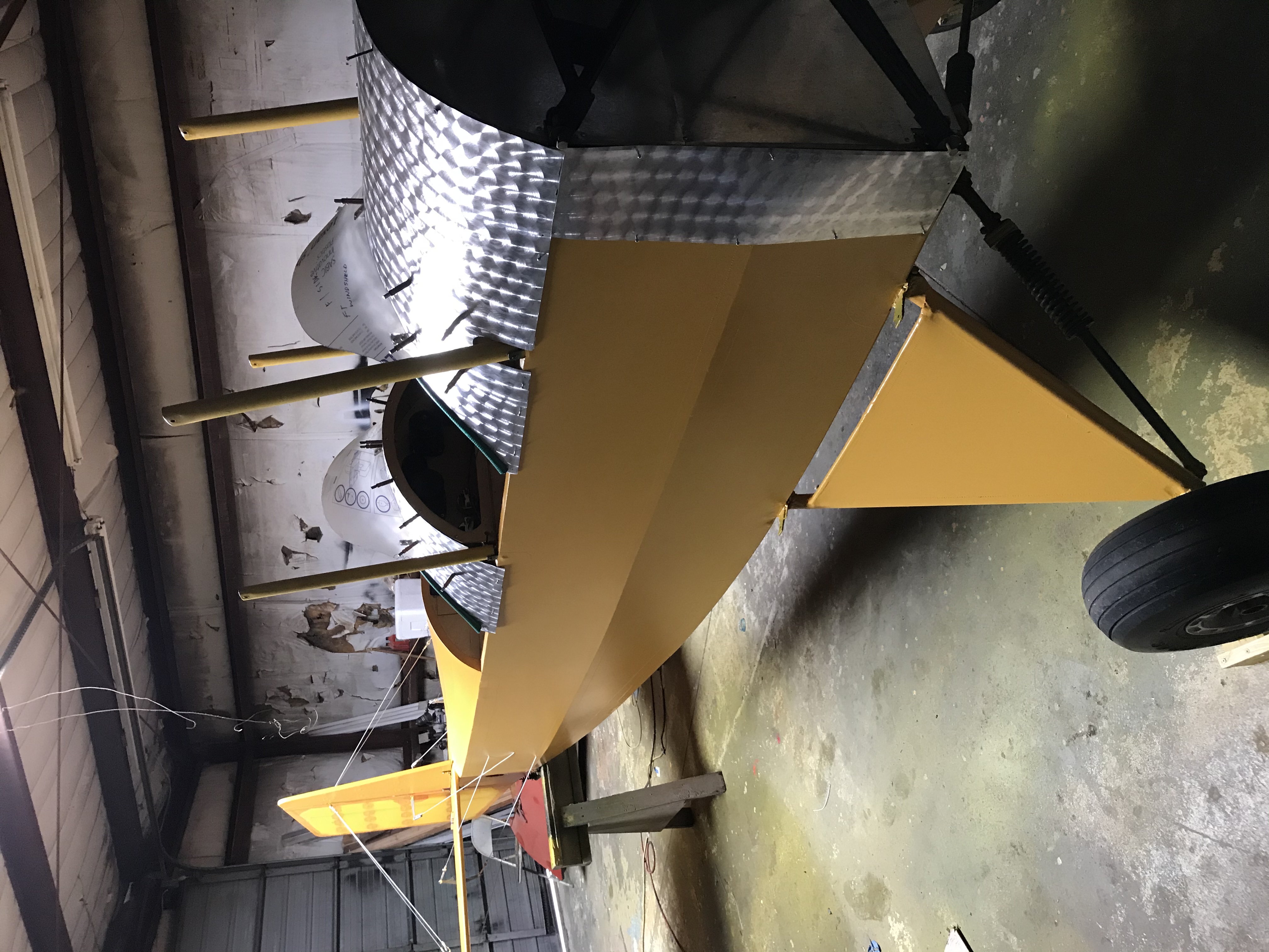

adding pics of current build. this will be cont powered, long fuse, cowings are also complete.

cont engine mount tac weld fixture.

very nice work!! can't wait to see it flying. this one i am building is my 7th. i still need to build some of the tail feathers.

these are the hardest parts to make on the entire airplane; but got them done

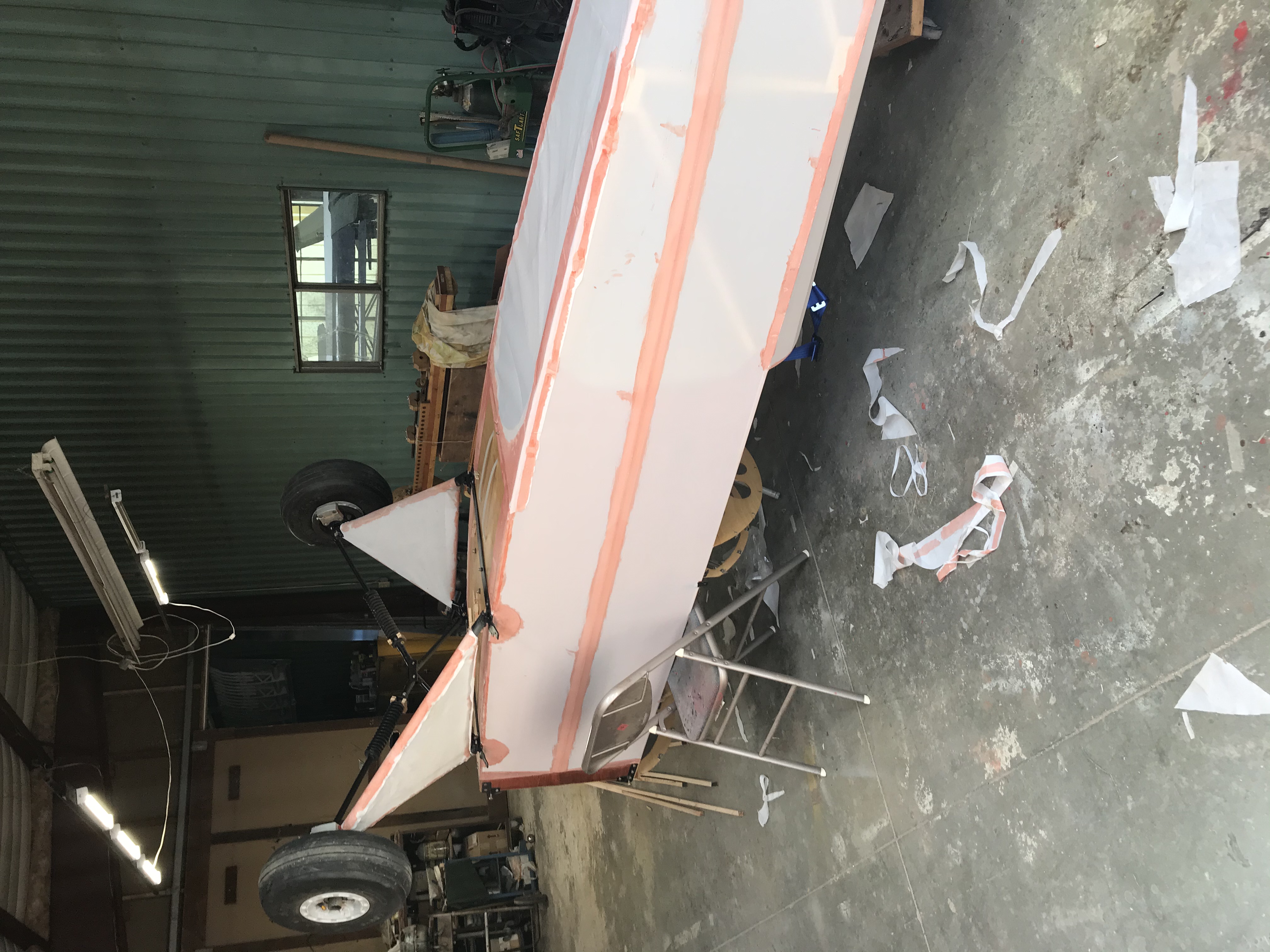

completed tail feather fitting and rigging today. it was a productive day.

Congratulations!! It's a great feeling to be at the covering stage. Suddenly the light at the end of the tunnel seems much brighter.

Re: status of current build
Careful... I see you've got that plane inverted. Note that the Air Camper is Normal category and only good for negative 1.52 G ;o)
-Oscar Z.

sure is easier to cover the bottom upside down though

completed more on engine, covered ailerons, wing ready for cover.
