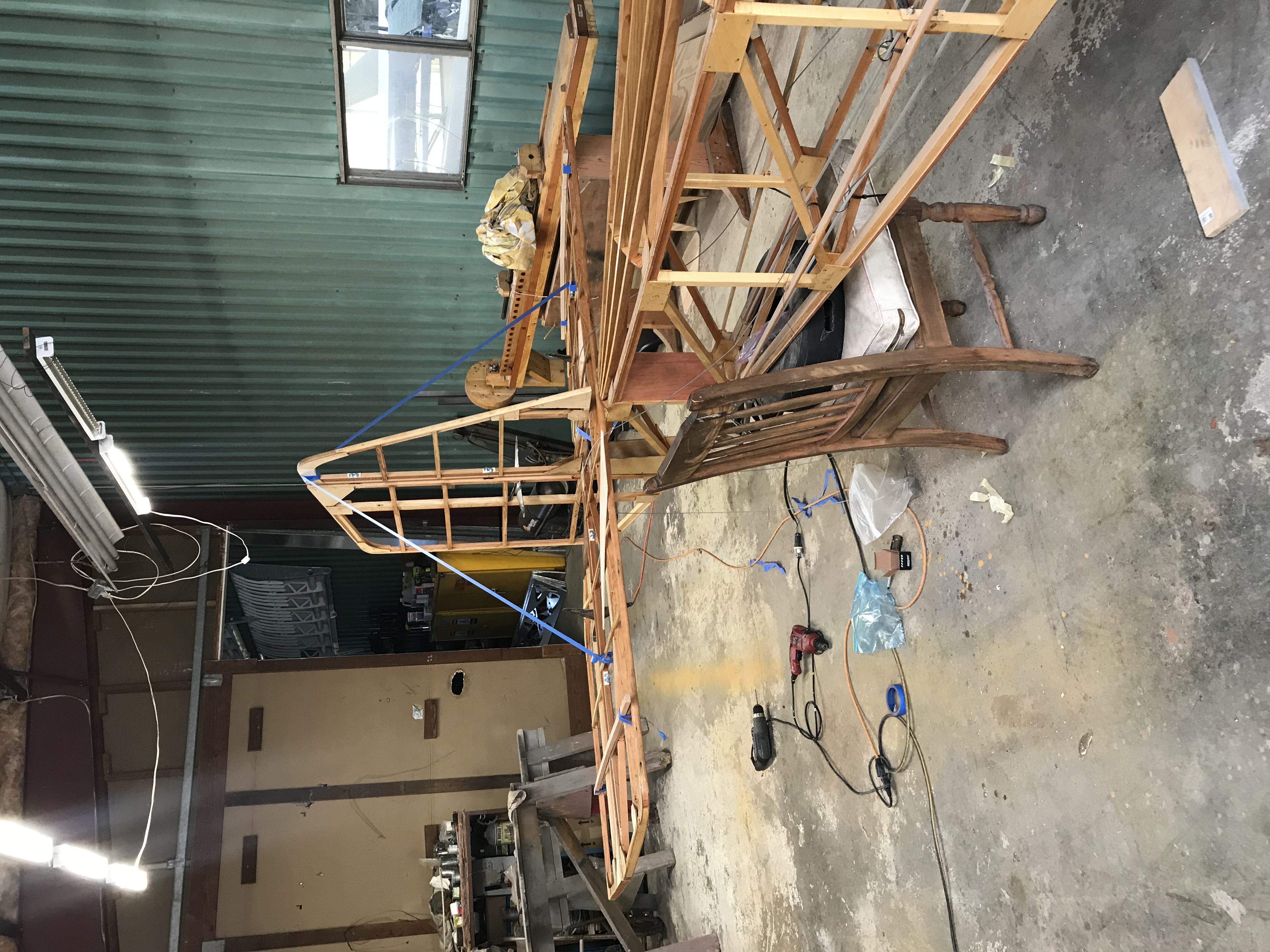

adding pics of current build. this will be cont powered, long fuse, cowings are also complete.

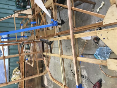

cont engine mount tac weld fixture.

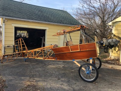

I do.
Here’s a few.

Dan,
Beautiful work, and beautiful work,a ship!
What is the angled blue steel strap at the rear end of the plywood on the S’board side of the fuselage?
Posts: 95
Re: status of current build
SEVENTH BUILD!
At some point I think you can no longer call it amateur built ha ha.
Could we get a photo montage of your life's work?
Tom, the blue fitting is just a U shaped strap for attaching a seat belt to.
Also, I was asked in a PM about the cable clamps on the center section cross bracing. These are temporary hardware store clamps, the airworthy versions will be swaged.

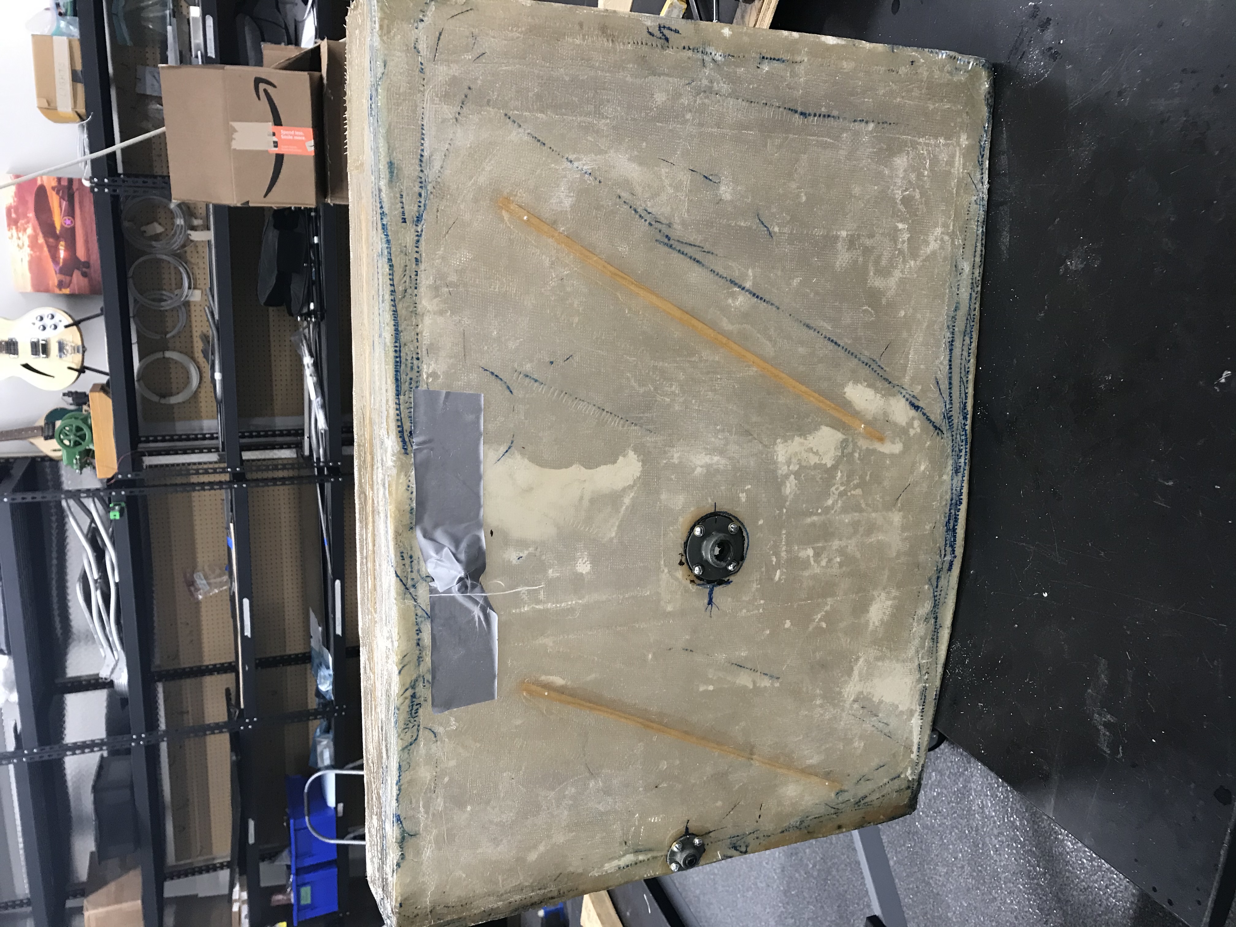

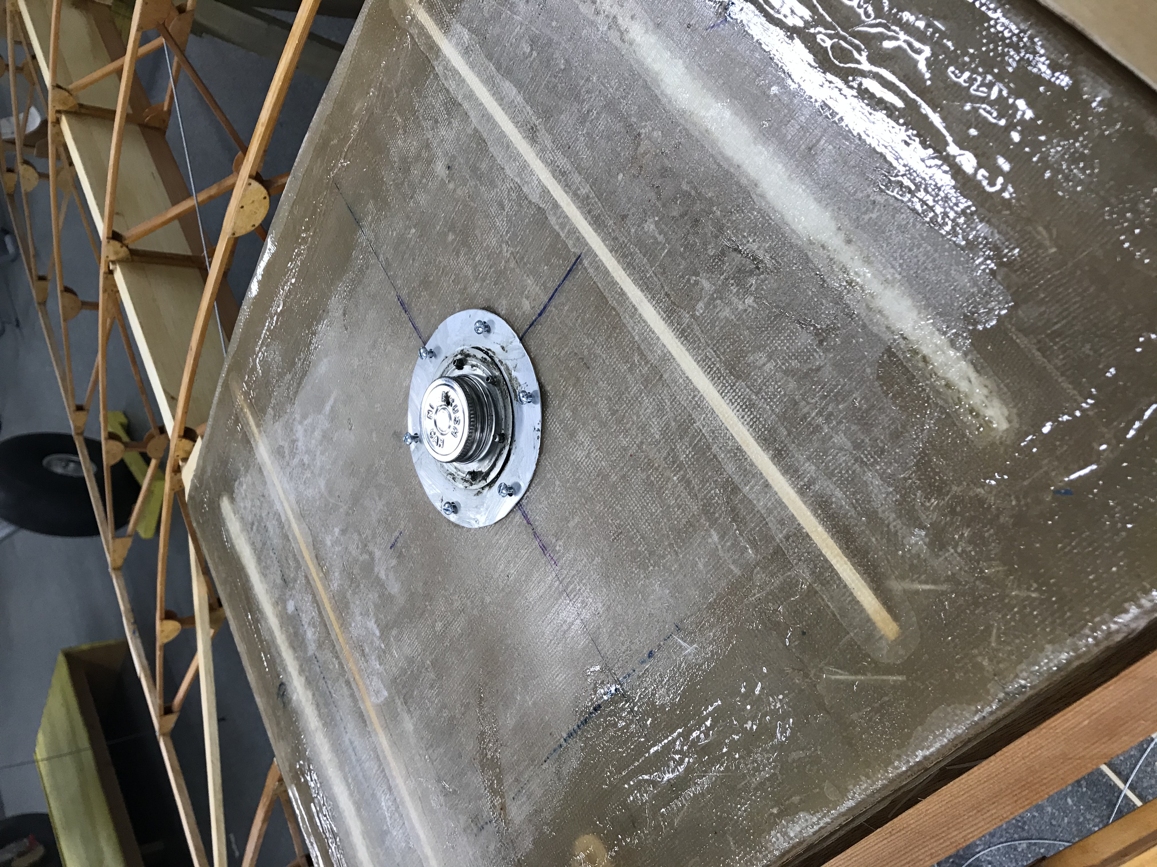

fuel tank complete and ready for filler neck. tank has stesrman type fuel gage.
Which epoxy resin did you use on the fuel tank? Do you plan to run auto gas?
Air Camper NX41CC, A75 power, avgas
doug bryant
Posts: 46
Joined: Mon Feb 08, 2021 7:42 pm
Post by doug bryant »
polyester resin; non-alcohol fuels. i have built a few tanks like this with great results.
OK. It's the alcohol blended autofuels that can cause problems. Sounds like you're all over it!

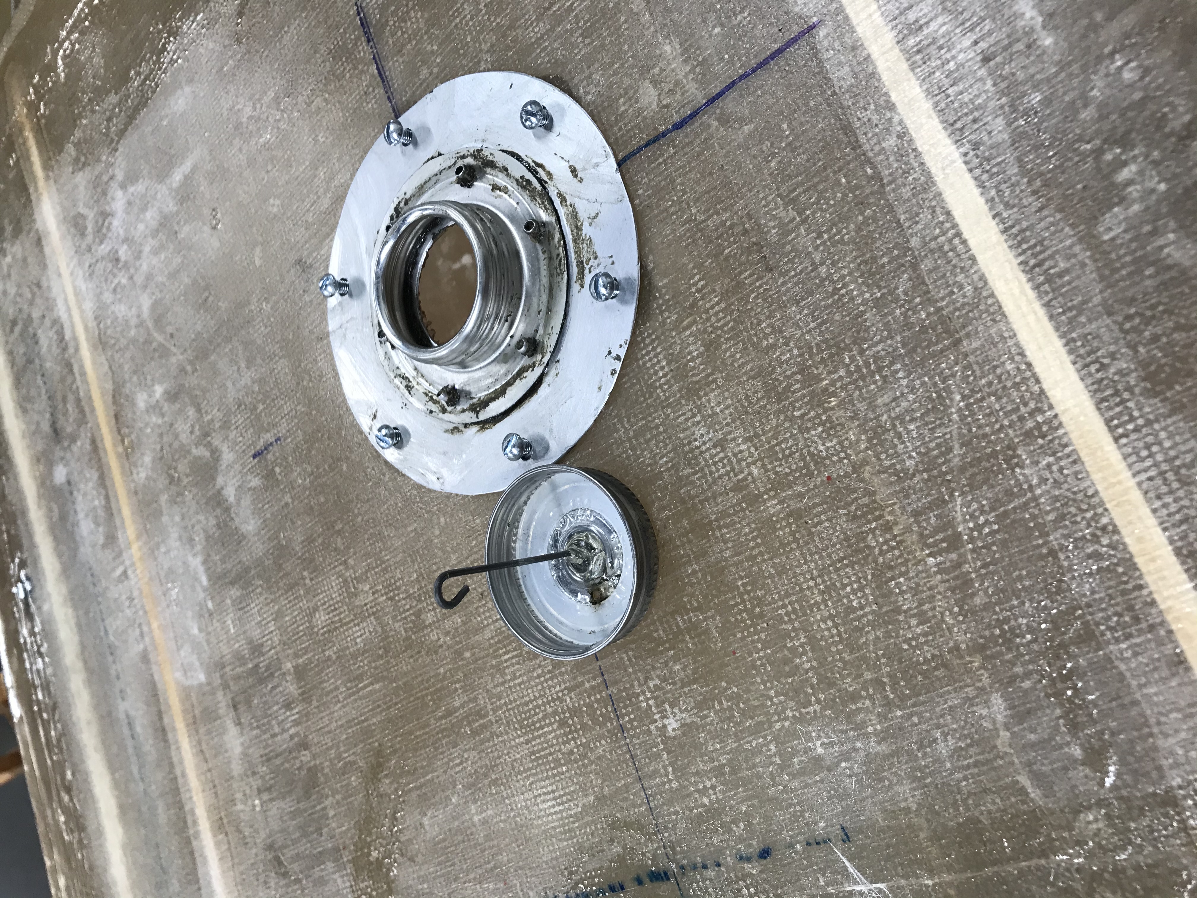

used top from a dried can of pvc glue for filler neck and cap. plywood template is the master tool for all the top division work

the loop is where the small chain will be attached.

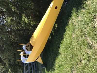

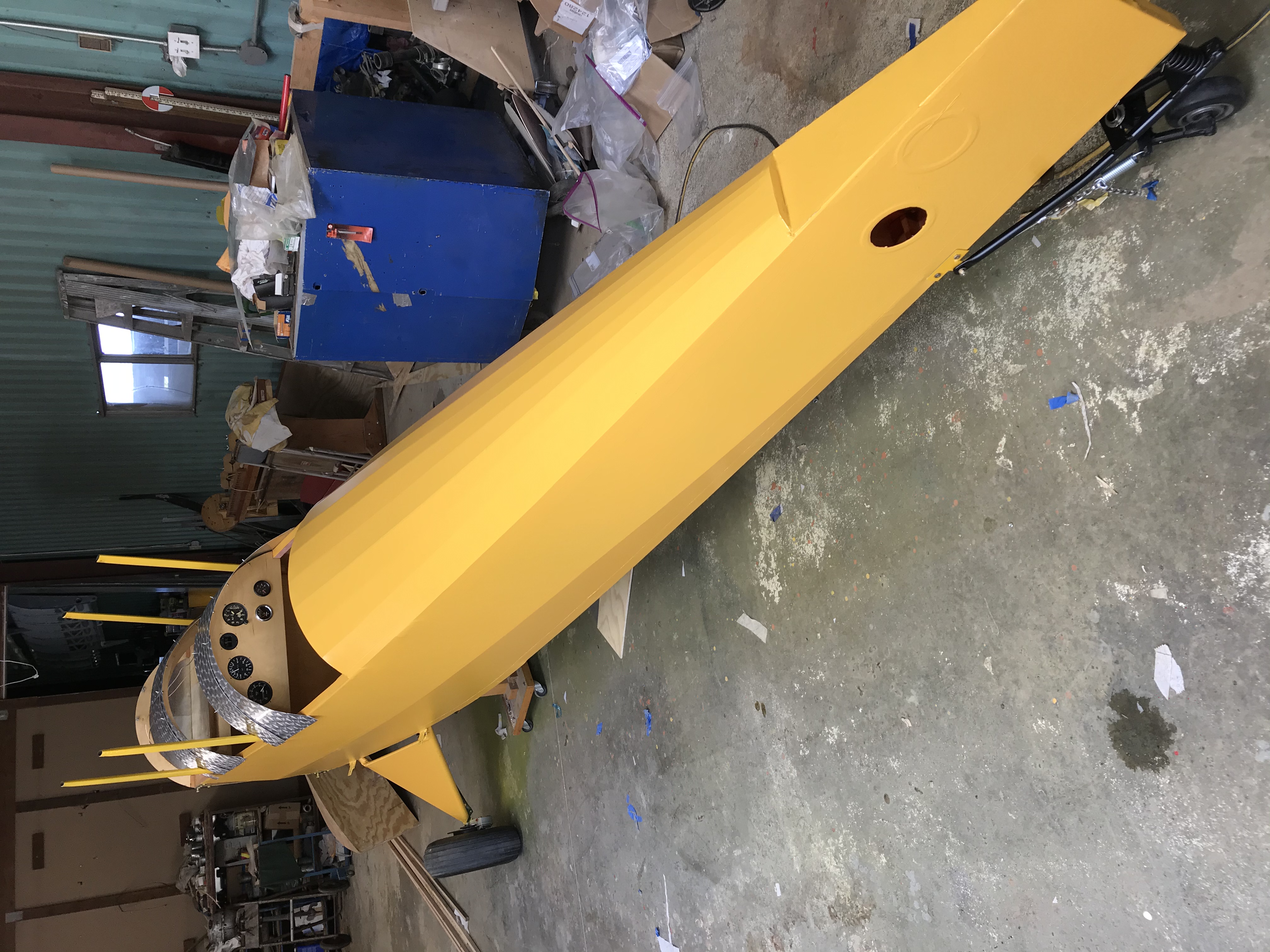

started covering today
Congratulations!! It's a great feeling to be at the covering stage. Suddenly the light at the end of the tunnel seems much brighter.

continuing to cover; tail feathers are almost done.

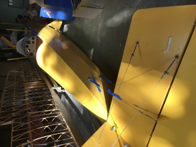

Careful... I see you've got that plane inverted. Note that the Air Camper is Normal category and only good for negative 1.52 G ;o)
-Oscar Z.
doug bryant
Posts: 46
sure is easier to cover the bottom upside down though

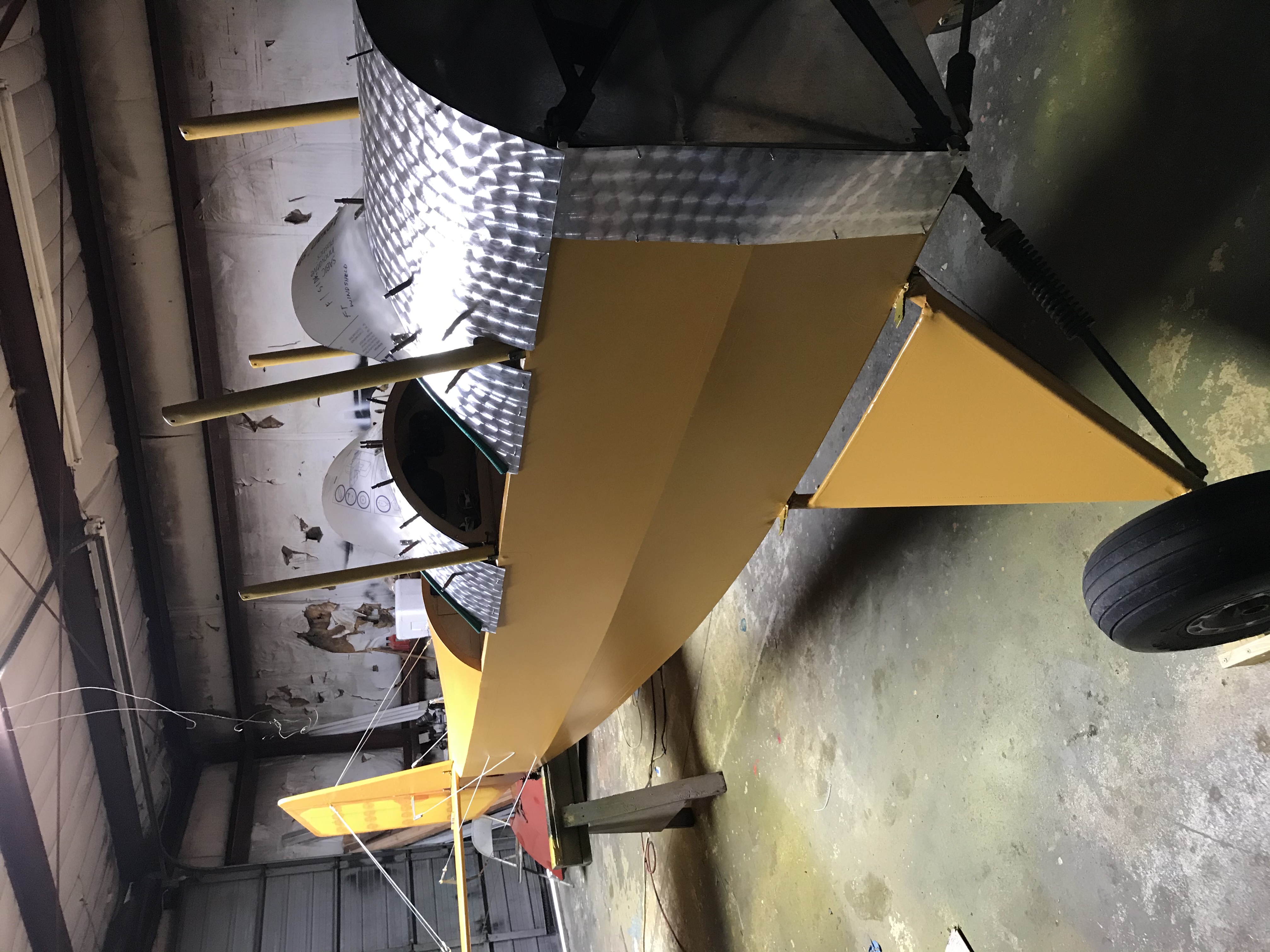

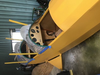

continuing covering, fuse, tail feathers,

making small amounts of progress every day.

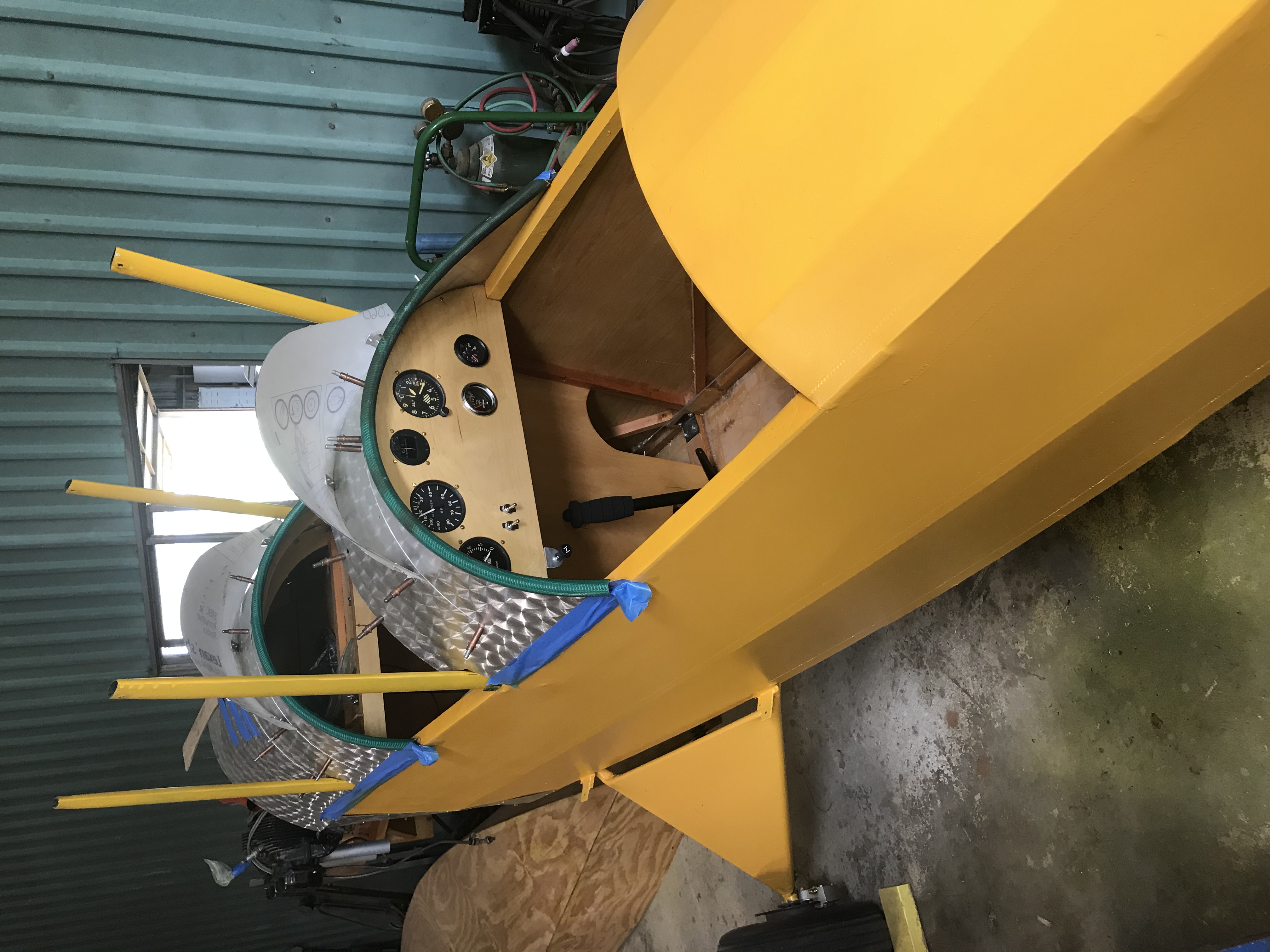

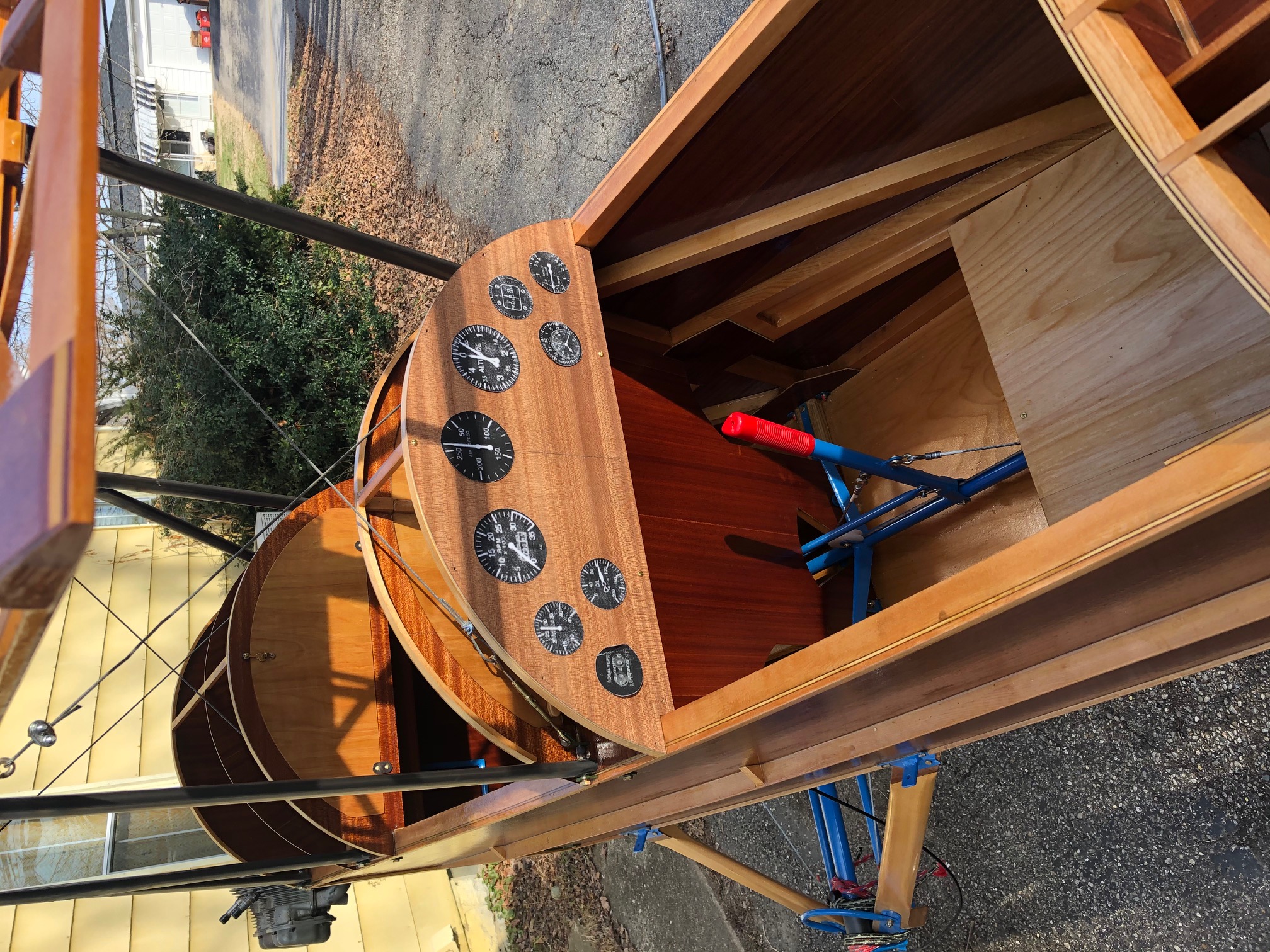

engine instl started.
doug bryant
Posts: 46

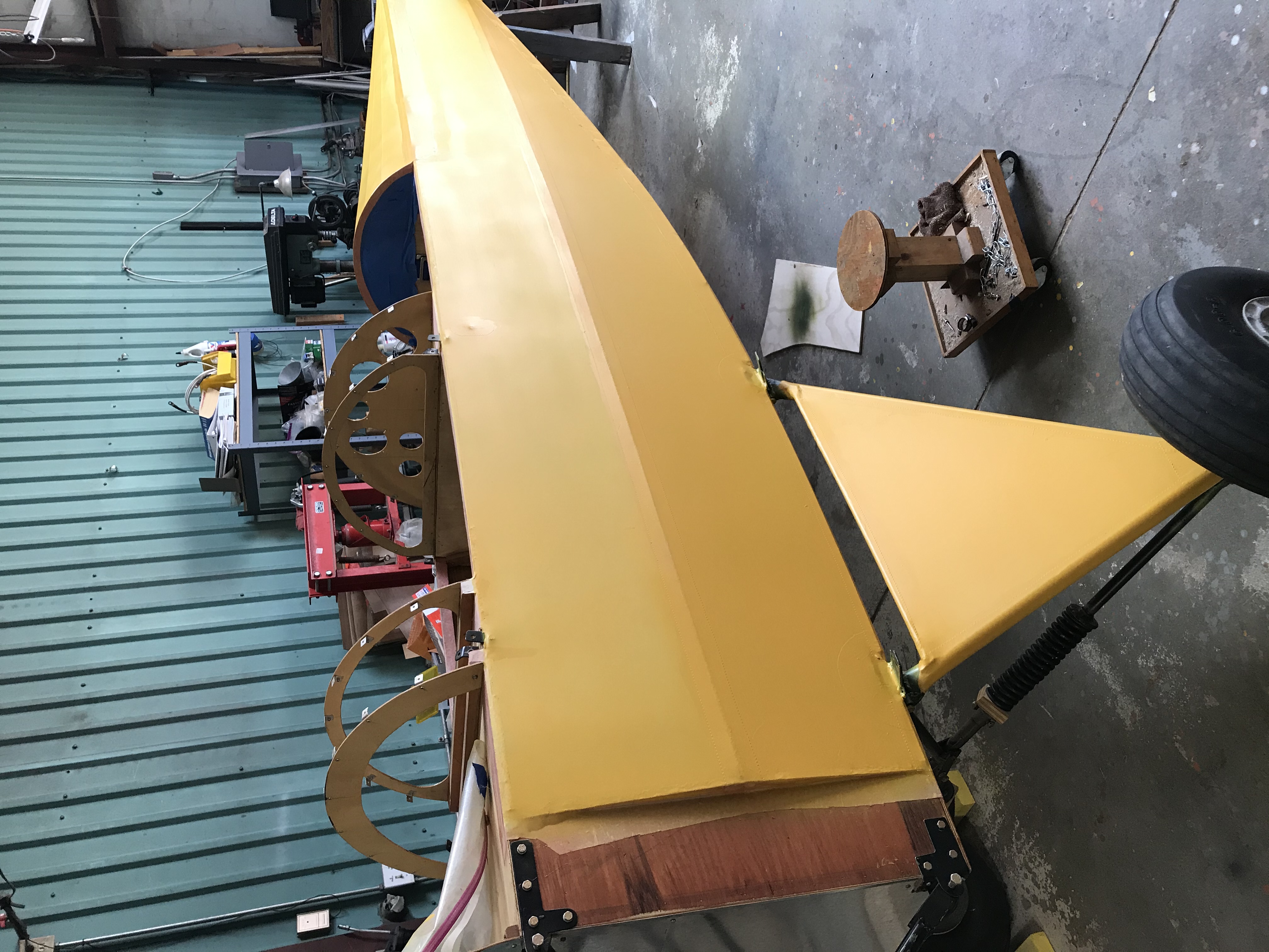

completed more on engine, covered ailerons, wing ready for cover.
