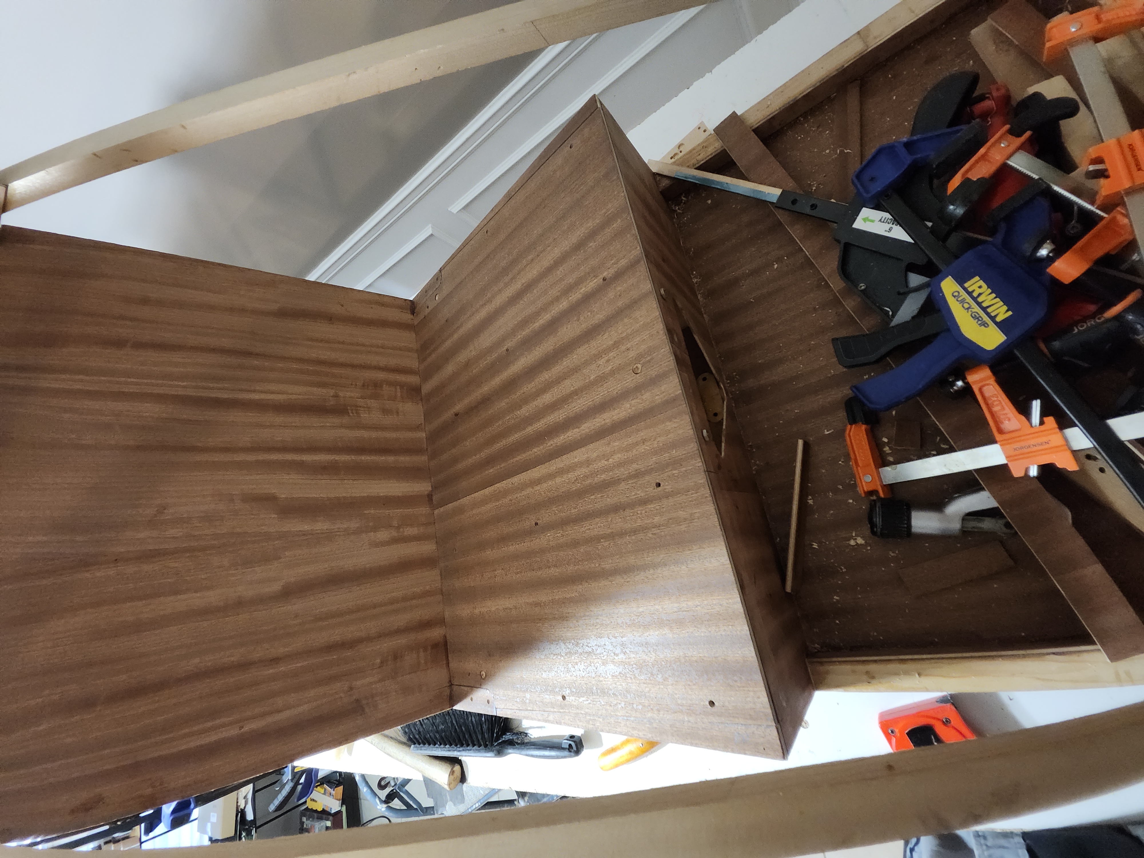

Trying to get re-motivated on the repair. So, rough cut out and test fit of the rear seat back.
Re: N34KP's rebuild
Roger, three-four kilo papa. Proceed on course.

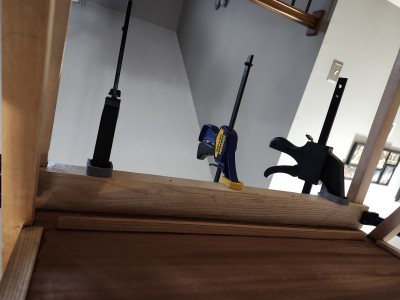

Re: N34KP's rebuild
Two vertical pieces gluing into the the rear seat structure.

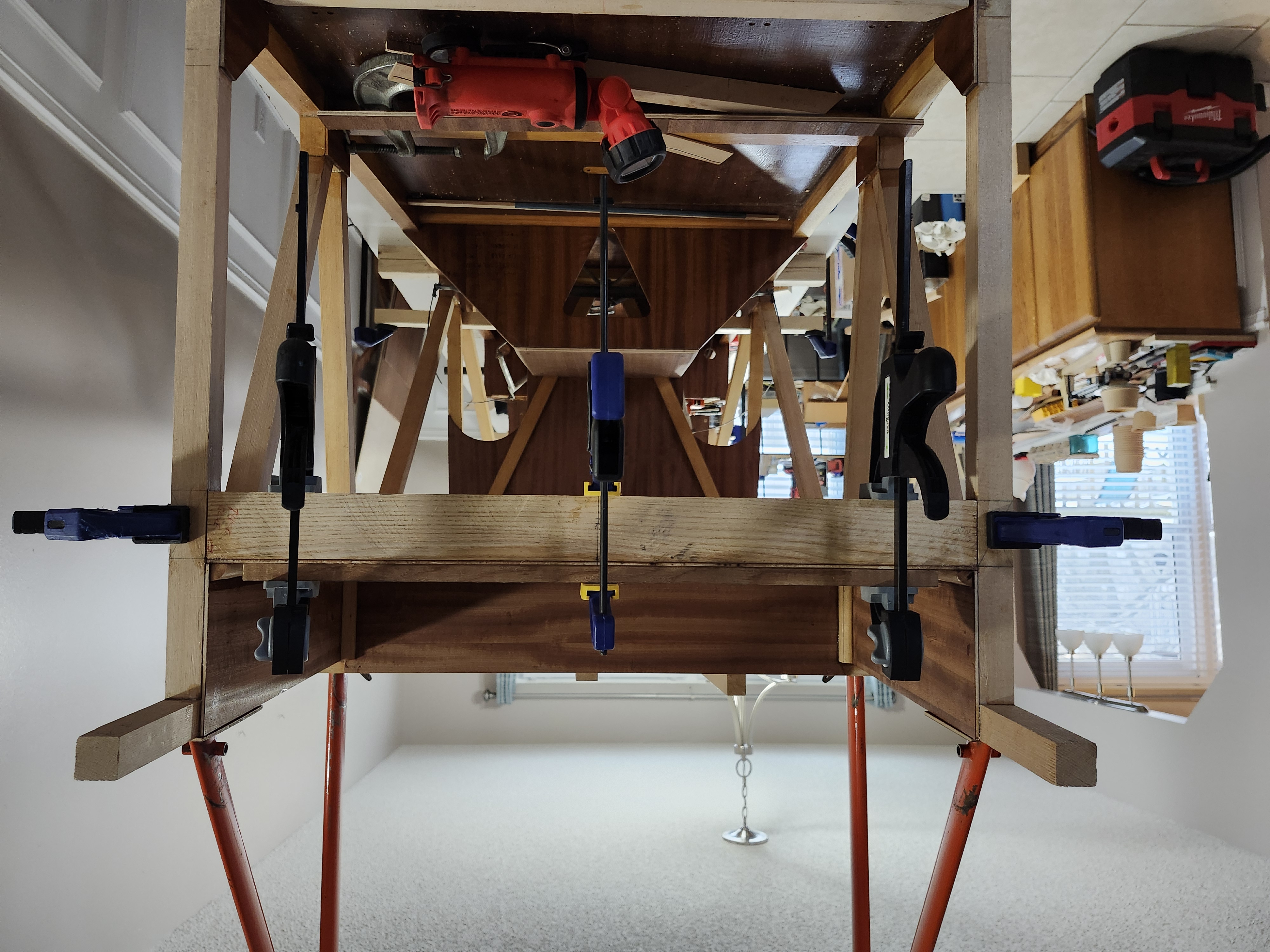

Re: N34KP's rebuild
Fitted and glued in the engine bearer cross piece today.
